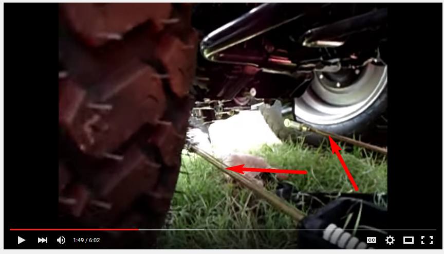

Hey everyone-
I am almost committed to buying a Max 24. The only thing stopping me is uncertainty regarding the removal of the mower deck. I have only found 1 video showing removal. My question is, what is the deal with the rods that run from the back of the deck rearward? Do these get removed when the deck is removed?
Can anyone detail how they remove the 60" deck?
I am a guy who takes the deck off frequently, and I don't want some poorly engineered design. I used to own a Craftsman...

That's the video I saw. I am talking about the two rods that have springs on them coming off of the back of the deck. If I remember correctly, they run back to the 3 point arms. Can you get a picture of the deck when it is removed from the tractor? I haven't been able to find a good picture.

it is one heavy mother almost 500 lbs. still not sure what you mean - but believe me - write the instructions down on the video and go out and it is easy and drive right over in reverse. i think the 2 pins you are referring to are easy. i only took the stupid ring clips off and put regular pins on them - easier to mess with than the rings though once they get used should be easier and also was told the rings are more secure. but for my need i like the pins! that was my only change if i recall. get the tractor - **** nice machine. I am most pleased! and yes i did my homework i am too poor to waste that kind of money and I wanted the best.

Assuming it's the rods shown below(?) They should just drop off where they are connected and then stored some where.
BlackOps.... when driving onto or off the mower deck, has the deck been pushed ahead of the tires rather than staying put? I've got an old Ariens GT16 tractor that the deck had to be driven over to mount it and I had to use a set of ramps to get up and over the deck as it wouldn't stay in place when the tires pushed into it without having a small ramp. The Ariens is a smaller tractor and deck was lighter, but same principal.

Mine was delivered on and I wanted it removed for the duration of the winter for ground clearance. Lower the 3 pt hitch to lower the mower, pull the 2 rear pins, disconnect the front, then the pto. If the linkages you are talking about are what I'm thinking then they are the ones at the rear and yes you would raise the 3 pt. hitch and it comes right up. You can adjust the travel of the rear linkages there is a dial that sets the deck float height. I hope this helps.
   / Max 24 mower deck removal? #8
Btw I drove it right off in my backyard in 4 wheel drive and it went right over it. They do say to have the loader removed first but mine did just fine.

I just raised the loader right up to get the weight as far back as I could and it drove right over it. BlackOps you're right I Love that little machine :)
