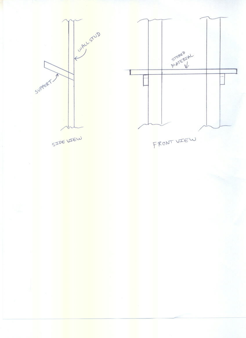

I store a lot of left overs under my front porch. When I build a storage unit, I'll build racks like this. Gerard

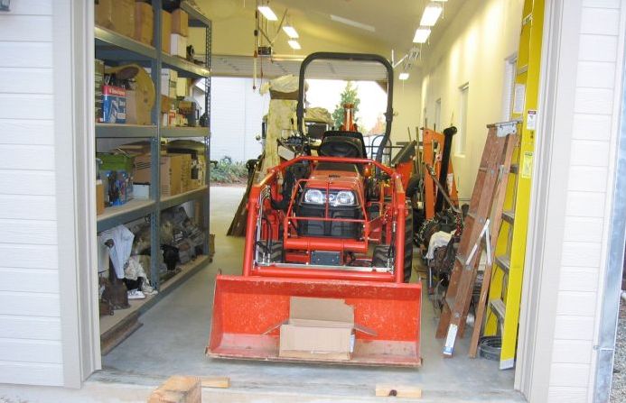

/ Materials Storage Racks #3

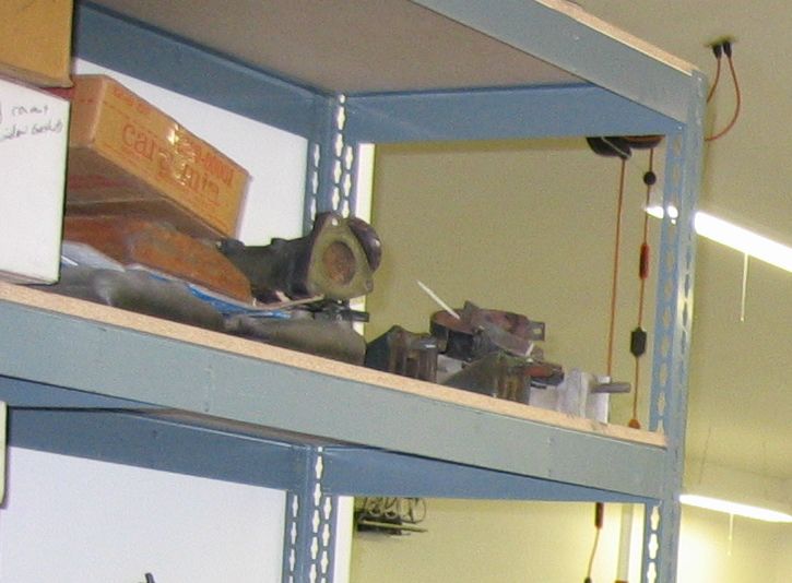

Gerard, I've stored aluminum tubing on wood racks like you show. It didn't work out very good. Over time the weight of material forced the wood arms down regardless of the quantity of bolts I placed at the tie points. The wood just slowly gives way over time (several years in this case). The only way I was able to use wood, was to place a brace below the support arm, i.e., make a rigid triangle to support the weight. Of course this interfered with the storage arm below it and reduced the lower unit's capacity.
I decided if I ever did that again I'd fabricate the support arm and wall attachment out of steel weld 'em together and cover the arms with some non-metallic covering.
I haven't make any more though. I took the easy way out and bought some commercial key rack with particle board shelves. Besides the aluminum tubing and wood planks I can also store car transmissions on these shelves. The attached photo shows the racks, the transmissions are on the bottom shelf hidden by the tractor.
/ Materials Storage Racks #4
Here is a better view of the construction of the rack.
/ Materials Storage Racks #5
Point taken.
But, if you put 2 bolts diagonal or 3 triangular and maybe some steel plate plus use double braces (one on either side of stud) I would think it would hold plenty of weight. Also, the angled support underneath would be beneficial too (if needed). Gerard

/ Materials Storage Racks #9
</font><font color="blue" class="small">( Point taken.
But, if you put 2 bolts diagonal or 3 triangular and maybe some steel plate plus use double braces (one on either side of stud) I would think it would hold plenty of weight. Also, the angled support underneath would be beneficial too (if needed). Gerard )</font>
We did that on the shop wall. Made it sturdy enough to not come off the wall.
Then the 2x wall bowed out from too much weight on the studding.....
Be careful how you do this.
A free standing rack is better.
--->Paul
/ Materials Storage Racks #10
Good point. Over time, bow city. TBN'ers think from all different angles. Always good input to the pros/cons. Thanks. G
