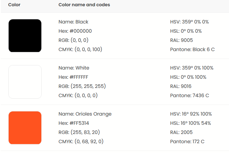

Vintage U-haul and Kubota orange-red and black is the same stuff.
I talked with a retired Kubota Gray Market importer. He stated that is all they ever re-painted the Kubota machines with.
Buying Kubota orange paint labeled as such is way to pricey.
The color codes below for RAL is for paint.
The newer Kubota's use a little more red today in the color.

The industry standard for color matching paint is the RAL number. RAL is used globally.
When you walk into the stores to find the base paint can/jug, they squirt the appropriate color dyes in, then on the shaker all of this gets mixed. To get to the right balance, the RAL number is used. It tells the counter person how much of what dye to add.
There is the trust worthy RAL classic colors since paint was classified into a standard.
RAL Classic colors | RALcolorchart.com
And a modern chart where shading and additives give gloss and sheen.
