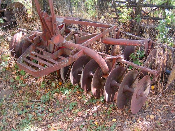

If my picture upload worked, here's a disc I'm considering buying. It's advertised as a Fergusson No. 22. It looks like a No. 22, but it has that deal on the front that looks like a weight rack. I've looked at a manual, read a bunch, looked at pictures and haven't seen another one with that feature.
Also, by looking, can anyone tell me if this would have the wooden "bearings."
I can buy this for about the same price as a used King Kutter --- I like the idea of old iron, but worry about a lot of down time trying to find parts if I need them.
Thanks for any help

Yes, that is a weight box, and actually the first one I've seen, other than the parts book picture. And yes, they have wooden bearings. And I also thank you for pointing out the Woodex site. Mine doesn't need them quite yet, but would be nice to have a set onhand.
I don't think you will need any weight, unless you're disking really tough ground. I have one just like it, and it cuts very well in the sandy loam I have. Goes clear into the spools on the second pass. If you do happen to get it, I think you will like the easily adjusted gangs. Mine is a 6 footer, and I pull it with my 3 cyl. Ford 2000. Set at full cut, you definitely know it's back there. It's nice to set it at just a couple notches from straight, and finish. If you notice, the gangs sort of semi float. Not like a rigid frame disk, where if you hit a high spot, it will lift the whole front or back off the ground.
Not quite the finish I get with the old drag disk, but darn close. And for me, just handy to pick up and go.

I like the levers also for gang adjustment. Lots of the older equipment had levers with notched quadrants for adjusting whatever. A designer or manufacturer today would be laughed at for having levers sticking up in the air. Way too practical and not streamlined enough.

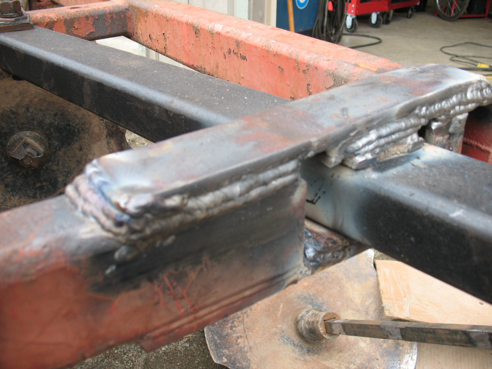

That looks like a fine disk. I have one that you have to slide by hand and a few weeks ago I was doing some maintenance on it and decided it would be better to take out some of the slop in the floating gangs on the rear so I put some spacer metal in and welded it up. Come time to move the gangs to put more set and I couldn't make it slide by hand, foot or pry bar. I had to hook a chain on it, run it under my tractor and on to the FEL and use the power of hydraulics to move the gangs. Took maybe 5 minutes on the front gang that was dangling loose. Photo shows how I filled in about 1/2" gap to stiffen up the gangs but didn't account for how hard it would be to move.
