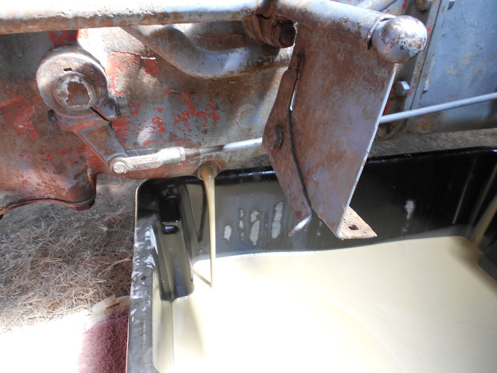

I purchased a 1968 Massey Ferguson MF135 with Multipower recently,
The Multipower didn't work, the Hydraulics were very slow and jerky and wouldn't lift anything slightly heavy, They also fell
down when the PTo was off.
Sound familiar?

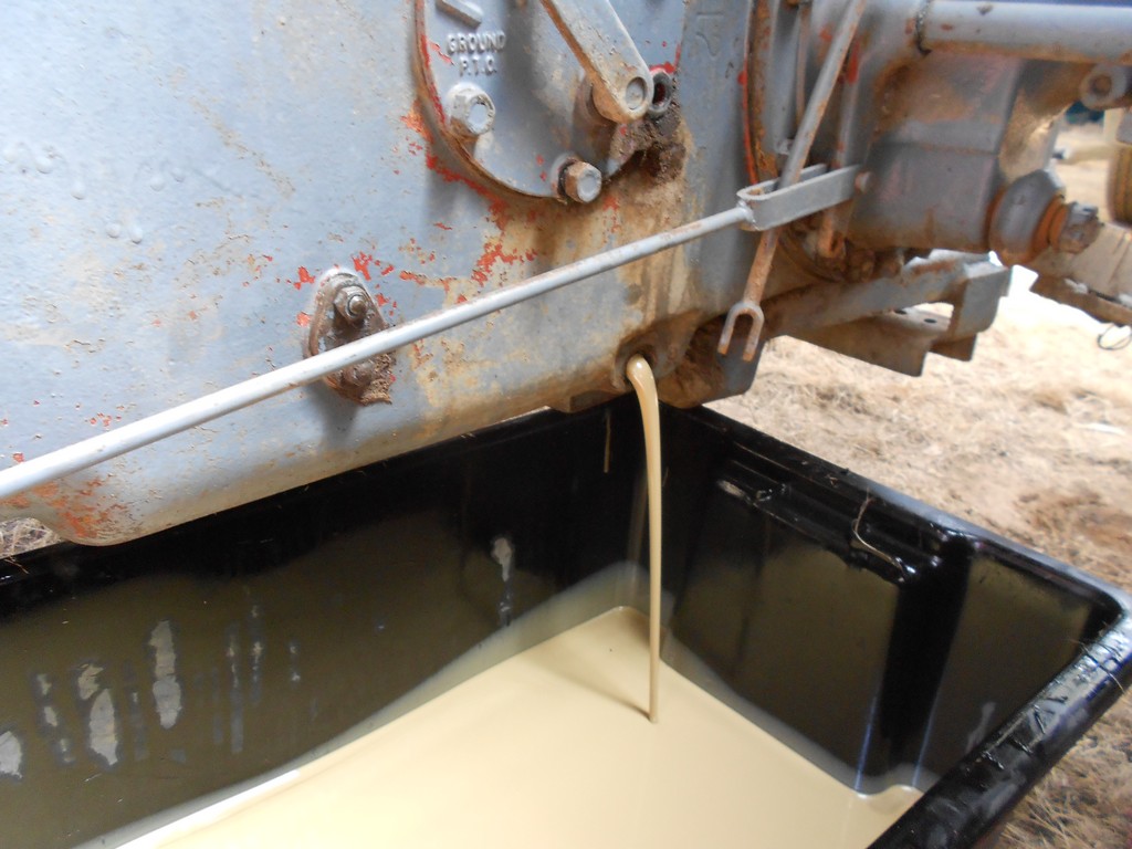

Anyway, after checking the Transmission Oil I discovered it looked like really Milky Coffee.
Time for new Hydraulic Oil.

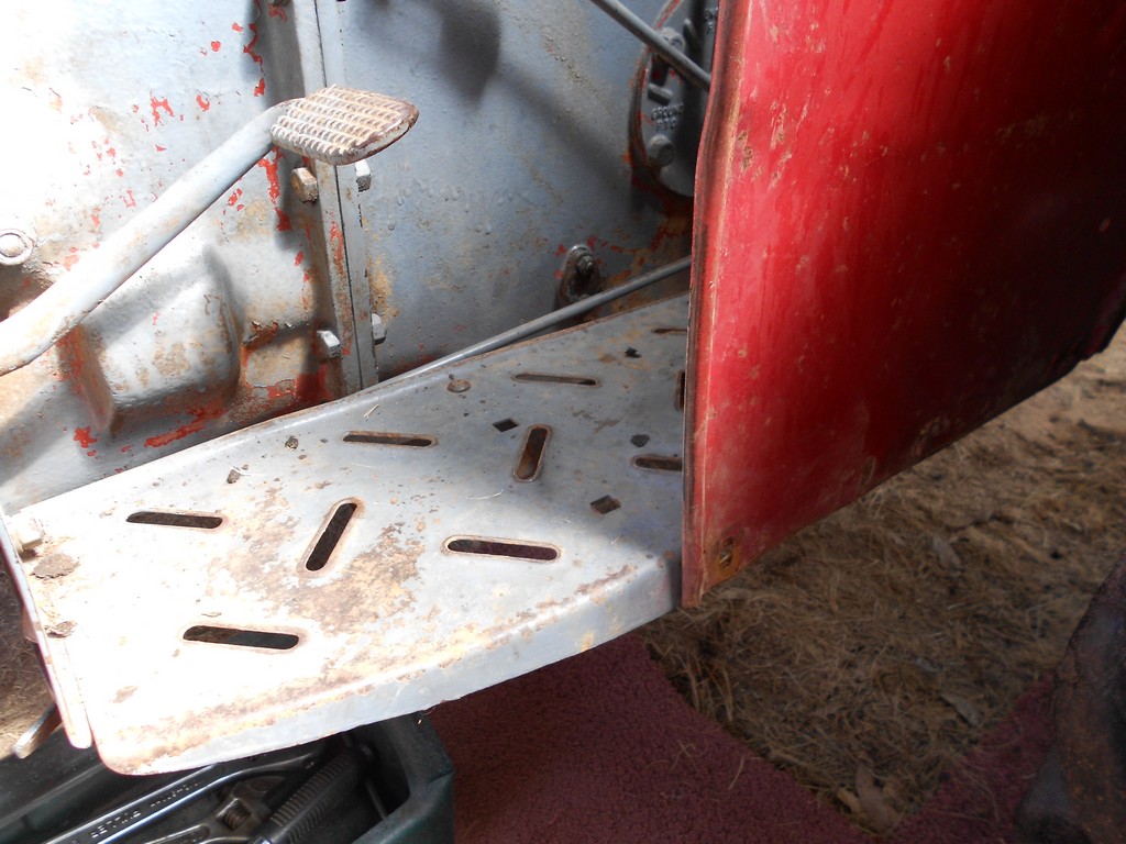

Start with the Tractor on level ground,(even better if you can have the left side slightly lower to aid oil draining)
Lower the Hydraulics.
Select neutral in the gearbox and High/low range selector, Make sure the brakes are fully applied and locked.
Chock the wheels front and back. ( you will be under the tractor so think Safety!)
Make sure the PTO selector is in Neutral. (important)

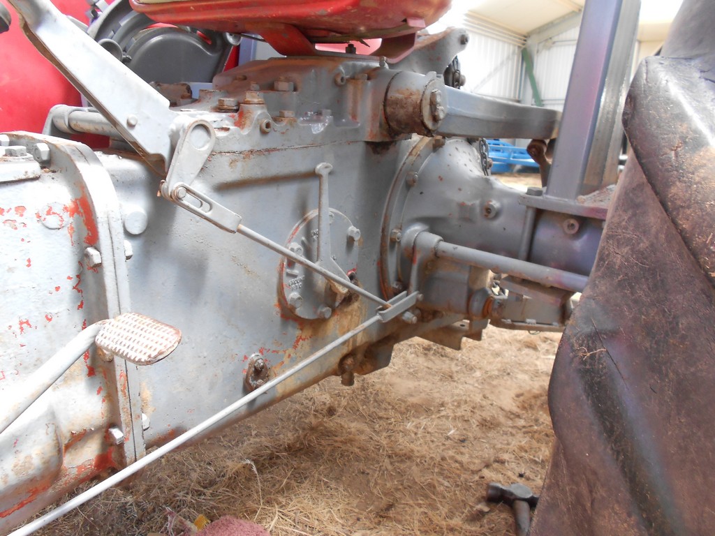

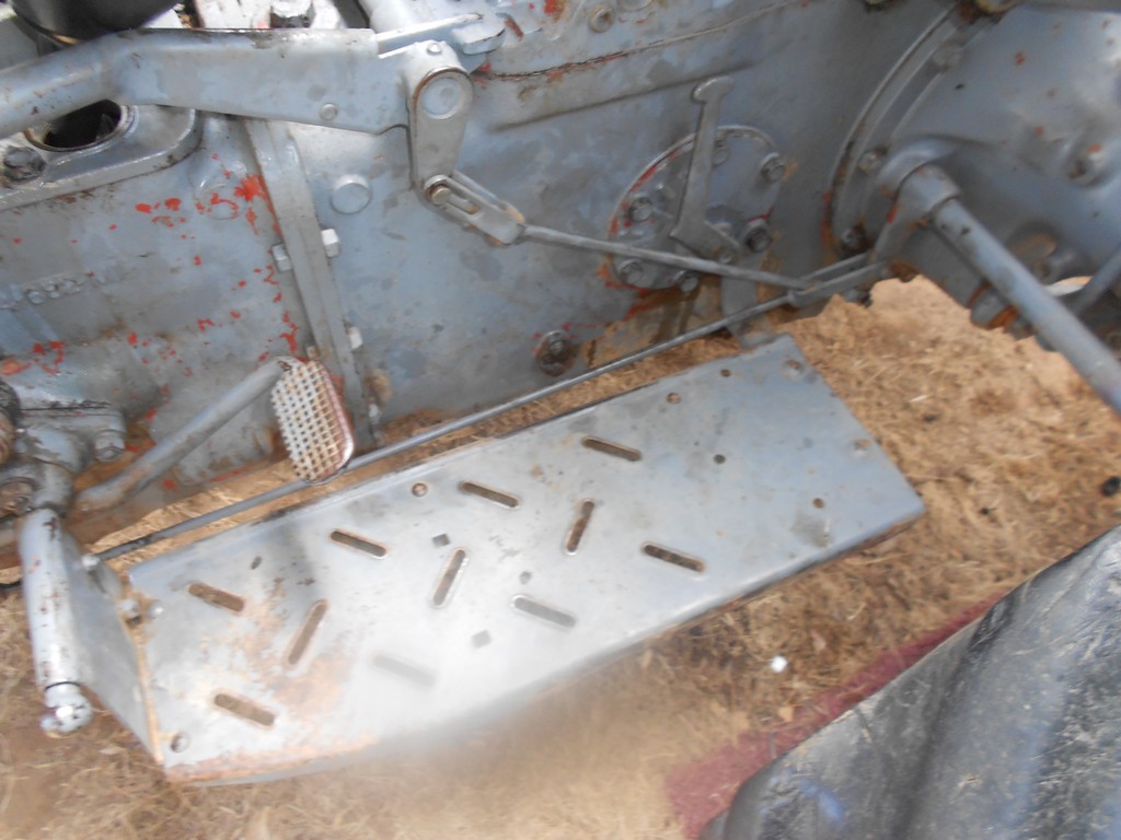

Remove the left hand mudguard/fender, the left foot board ( rear mount is bolted through the PTO Cover Plate) and the hand
brake rod if fitted
Remove the two drain plugs ( one in the rear just below the PTO selector, and the second one is just in front of the front foot
board mount) and let drain until all the old oil has drained. You will need two containers with a capacity of 30 liters/Back plug
and 20 Liters/ Front Plug

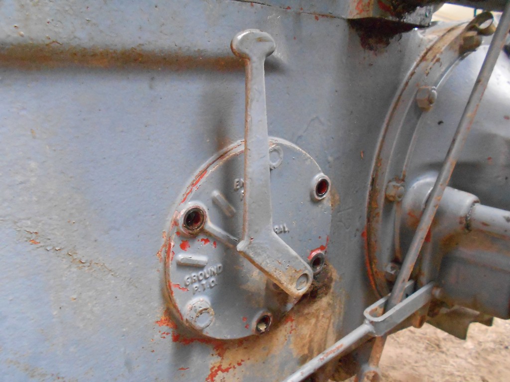

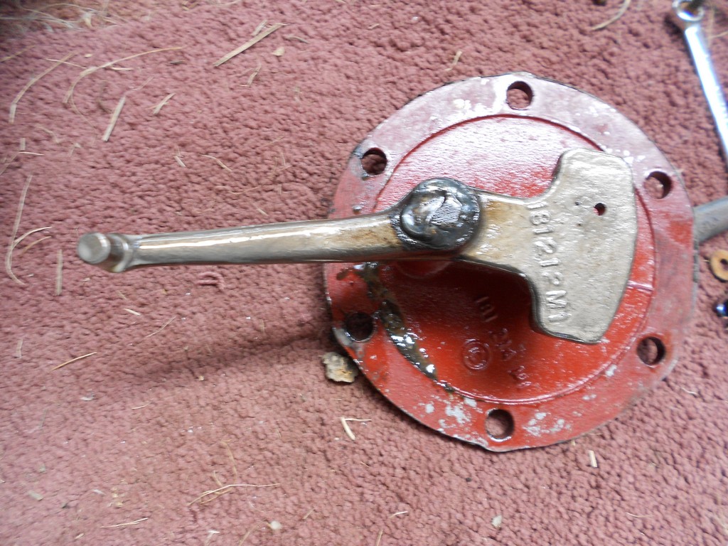

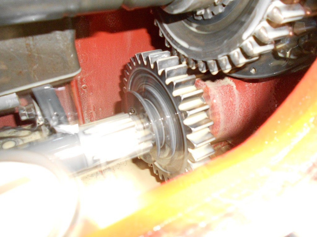

Remove the PTO Cover (and arm, they come off as one piece)
Take note of the selector arm position and the groove it mates with in the gearbox
You need to know where the selector arm goes when you reinstall the PTO Cover. If you don't the PTO selector won't work

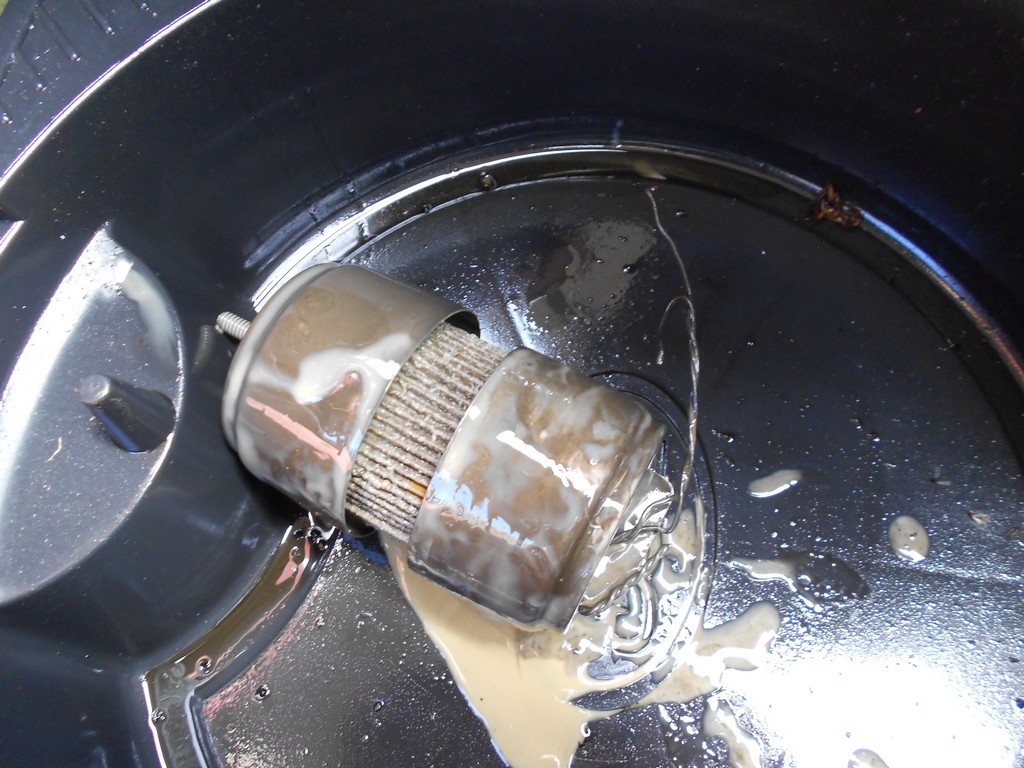

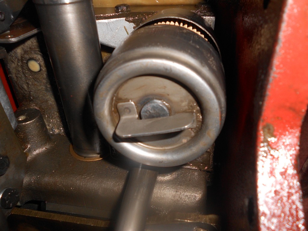

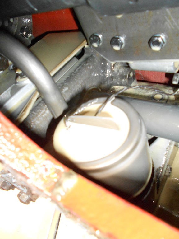

Locate the Hydraulic Pump Filter ( just in front and below the PTO cover opening ( you can't miss it)
Notice the filter is lock wired from the top of the filter to a small hole ( This is to stop the filter undoing itself and destroying
your gearbox)
Carefully cut the wire (make sure you don't drop and pieces)
Now unscrew and remove the Filter. ( hold the whole filter, It's made of three parts and will come apart if your not careful)
Thoroughly clean the filter with degreaser and an air gun if you have one. (the filters are reusable, but if yours is damaged
replace it)Set it aside to reinstall later

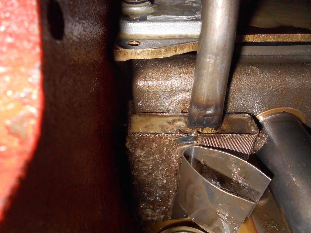

No comes the Multipower part!!!

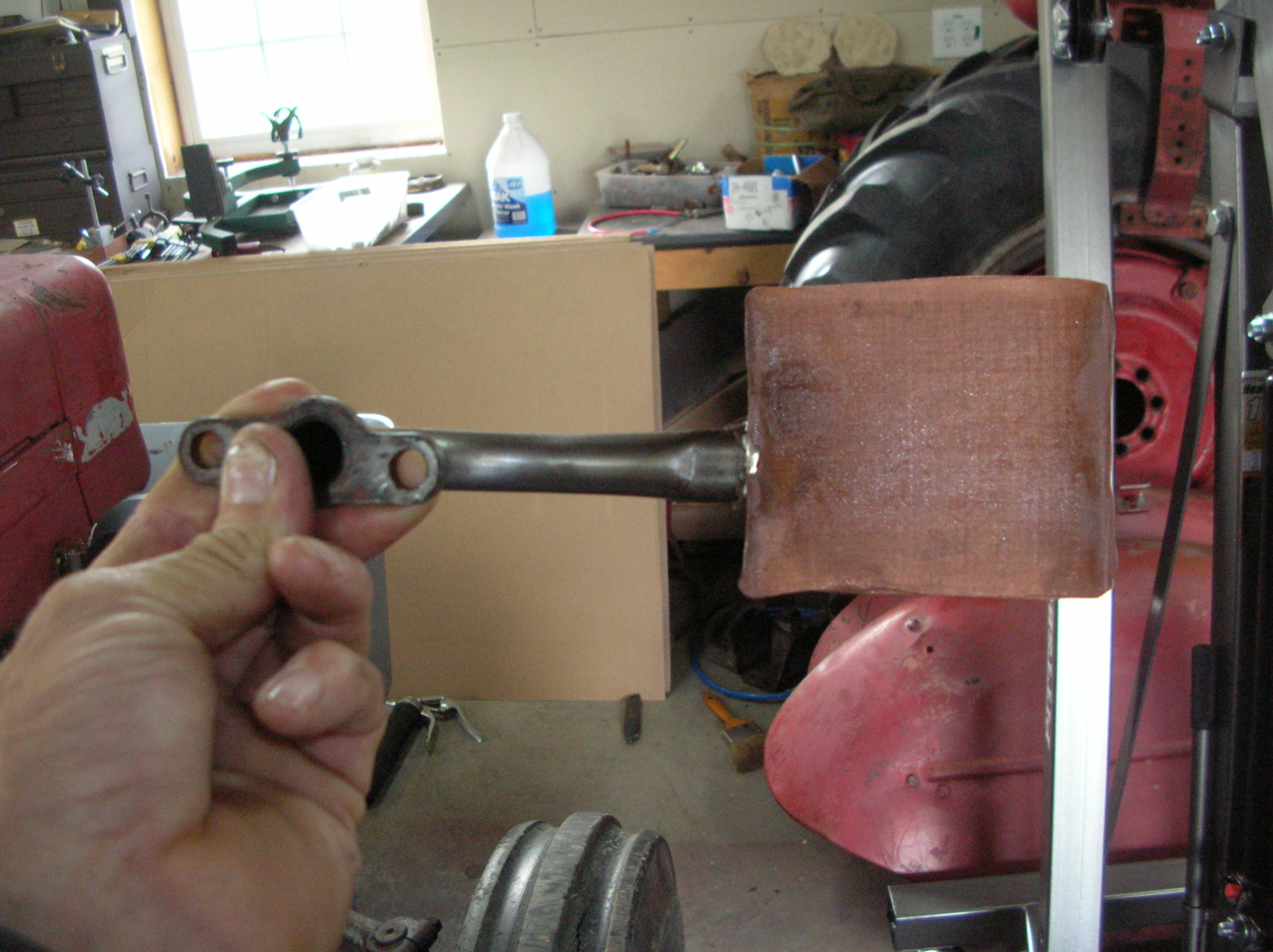

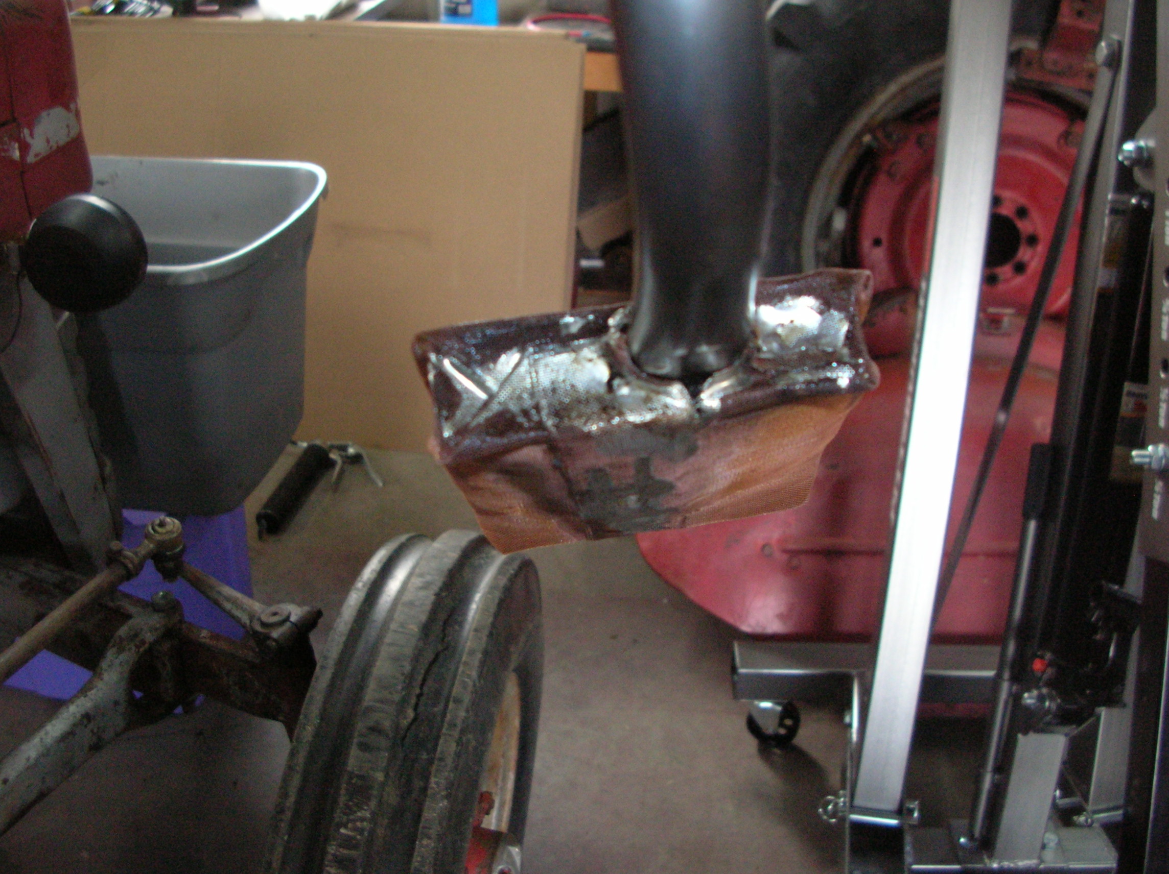

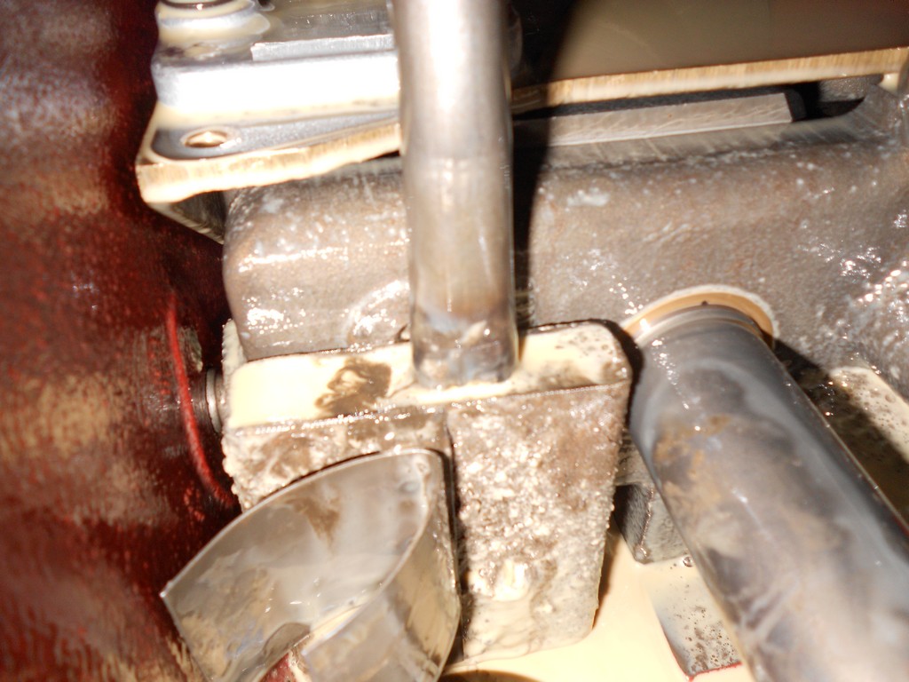

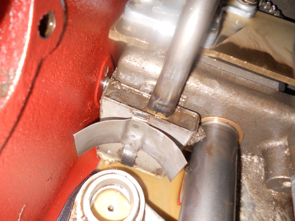

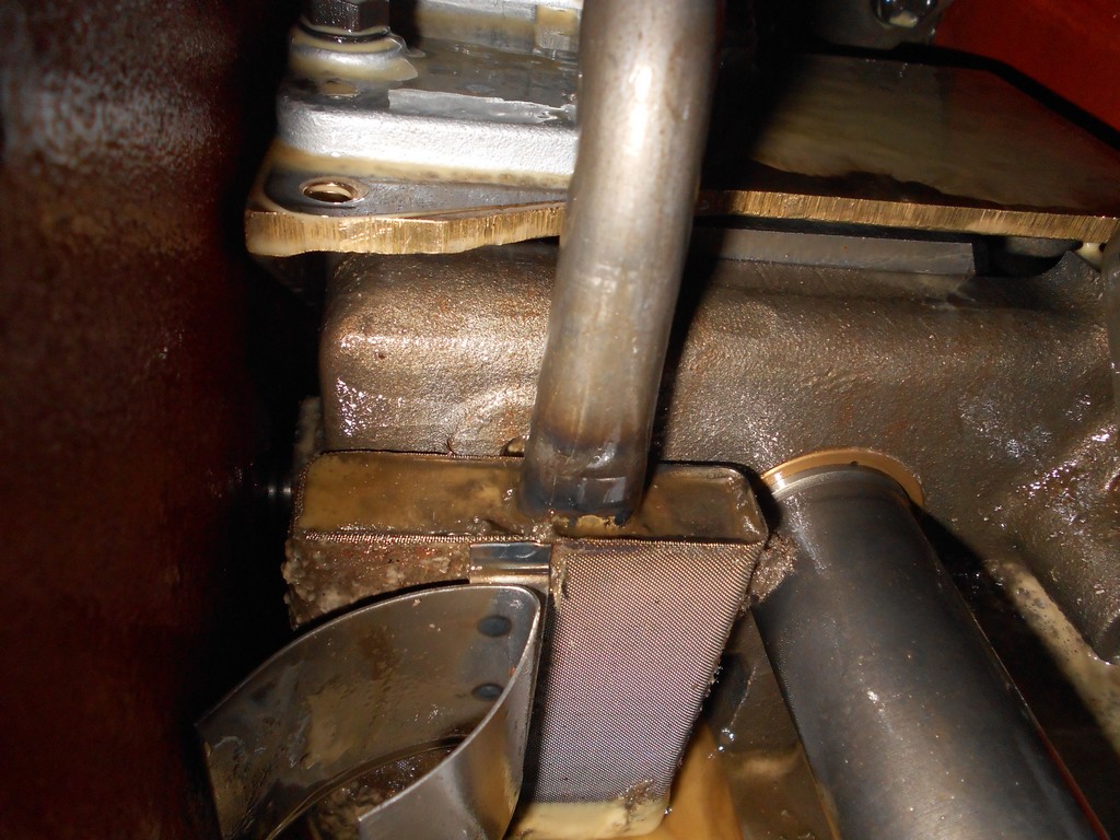

Just behind the main hydraulic pump filter is a small rectangular screen/Filter, this is the Multipower screen,
(It is behind a half circular baffle)
(Later MF135s have an external filter and this screen may not be present)
Gently bend one side of the Baffle to expose the Multipower screen

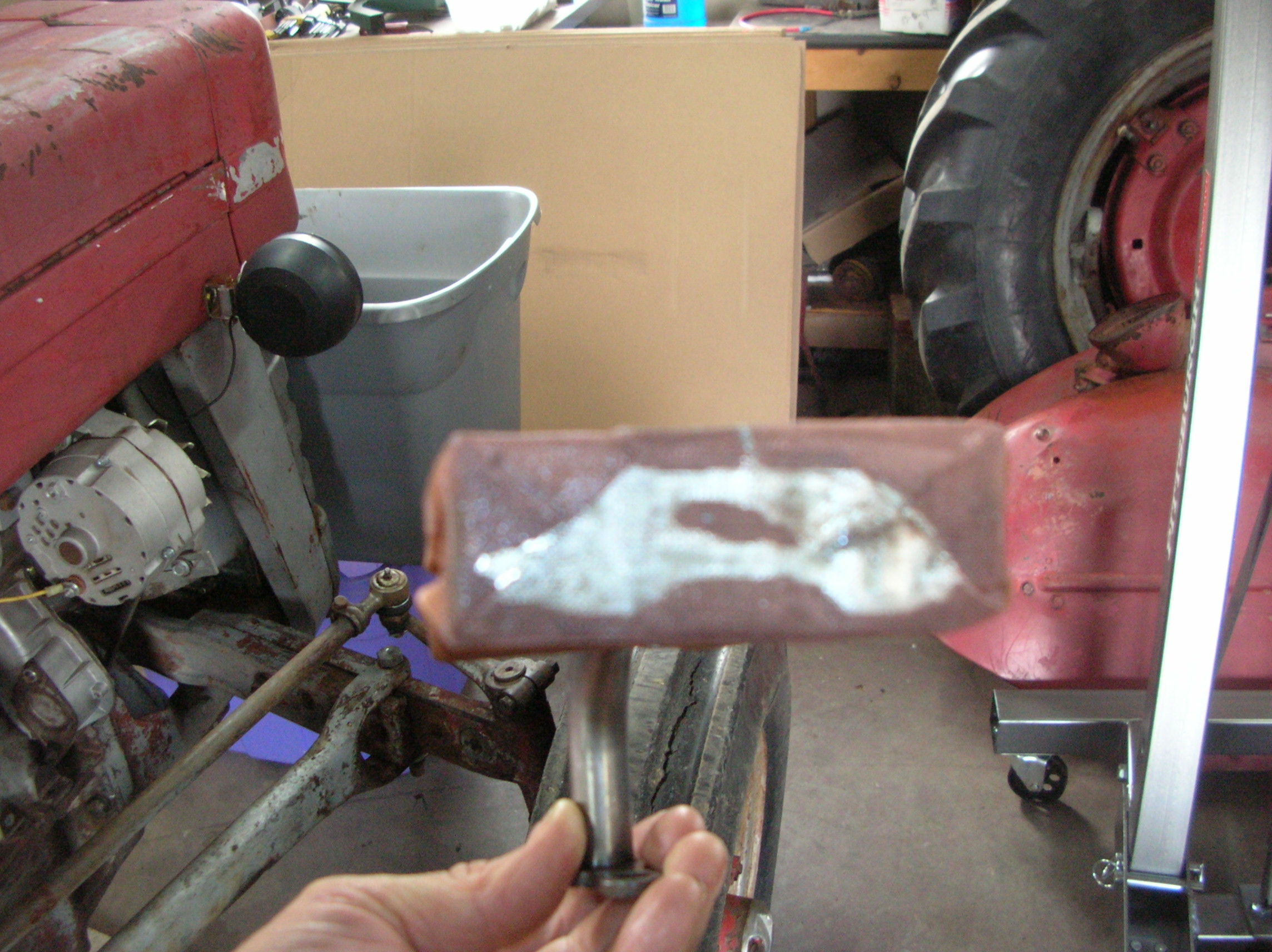

Mine was cover in crud as you can see
Now clean it with a spray degreaser and a clean rag.
I fitted a long nozzle from a Bug Spray can to make it easier to get a good pressure spray
Now bend the Baffle back into position ans do the other side, Carefully bend the other side of the baffle to expose the other
side of the Multipower screen
Clean that side as well, then reform the baffle back to it's original shape

Now reinstall the Main Filter (It only needs to be finger tight)
Reinstall a new locking wire ( this is important, Don't forget it!!!)

Reinstall the PTO cover making sure the selector arm engages the selector track as noted earlier ( if you don't you won't have PTO selection)

Reinstall the Foot boards/ Hand Brake Rod and Fender

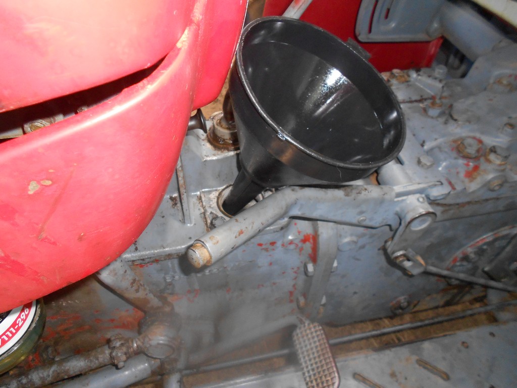

Fill the gearbox through the filler hole next to the gear selector
My MF135 took 31 liters to reach the Max level on the Dipstick
I suggest you add 20 Liters in one go, then add one liter at a time checking each time with the dipstick to avoid overfilling
I used Hydralink Farmlube 15/40 but any oil that is MF1129A spec or better will do.
There you go all done, It took me 4 hours to do the job, Remember it was my first time.
Results.......
My Multipower now works great!, the hydraulics are now much faster, no more jerking and lift almost anything,
It's amazing what a difference clean fresh oil makes.
Any hoo I hope the write up helps someone!
HooRoo from downunder, John

Nice write up. I had to rebuild my MP filter several years ago with new copper mesh screen. Much cheaper than a new one. Copper mesh from McMaster Carr.

But back to the subject of tractors - the gearbox oil rarely gets changed and as a result is usually contaminated with a huge amount of foreign matter, mostly moisture, turning it to the horrendous colour you saw when you drained it out. Mine was a close to a similar colour 4-5 years ago, but what spurred me into action was the 3pt slowing after working only 15-20 minutes. I was using a rear grader blade, levelling out clay on the bank of a smallish dam I had removed it from, in order to enlarge its capacity. As a result, the tractor was moving around like a bronco in a rodeo and the sediment was being stirred up from the bottom of the gearbox casing. I drained the oil, found and removed the filter, presumed it was a paper-element type and for all of about 20 bucks our local MF Dealer had one in stock! The sales guy I rang and quoted the part number to was as surprised as I was! :laughing: Only when I unpacked it I saw it was washable and re-usable, but I put the new one in, filled it with clean oil and it was back to normal. :D

Yep, that's exactly what happened to mine. The previous owner had it parked outside in the weather for 7 years and there were no gearbox selector boots at all. also no dip stick in the transmission, no wonder it was full of water.
