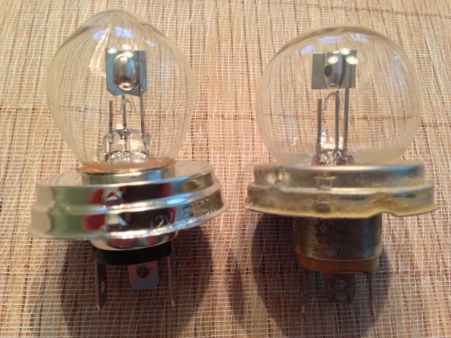

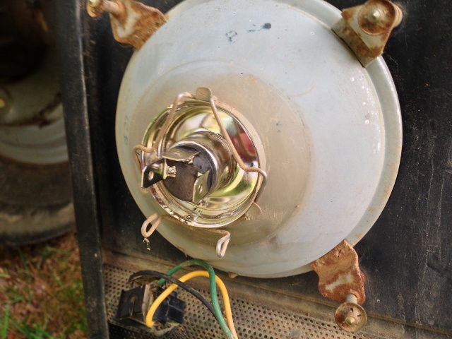

I was looking for a headlight bulb for my 1993 Massey Ferguson 240 and was able to find them locally at a auto parts store, they are the same bulbs used on snow mobiles.
So I figured I would post the part numbers for others that may be searching as well.
Bulb BT Type P45T 12v 45/45W
Part# 9589 CTC#26-2054
