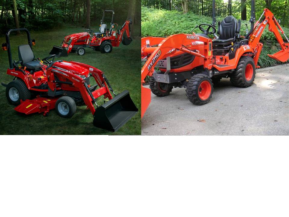

I am looking for reviews from owners of the GC2410 and the newer GC1710 series SCUT's and want to know how it has served you as far as service needs since you bought it.
If you don't have a backhoe unit that is fine, still looking for info on the base unit.
Tell what you like, don't like, failures, etc., and tell me why you didn't get a Kubota BX instead.
Many Thanks
