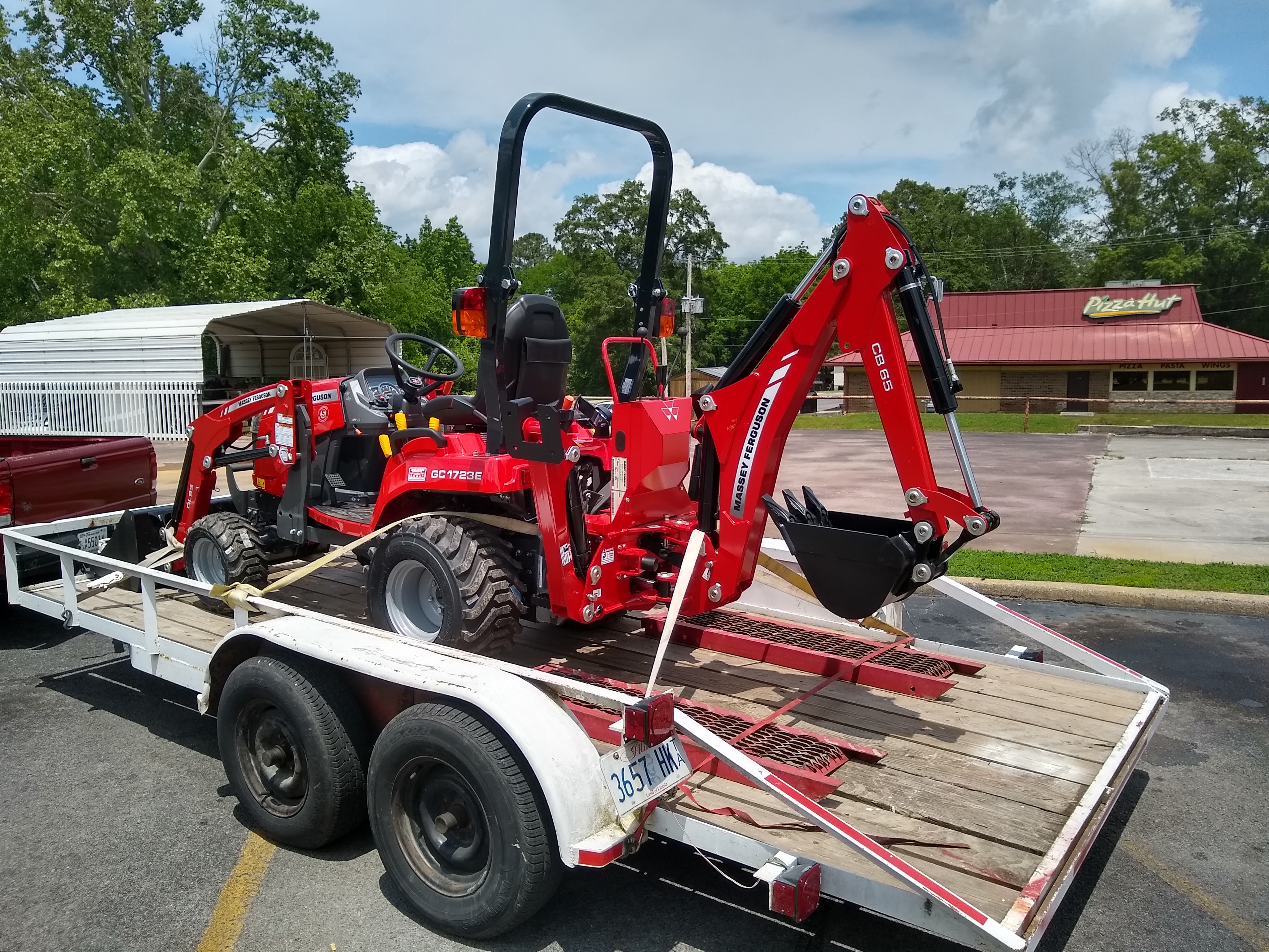

My problem is the dealer is 150 miles away. Long drive for a few quarts of Hydro-fluid .... There is a Mahindra dealer that's closer. I'll try them later this week.
My Massey Ferguson GC1723EB tractor looks a lot like :confused2: New Holland, Mahindra, and Yanmar sub-compact brands. The big difference is paint color and a few minor tweaks.

On the contrary. They’re all very different machines, manufactured by very different companies. Personally, I wouldn’t use Mahindra-spec fluid in my Massey, as the components are manufactured by different companies, and the specs for the fluids are different, if I remember correctly. Using the wrong-spec fluids WILL void the warranty, which could be an insanely expensive decision later on.
Massey GC-Series is designed and manufactured by Iseki in Japan. Massey designs the visuals.
Mahindra is an Indian company who sources from other companies, similar to New Holland and John Deere.
Yanmar designs and manufactures their own tractors in Japan, like Iseki and Kubota. Yanmar supplies engines for other brands, such as Deere and Mahindra.
I did a ton of research across brands before deciding on the Massey. It offered the best bang for the buck, along with AGCO’s very attractive financing offers. John Deere was over-priced for what you really got, and Kubota was lacking in a few areas, as well as being too pricy. Mahindra offered an attractive package for the money, but stories of warranty claim issues was the big factor that pushed me away. Yanmar was a good package, but not really any better than the Massey, and it was a little too much money for an aging design with less features than the Massey.
