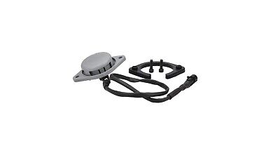

I have a Massey Ferguson GC 1710 and whenever I drive the tractor on bumpy ground (even just in the grass) the engine always wants to try to shut off when I bounce up on the seat. The seat safety that automatically shuts off the engine when you are in drive is just so sensitive because even when I barely bounce up it wants to shut off. The engine never shuts off but always seems like it wants to on every bump. I never have the issue when driving in a smooth surface like a street. It is really frustrating and can’t be good for the engine. While I don’t want to disable this feature, I feel like I have to, unless someone knows how I can adjust the sensitivity of the sensor, if that is even possible. Does anyone have any advice on how to solve this issue or can give me instructions on how to disable this safety feature? Thanks.

The elegant solution is wiring a delay circuit with a relay and timer that holds the circuit closed (running) until you've been off the seat for a second or two. This requires some minimal electronics knowledge and likely mounting a small waterproof electronics enclosure somewhere.
The simpler idea that might work is spacing the sensor so that it is activated with less pressure on the seat. This can be accomplished by either spacing the sensor up so it's closer to the seat surface or epoxying a spacing block on top of the sensor actuator itself which would have the same effect. Maybe guess and check on optimal thickness before epoxying. Too thick and you may have a princess and pea type problem.

Zip tie.
Try it, see if you like it. If not, clip it...

Change angle on switch engagement by bending bracket...

I put a piece of fule line on the switch of my 1835. I can move around quite a bit and shuts off only when completely off the seat.

Maybe it's something on the newer model, but there is a 2 or 3 second delay on mine before it shuts off. It's enough time that I can get out of the seat and off the tractor and be standing next to it before the engine quits.
As someone said, adjust the switch position. All of the safety switches are adjustable.

Bend the bracket some or a zippy tie, you must be a light person

I do like that having it zip tied, allows me to be able to move the tractor a little, without having to climb up into the seat. That has come in handy a few times.
