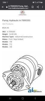

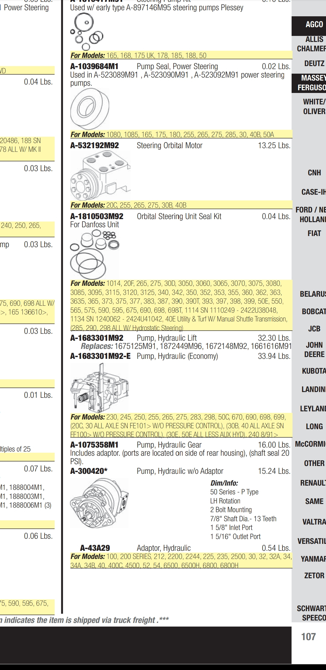

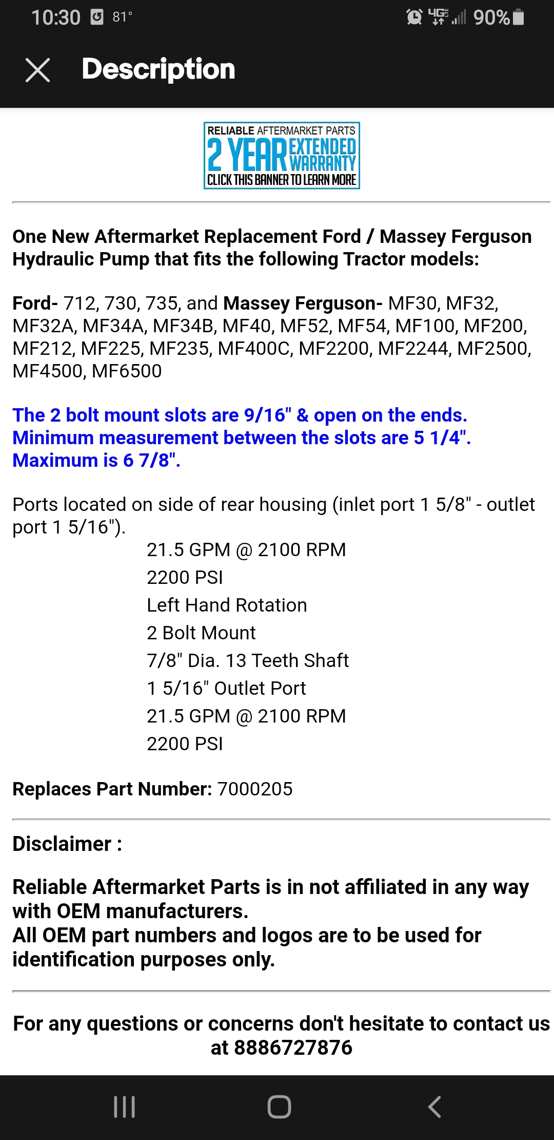

where is the best place to buy a hyd pump for mf50a in ontario Canada?
thanks
   / massey ferguson 54 50A serial number #7
thanks
7000205 should be the number your looking for.
