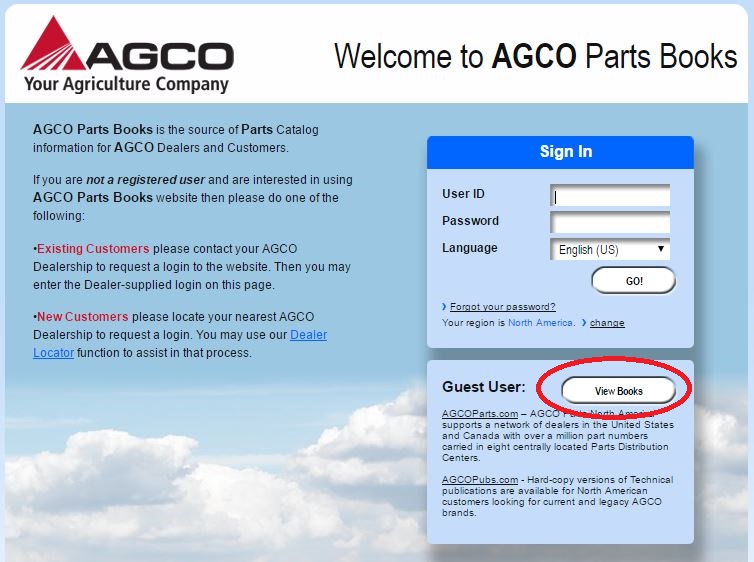

Check out Agco Parts Books on line for assembly diagrams and parts lists.
AGCO Parts Books

AGCO Parts Books
Click on View Books button:
