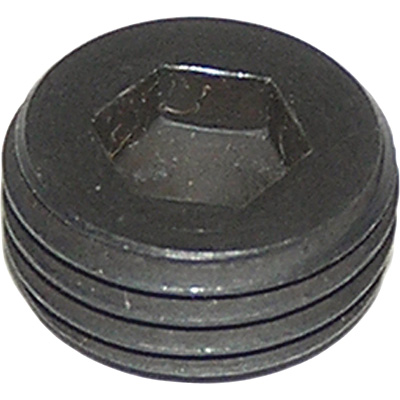

The PB adapter will be one of these.

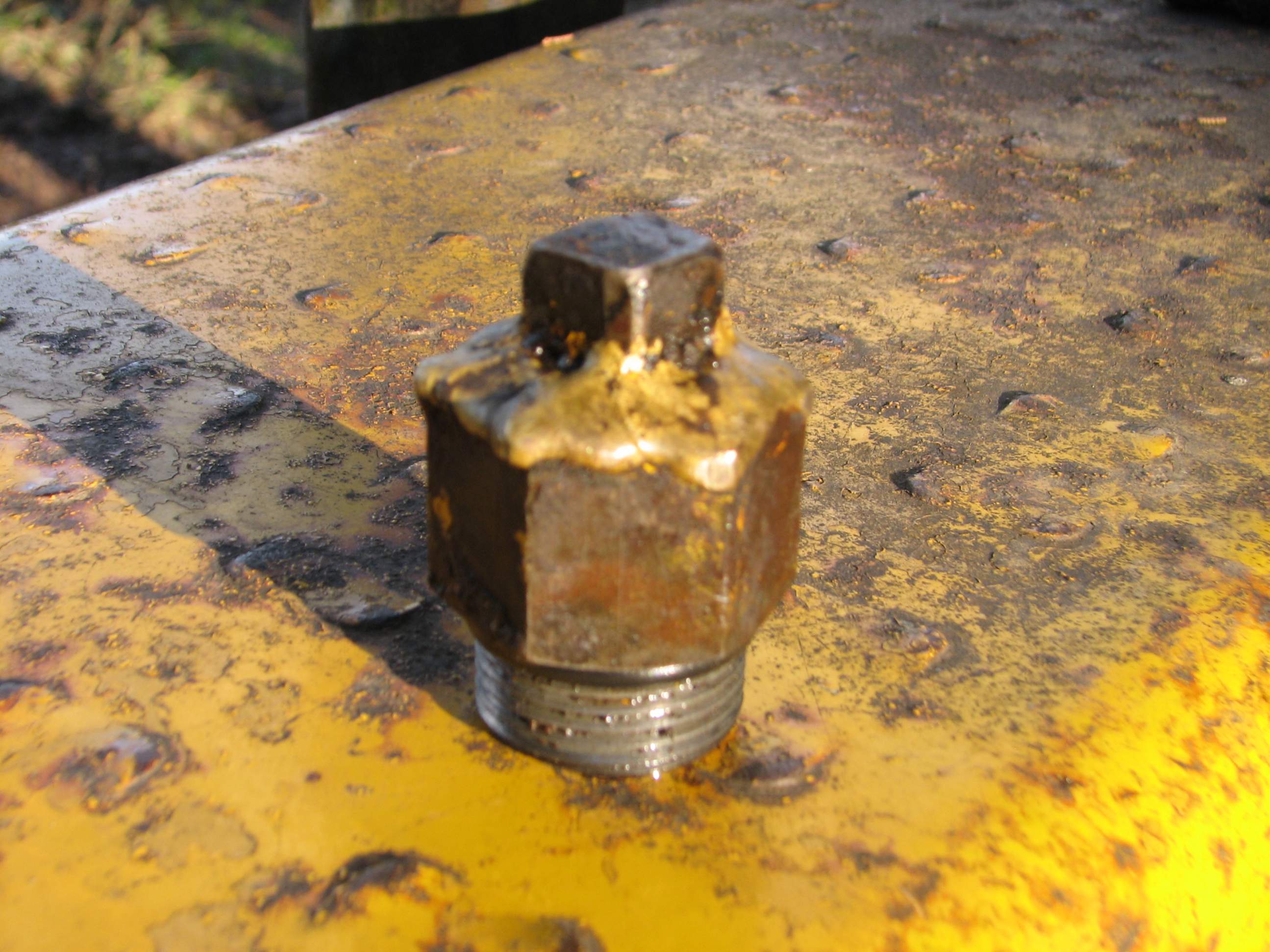

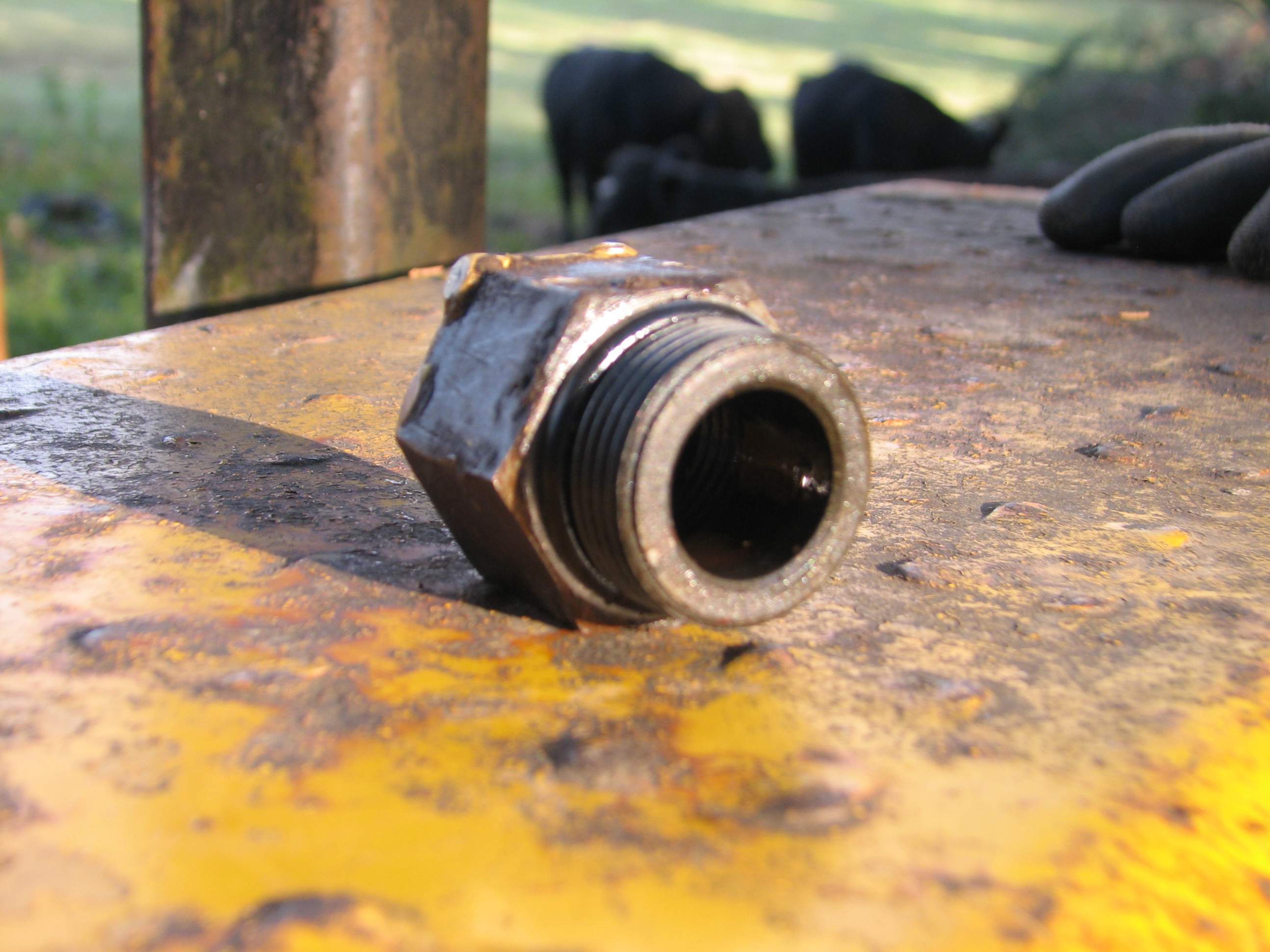

So, back to the issue at hand. I have a couple of pictures.IMG_3380.jpg IMG_3381.jpgIMG_3382.jpg
1 is of the of the PB adapter (converted to a plug) as mounted in the valve. The other is of the adapter/plug after I took it out. You can see the brazing that was done on the adapter around the square end that converts it to a plug.
Anyway, I called my local Massey Dealer and he has the plug/adapters that I need to attach the PB. So, I think this will solve this issue for me.:D Thanks for everyones input:thumbsup:

The plug you show with the brazing is a fitting adapter and not a PB adapter.
What someone did was to braze a cap on a fitting, making the valve an open center valve, allowing the full pump flow and the cyl flow to exit the OUT/return port.
You have no PB at the present.
