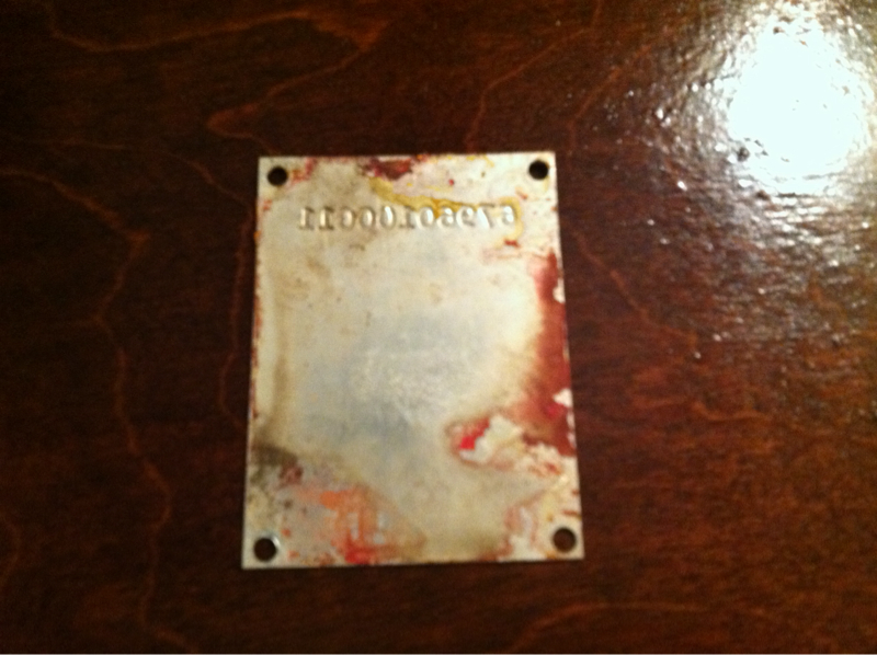

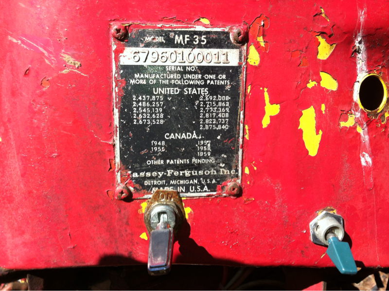

I'm interested to see the responses on this. I still haven't been able to determine the year and specific model on this tractor. The serial number is very similar to yours. However, you can see after taking the plate off, the number is metal stamped into the back. I've been told on this forum in the past that it means it's not a legitimate serial number. The tractor looks like the original paint was yellow but was painted red when I got it.

   / Massey Ferguson 35 Industrial mystery tractor?? #5
I don't understand that, why?

   / Massey Ferguson 35 Industrial mystery tractor?? #8
Early model 35 and 135 both has serial number stamped this way. If you where to take a clean close look at the patent numbers on the nameplate. They are raised lettering. that too is a true indicator of a genuine serial plate. if the plate is not traceable thru places like tractordata.com it could be an industrial model that's been repainted. On a 65 135 Continental the first three letters aere SGM for the Z145. Those embosed number are in fact real numbers. They are probably linked to the industrial version database.
