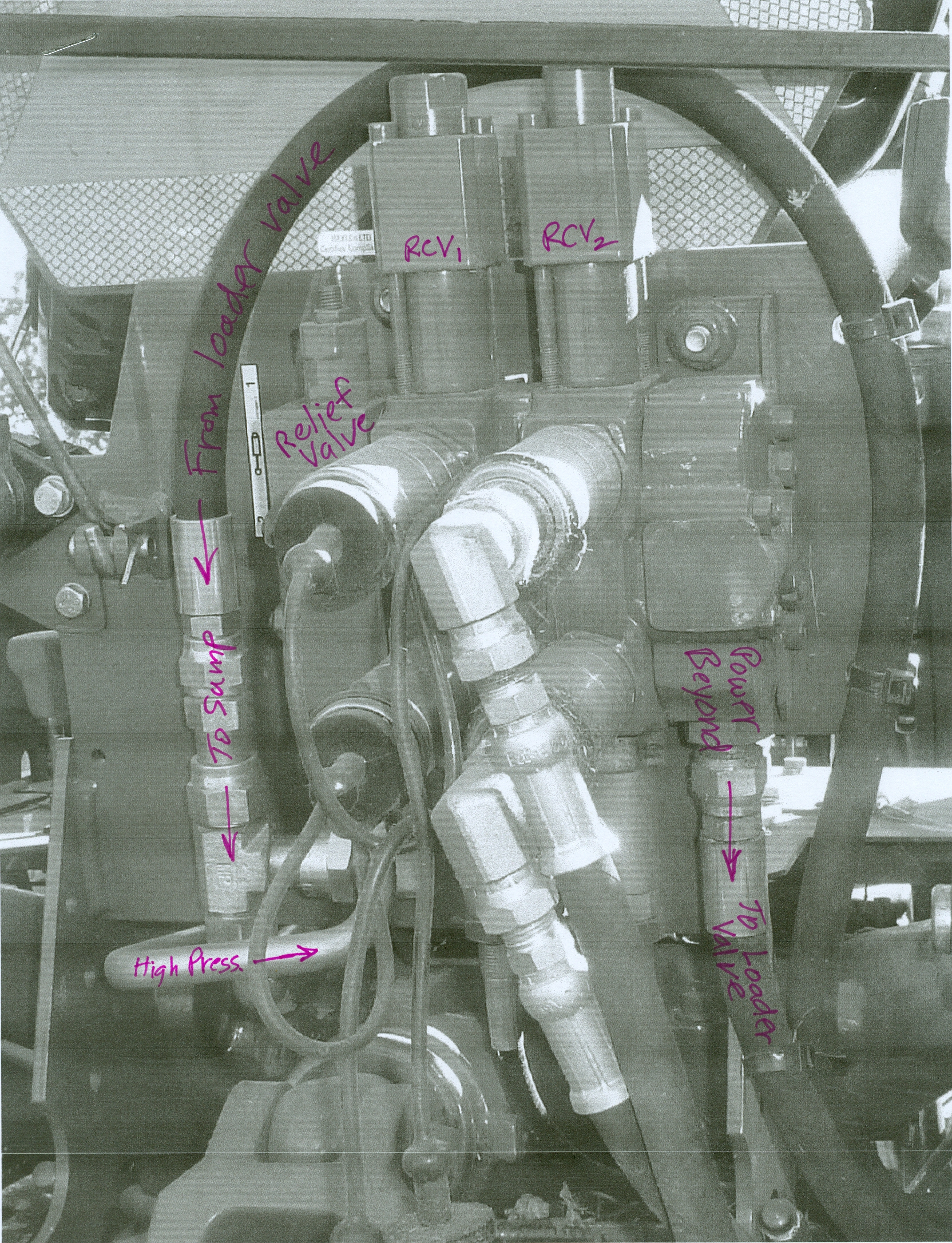

Sounds sensible to park it a bit. I think the main hydraulic pump (called auxilliary) is up along the right front side of your engine. Looks about like a slim starter motor in size and shape. You should be able to see the high pressure line going from it to the rear of your tractor where the remotes are. I assume yours is a Perkins diesel, right ?
Even being a cab model, I don't think you will need any large effort moving sheet metal or floor or seat to get to the relief valve. It should be in the open rear of the tractor above the 3pt hardware and not buried inside or underneath the cab stuff.
By far the best is to get hold of a manual and see the instructions for adjusting the relief valve on your specific tractor. The owner's manual might even show that without going to the big thick shop manual.

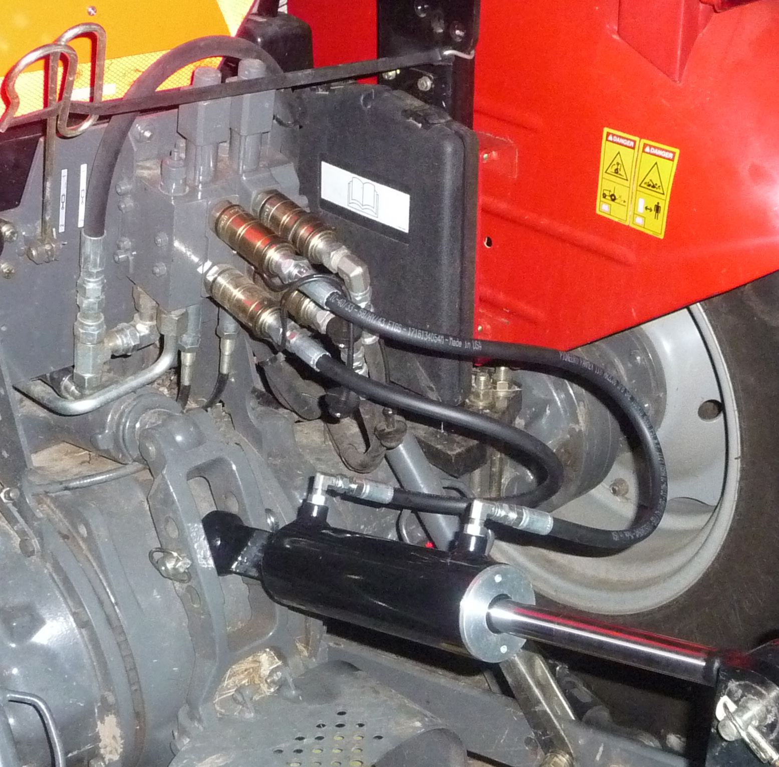

I'm going to insert a photo of what my MF 2660 back end looks like with some labeling showing the relief valve. Yours may well be configured differently but SOMEWHERE you will have a relief valve that probably looks like this one. It has a lock nut on top and then the larger nut (really the top of the valve plunger) that you turn for adjusting. Just double click on the images and they should come up for you big enough to see. The B&W one has notes to show what is what and the color one is just a second view.
