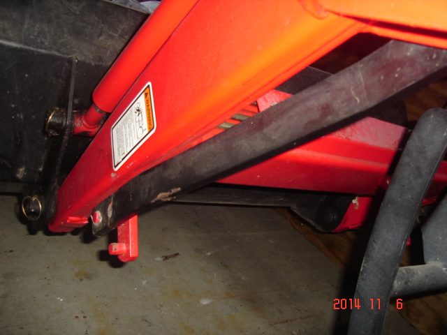

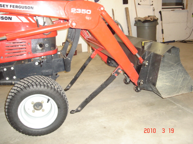

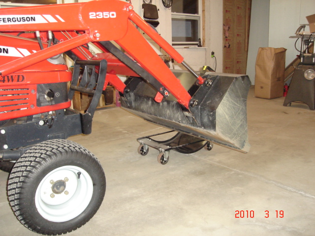

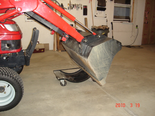

also, i never took the loader off, i see the two pins that come out and quick disconnects, how does that come off?
   / massey ferguson 2300 #9
There are two legs, (black steel), that fold down from the loader frame.
And you pretty much lower it on to them.
   / massey ferguson 2300 #10
Google the MF brochure for the GC2400/2600 on page 15 there are instructions to remove loader.
