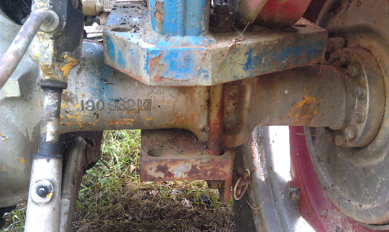

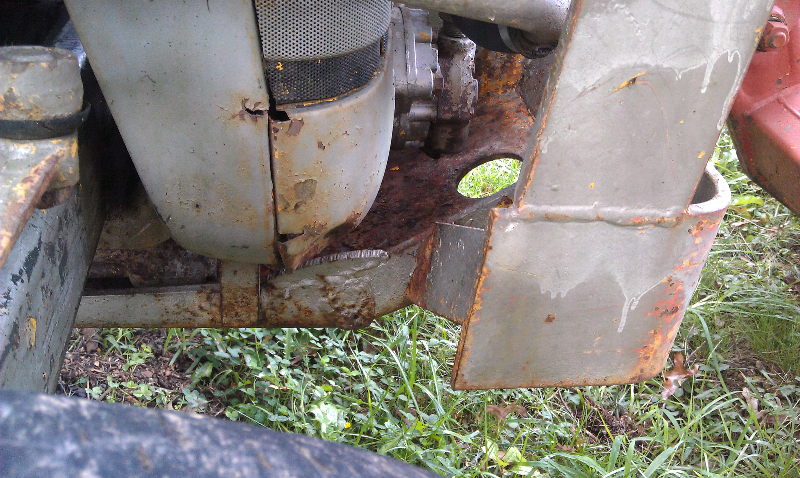

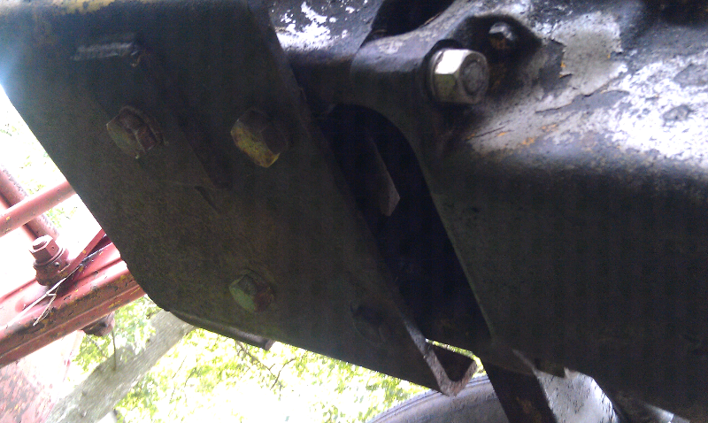

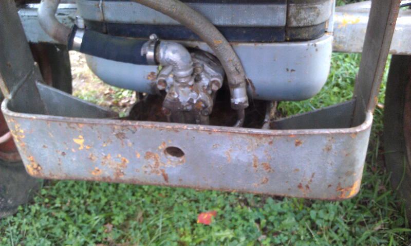

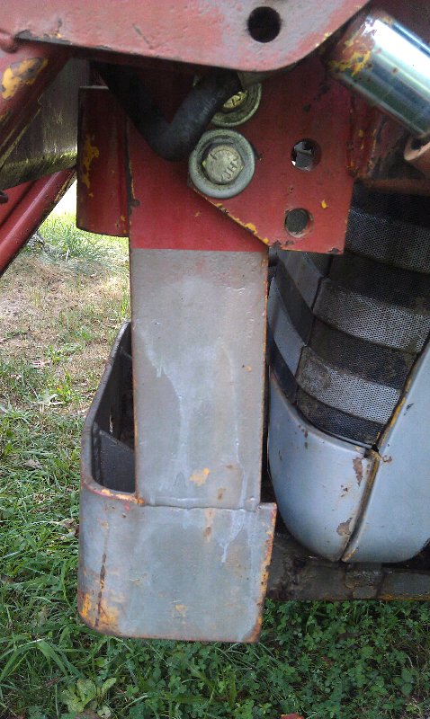

It would be nice to get some up close pictures of how to loader mount mounts to the underside of the tractor. Include all the points of contact please. Also maybe how thick of metal the mount is made with just in case I have to fabricate one up myself.

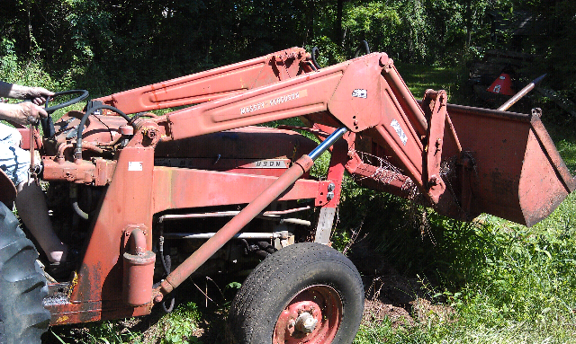

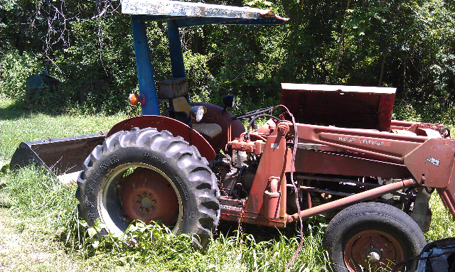

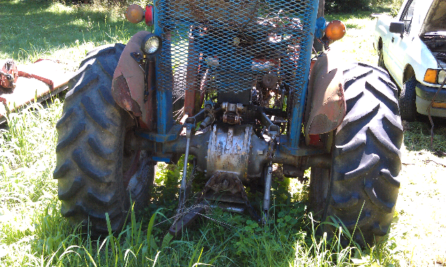

   / Massey Ferguson 2135 Loader Mount #5
I'm looking at getting a MF2135, and took a look at how they attached the MF200 loader.
They welded it to the bottom rear plates that straddle the axle. These plates are thick, and are also used to support the Ford roll bar (blue)
See rear pic.
I also have side pics, to show how the frame fits in. If I get the tractor, I load up some more pics.

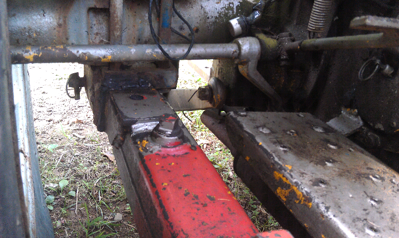

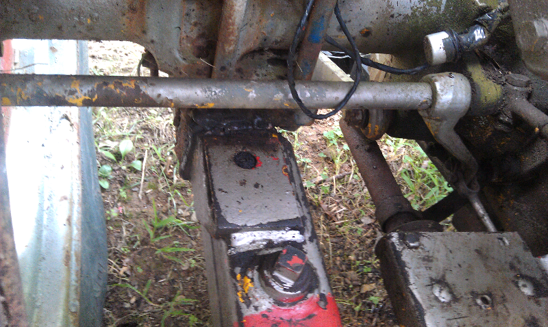

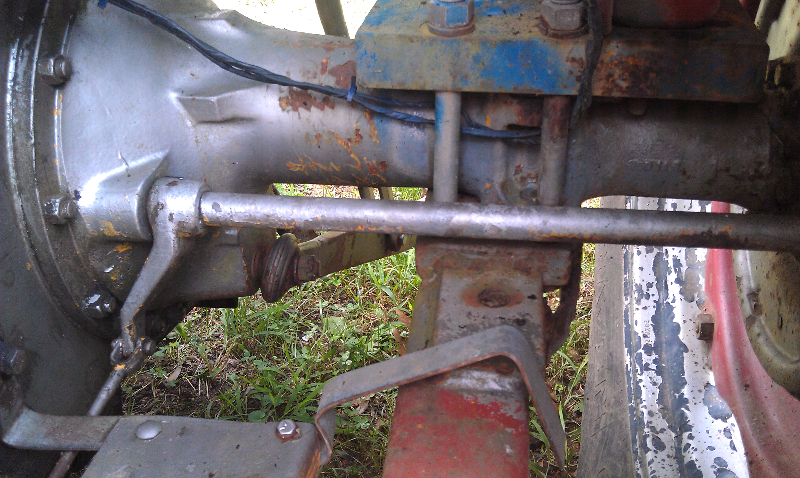

   / Massey Ferguson 2135 Loader Mount #6
FarmerDay92,
I took a closer look at mine.
The rear of the Massey 200 loader has tubes that extend back to the rear axle. The tube was welded to a steel plate 1-1/4" x 5" x 8" that is through-bolted onto the axles at the flat point. Looks like additional steel plate was welded on for stiffness.
The front is a welded frame made of 1/2" steel, with 4 bolts at the underside of the motor. The frame bottom is a 13" wide x 28" plate with 3" bent edges, tapered to 1-1/2 for clearance under the tractor.
The bottom front frame band is 1/2" x 6" wrapped on the front. The upper frame band is 4-1/2"x1/2" and forms a profile similar to the hood nose. The upper front band is about the same height as the loader attachment, and is 4-1/2"x1/2" steel.
