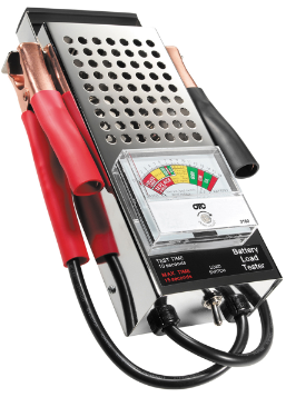

I have two questions. First I am looking for a headlight assembly for my 210. P/N 3282309M91. Second, it takes several clicks of the ignition key before the engine turns over, Is this a weak battery or another problem?
   / Massey Ferguson 210 #2
Get a battery load tester like this and it will let you know if it's a weak battery or the solenoid is starting to go:
   / Massey Ferguson 210 #3
That device will certainly tell you if your battery is bad, but I doubt that is your problem. If it were a weak battery, it would NEVER start, regardless of how many times you activated the key. Activating the key won't somehow make the battery stronger.
