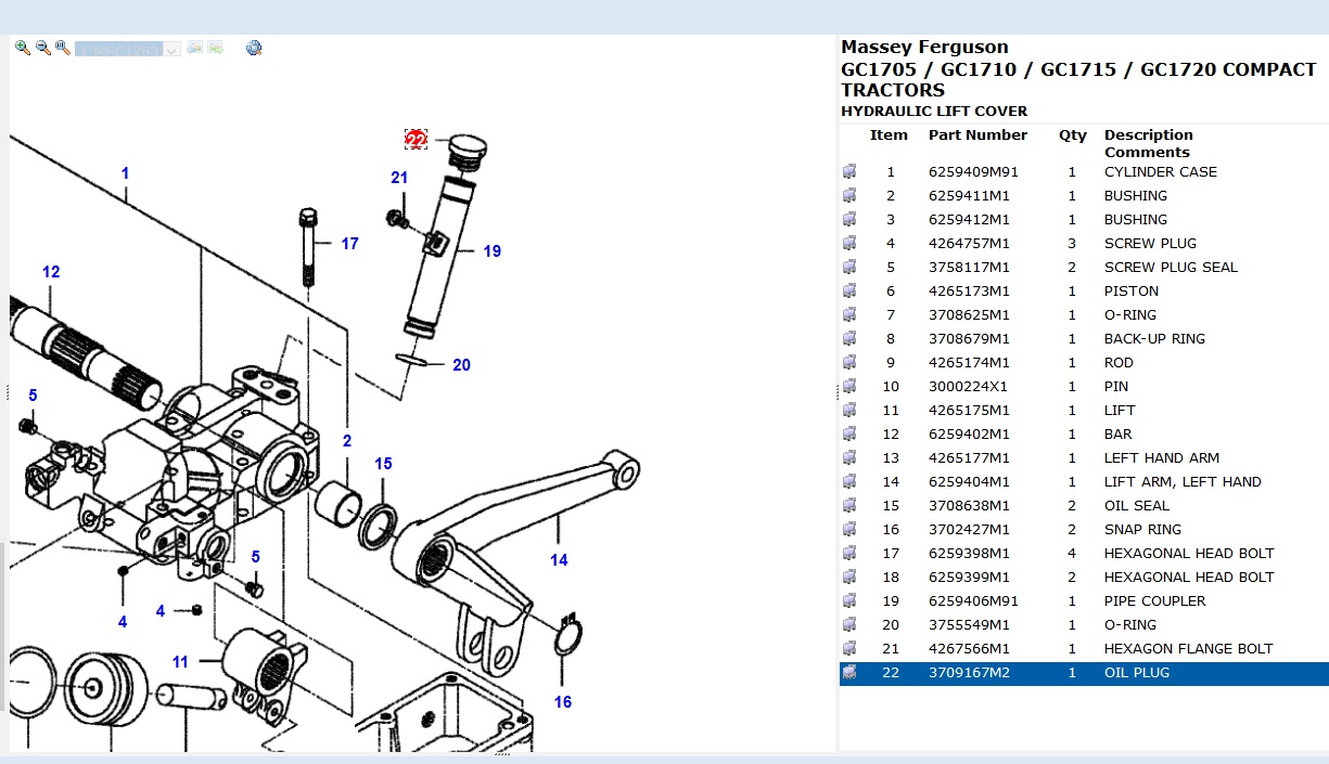

Is the filler spout cap for the hydro oil also a breather valve?
3709167M2 Oil Plug

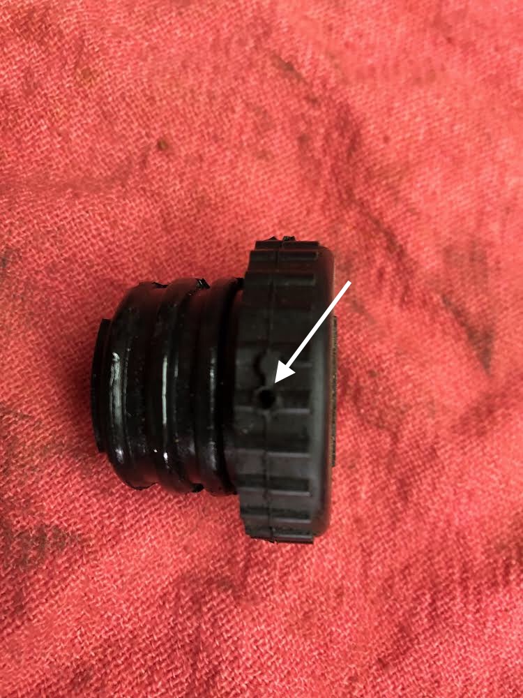

DMW, If I had to guess I would say yes. When I took a close look at my cap I noticed there was what appears to be a dirt trap on the bottom of the cap. However, there is no pinhole in the cap itself to vent to the atmosphere. I’m thinking about drilling a small hole in the cap. It’s interesting that there is a white dot on the cap where I would think the hole should be.

I wouldn't drill a hole, just check the spring is functioning. Don't over tighten to cause deformation, don't use a thread sealant. Check the drain hose on the hst for any obstruction.
Pressure buildup is usually due to oil level overfill or underfill. The cap may work well for atmospheric change, but sudden increases due to air being sucked in and foaming the oil due to underfill may be too much for it. Keep an eye on the condition of the oil in the sight glass. before/during and after use.

Mine has a vent hole in the side of the filler cap. I have a hard time imagining pressure building up high enough to blow the sight glass out. I wonder if it was just installed wrong at the factory and it just fell out.

Well, I replaced the sight glass and took a closer look at the fill cap. I found the vent hole and couldn’t blow air through it. I corrected the problem by running a small drill through the hole. It should release the pressure now. Corrected vent below.
