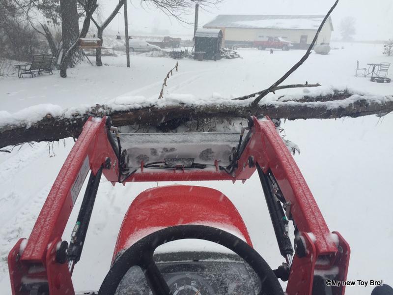

The first thing I did with mine was to go out and scoop up a dead fall in my field. Yes, I could have used the chain saw and hauled it back to the wood stove, but what fun would that have been!

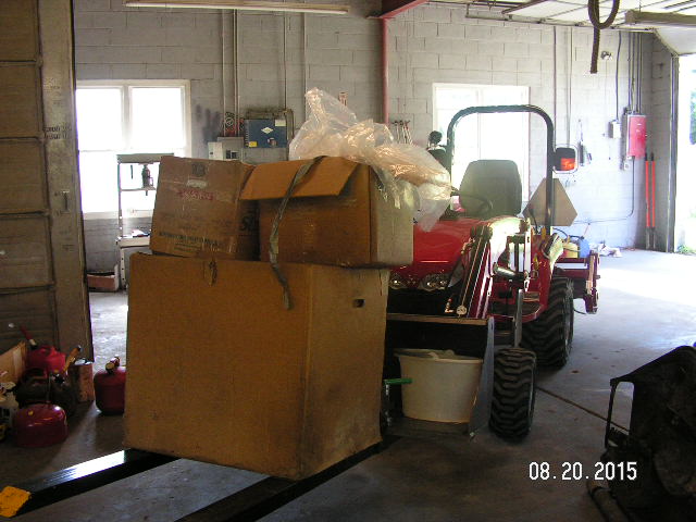

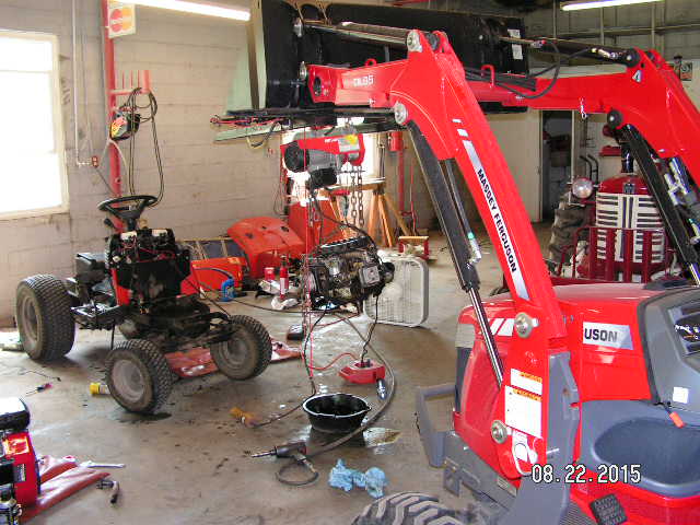

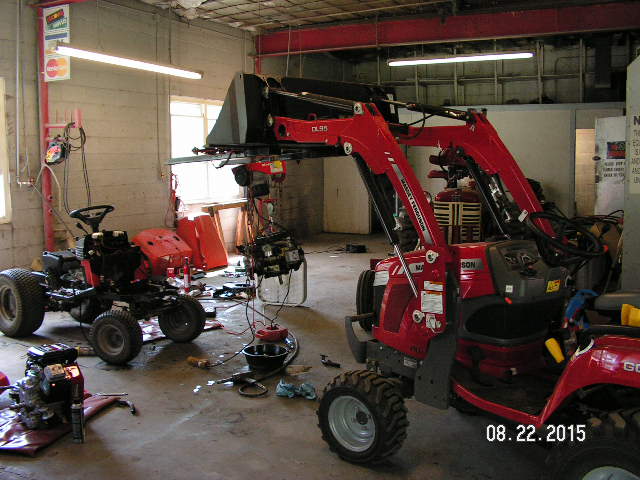

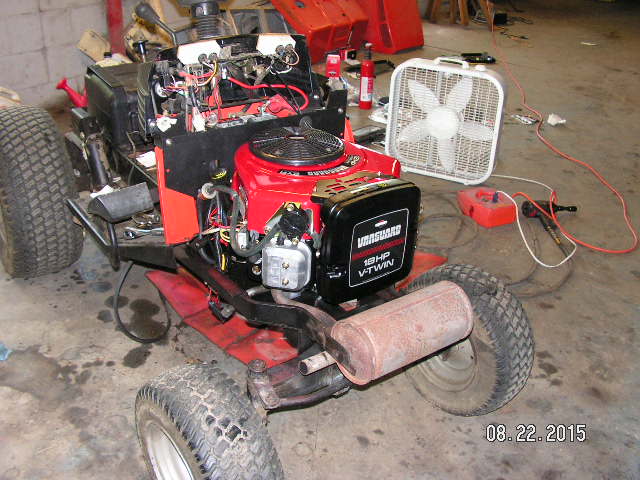

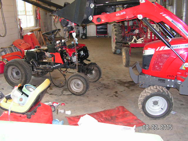

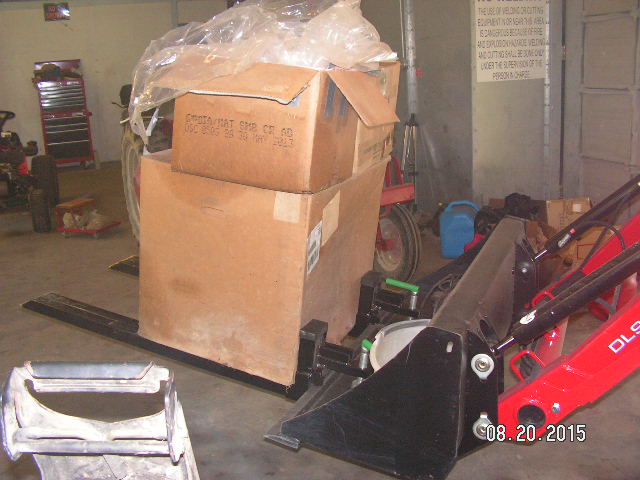

I bought my GC1715 mid July 2015. It didn't take long for it to start earning its keep. PICT0902.JPGPICT0903.JPGPICT0904.JPGPICT0907.JPGPICT0909.JPGPICT0910.JPG
It helped me install a brand new B&S 18 HP Vangard engine in my Simplicity Landlord. The forks came from Titan, and have been a tremendous help as you can see.
The hoist is an electric hoist from Harbor Freight. I have more than gotten my money's worth from it too.

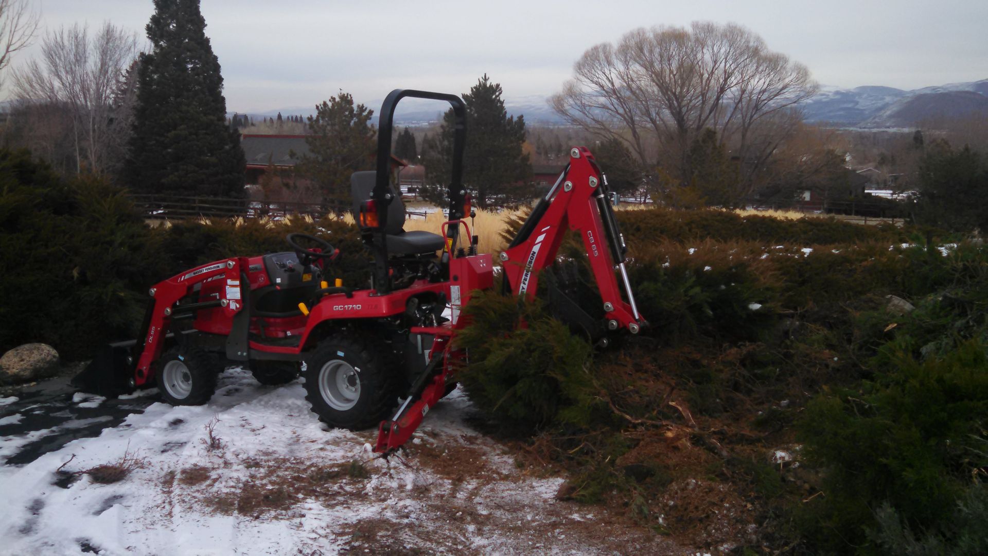

36 years is enough time for junipers to grow. Then its time for them to give way to something new ....
   / Massey Ferguson 1700 series in Action, A Picture Thread
I think you liked those junipers, you just wanted to see if the tractor could take 'em!

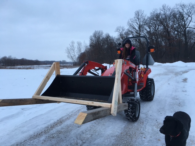

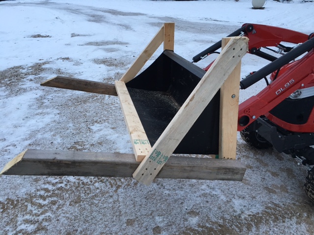

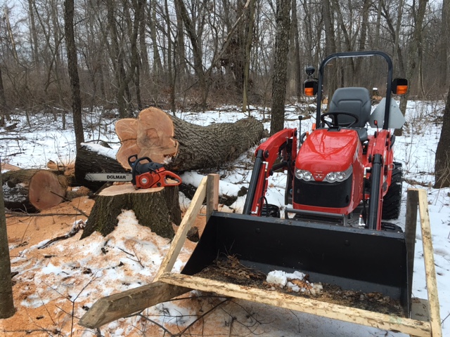

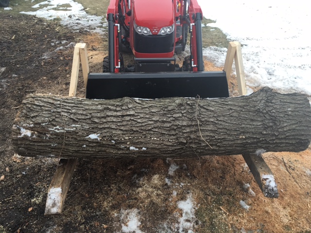

I cut a lot of wood in the winter to heat my house and shop. I have around 20 acres of woods behind the house where I do most of the cutting. My main method of getting wood out of the woods is with my ATV and a trailer. I had this hairbrain idea to build some forks for my 1715 so I could just cut 8' logs and haul them back to the wood stove. The bucket has a hole on each side near the top. I bolted a 2X4 to the bucket through the holes, and built from there. Very crude, but it actually worked. I was hoping to haul two logs back, but one seemed to be about the limit.

Man, now that is ingenious! I'll be looking to fab me something like that too. Thanks for sharing.

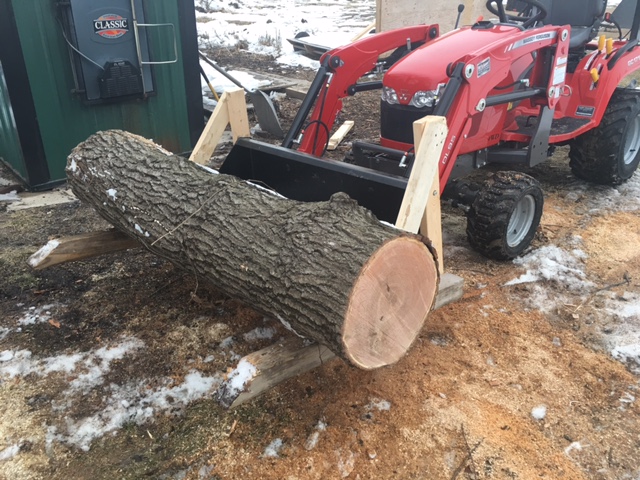

Hauled out some logs today.
The homemade forks were working great, until I tried to pick up a big slob of a log. Bolt pulled through the pine board. Will replace with oak boards next.
