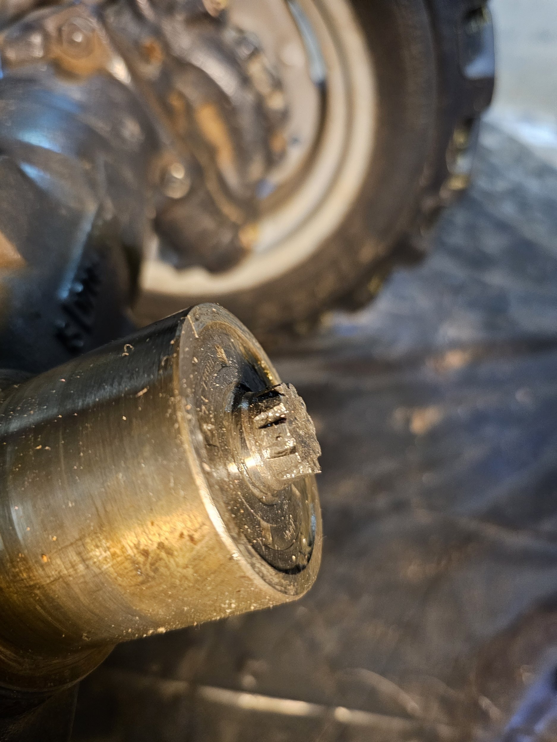

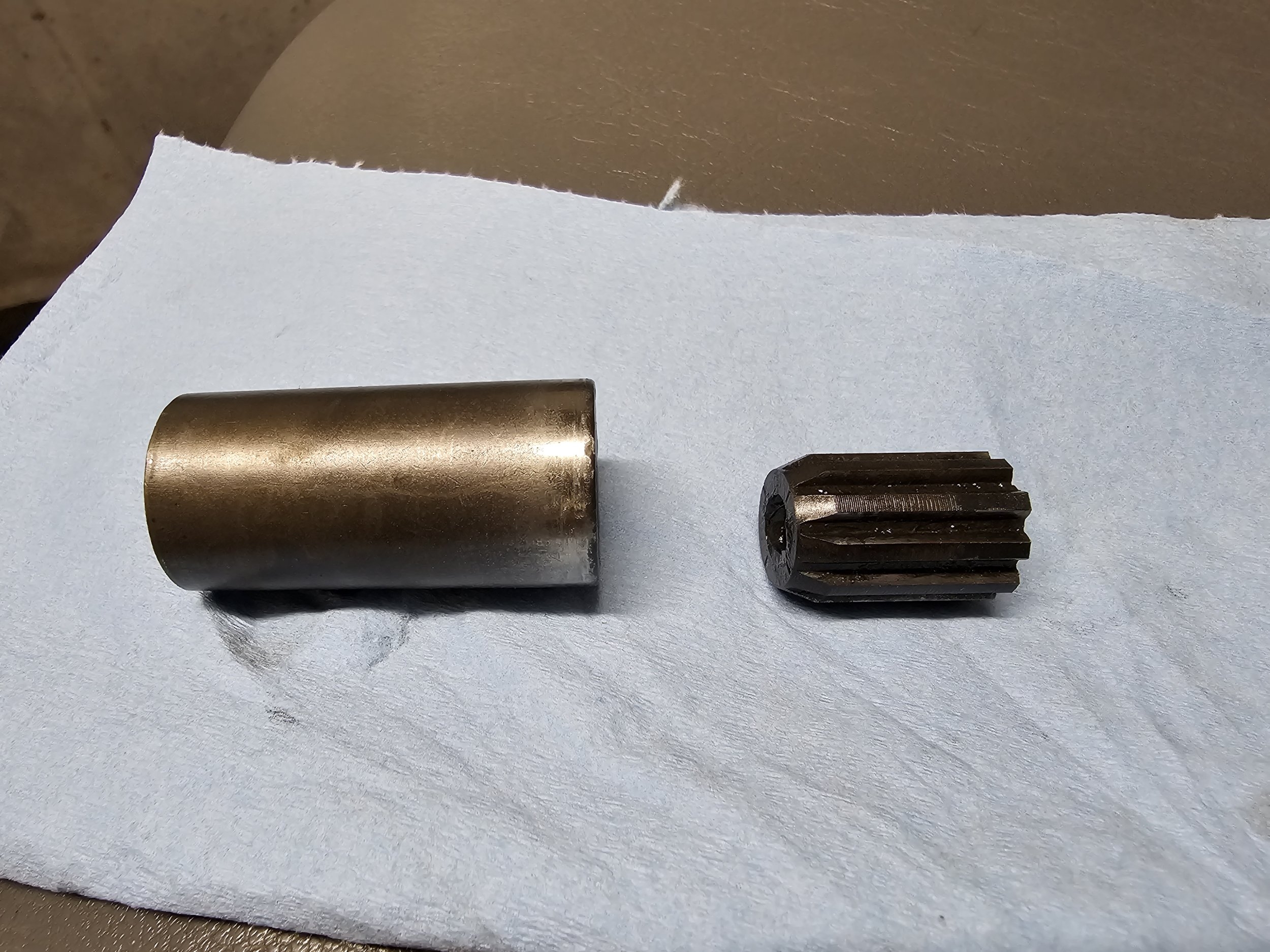

The 1528 has a very weak design to attach the front axle to the frame. It is only 2 small bolts. If they have become damaged by dropping a front tire into a hole or bumping a tree, the axle will shift enough to break the drive shaft that runs to the front axle.
On mine the front plate the axle was bolted to broke the weld at the frame when the front end dropped into an unknown hole in a new to me hay field.

You're spot on. I have a broken pinion shaft where it goes into the first coupling. I found one of the two bolts that hold the rear of the front axle pivot bearing to the frame was missing and the other one was loose. I imagine it got out of align and stressed the pinion shaft enough to break it. I plan to do the repairs myself. Beaking the whole front axle down soon so I know what all parts I need to order. This isn't going to be cheap....
P.S. all the frame mounting points look good. No cracks or anything like that so hopefully this will be a new ring and pinion job and that's it.
