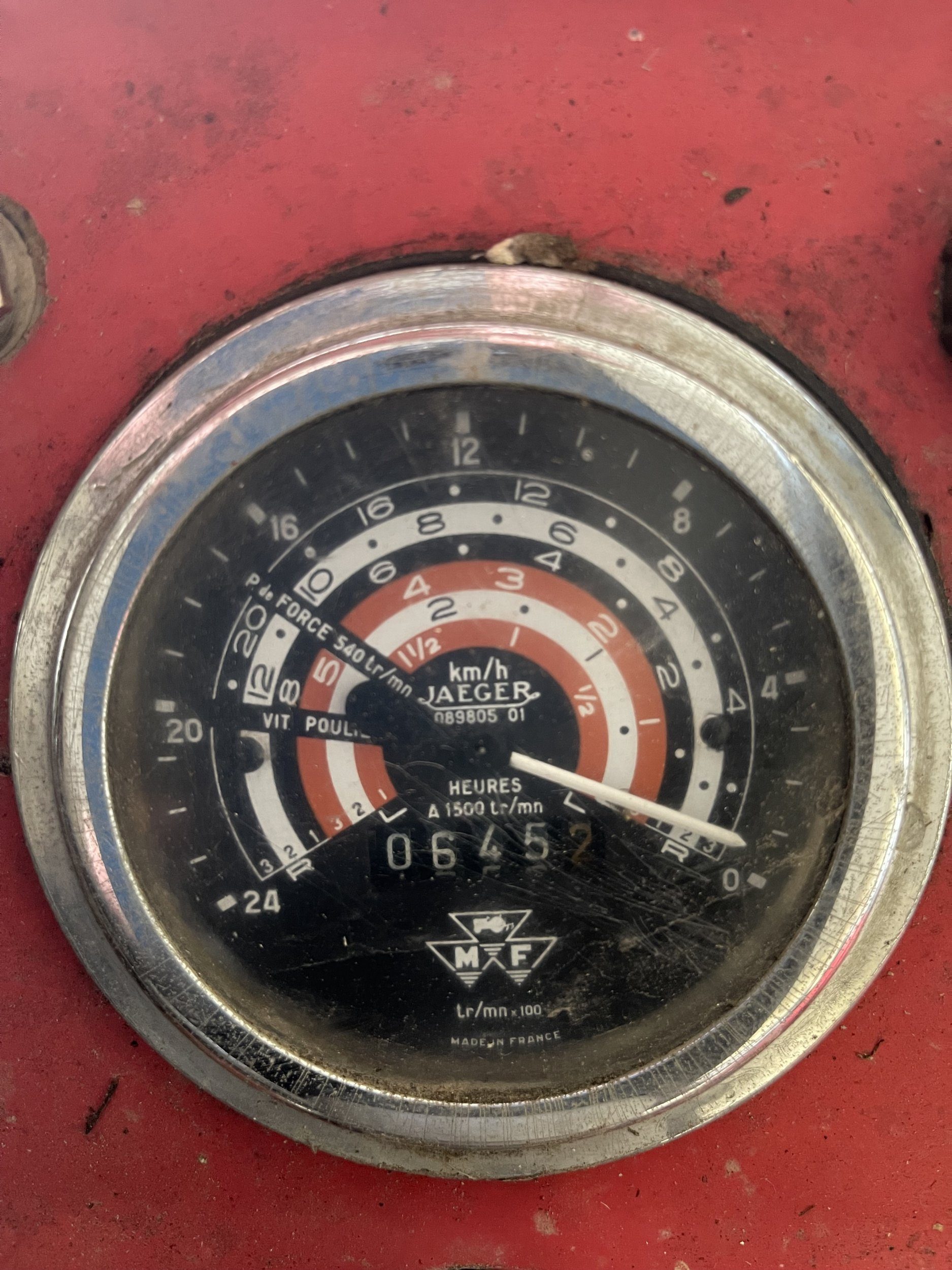

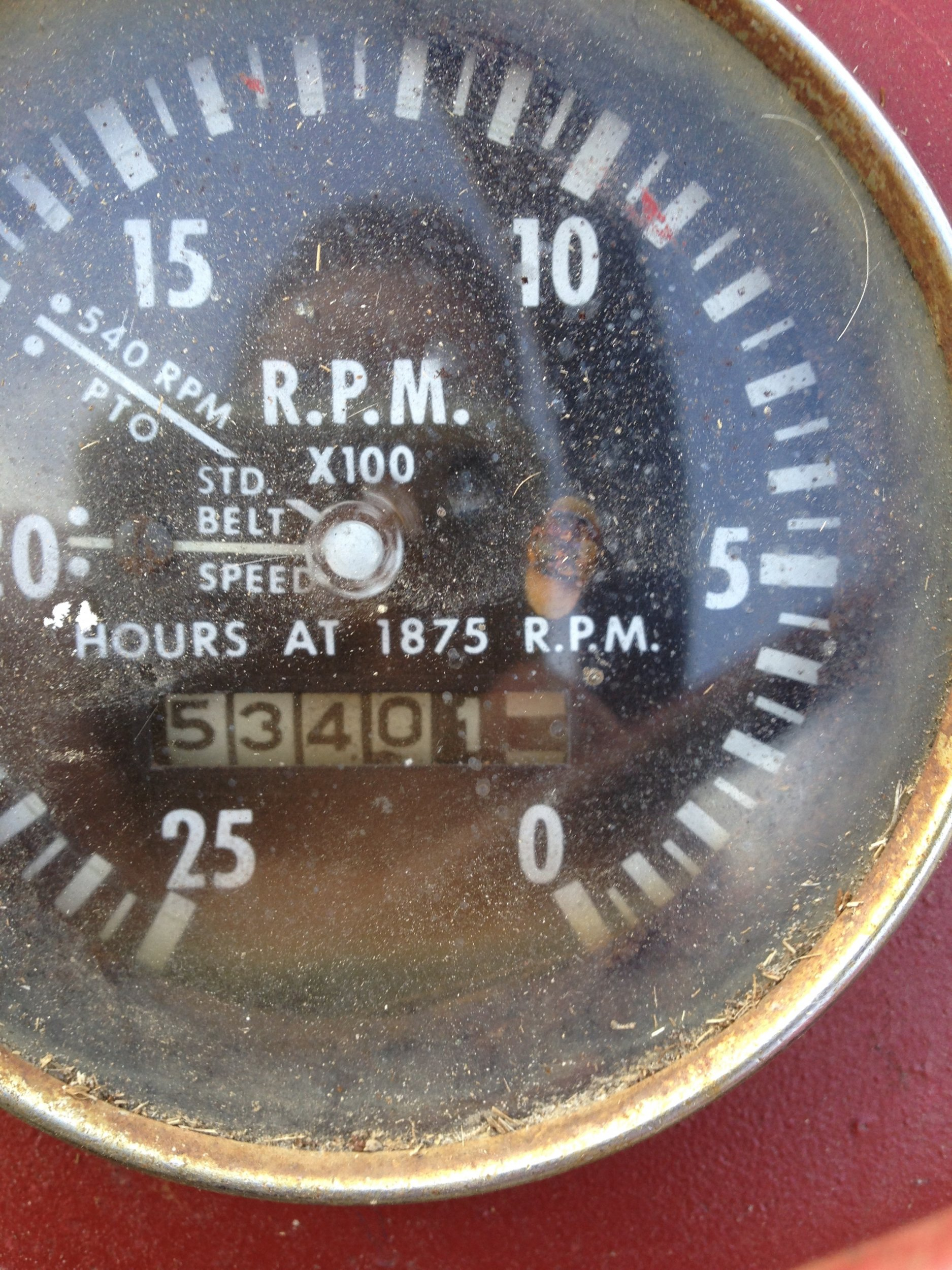

Is the tachometer/hour meter the original? 600 is pretty low. I have a 1975 MF 135 with a working hour meter but the tachometer needle bit the dust years ago.

Hi. Thanks for the responses. I've translated the 'repair bill' and it seems to suggest it was engine related and dated 2014. Perhaps the owner had paid for the brake separately and recently. And I've come to learn with an 85 year old French gent, that recently could be a decade ago. It's relative! And maybe something was lost in translation between the French owner, the Belgian agent and our English. I will try and contact the garage the did the work as they're still in existence and see what they have on record.

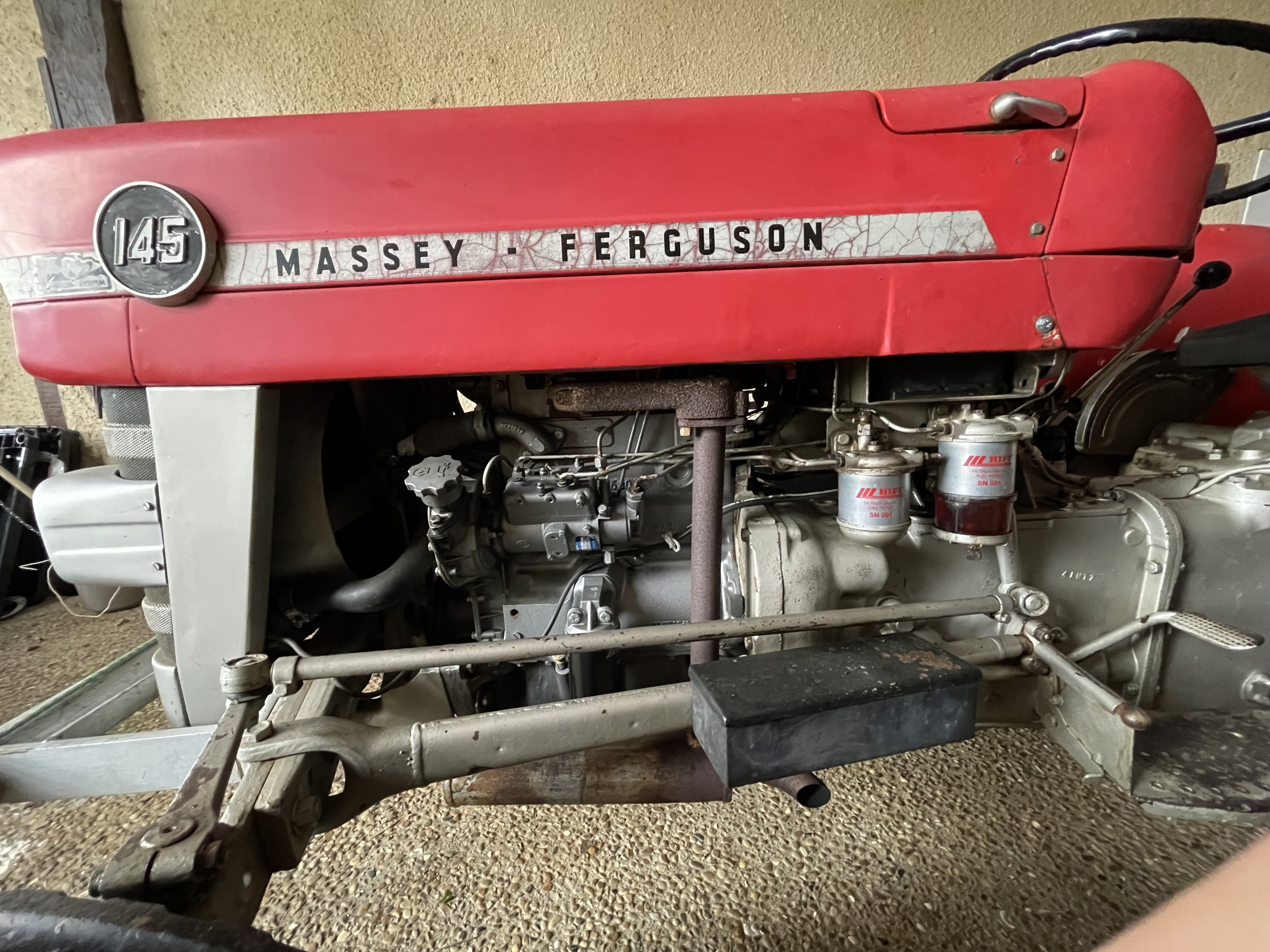

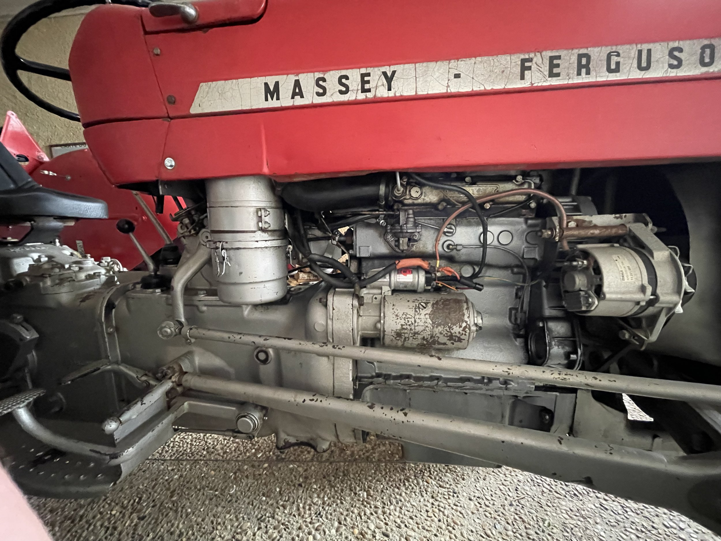

It's certainly low in hours and for the last 30 years he's owned it, it's just cut grass and pulled a bowser for watering the plants. I can only assume it's the original dial and working. Time will tell. I've attached some photo's for reference.

That's a good machine you have. I've owned several similar Masseys. They are tough machines and yours is not hurt.
