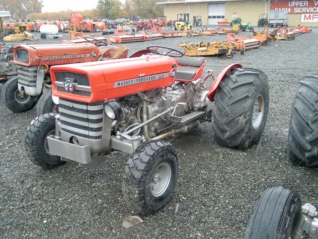

Hello ok this is what i am trying to do i have a 135 massey and the rear tires are 14-9-24 no good tubes would not help them i would like to go a lot wider mf135low.jpg like in the pic i have looked and not have found any thing they can be shorter so any help would be great thanks
   / massey ferguson 135 #3
You can go one size larger without changing rims. The next size is 16.9-24
   / massey ferguson 135 #4
Hello ok this is what i am trying to do i have a 135 massey and the rear tires are 14-9-24 no good tubes would not help them i would like to go a lot wider View attachment 409785 like in the pic i have looked and not have found any thing they can be shorter so any help would be great thanks
Those tires in your photo look like 18.4 x 16 (16" diameter rims). My 1964 MF135 diesel was set up that way for orchard work so the tractor would be low to the ground to get under low branches.
