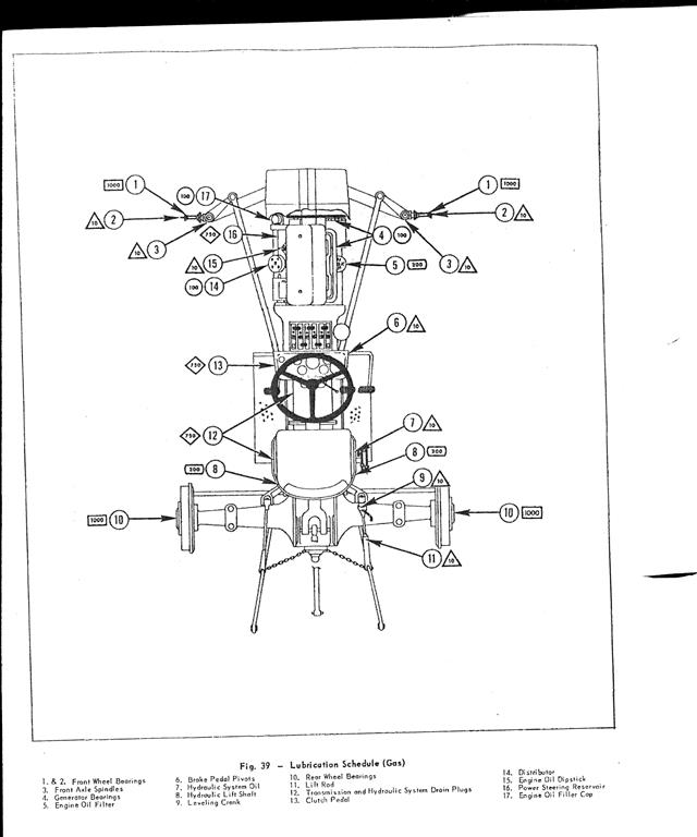

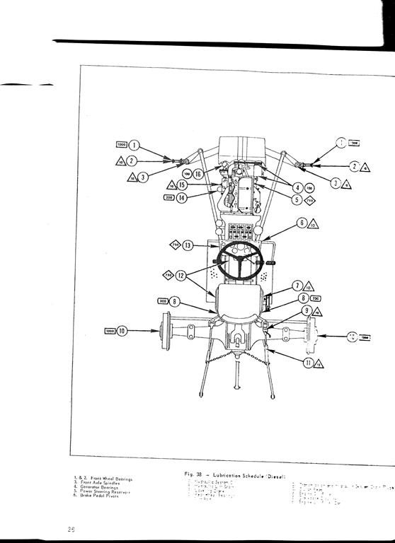

Is there a diagram showing ALL grease nipples on a Massey Ferguson 135 (1974 model) tractor. Have found some but believe there should be more.

Hi, most of them are on the front axle. A walk around the tractor with a grease gun will find most of them fairly easily

   / Massey Ferguson 135 tractor. #3
135's are simple, reliable tractors. As above, fittings are easy to find... dont recall any hidden ones on dad's, also a '74 mdl. Used it this past weekend to run the baler, did about 1000 square bales.
Sure, in the MF135 operator manual:
