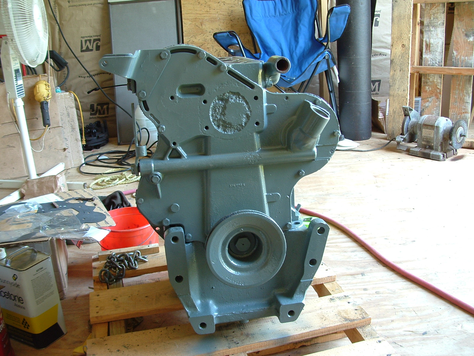

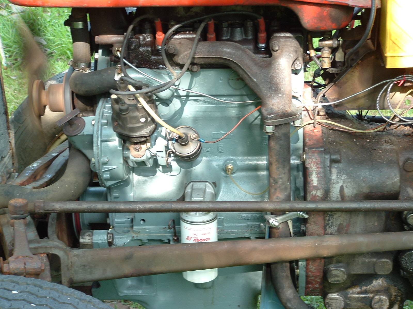

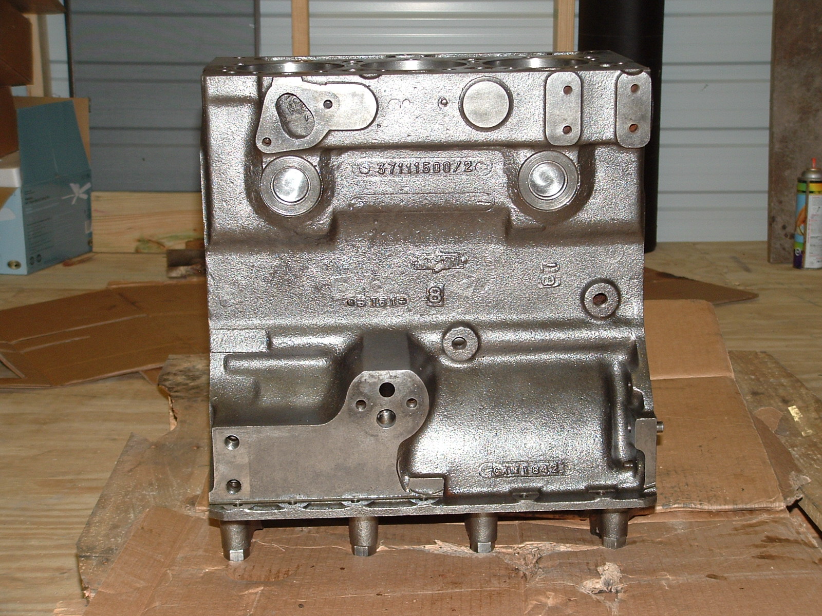

I have the same thing except a 71 model. I rebuilt the motor recently. The motor is not a lemon, it is the same block as the diesel perkins and shares alot of internal parts. I had my crank turned at an authorized perkins shop. He matched the bearings with his cut, and everything is good. I had to replace the block because it had a big crack, I got lucky in that the perkins guy just happen to have a reconditioned block with the sleeves already installed. It was set to be used as a diesel, but it is the same block/sleeves as a gasser. I would take the block to a massey dealer or perkins shop and let them pull the sleeves and install new ones, that way you only pay for 3 sleeves and labor instead of however many you might break trying it yourself. Getting the sleeves in and out is trickey and is best left to a shop that has the right tools. The IT manual is crap. I know, I have one and it is no more that "highlights". I would spend the money and but an official Massey repair manual. I may be able to answer specific questions about the rebuild, I did all the assembly work (and disassembly) and putting the motor back on the tractor with a new clutch. The head was already worked, so I did not do anything with it, but may need to in the future. Here is just a few pics of the process, I have lots, if there is anything you might want to see. I have a ways to go with other work on the tractor. Good Luck, TB

Hi fish, saw your email and responded. The crank turns clockwise, which turns the big idler counter, which turns the cam and distributer gears clockwise. I believe the rotor in the distributor will be turning counter. Easy enough to tell by just turning the motor over by hand (clocwise on the lower crank pully) enough to see the rotor move. I do not remember for sure doing this to find out myself, but must have to get the firing order right. Firing order should be 1,2,3 and my wires are in a counter order starting with no. 1 wire. See pic above. Good luck, TB
