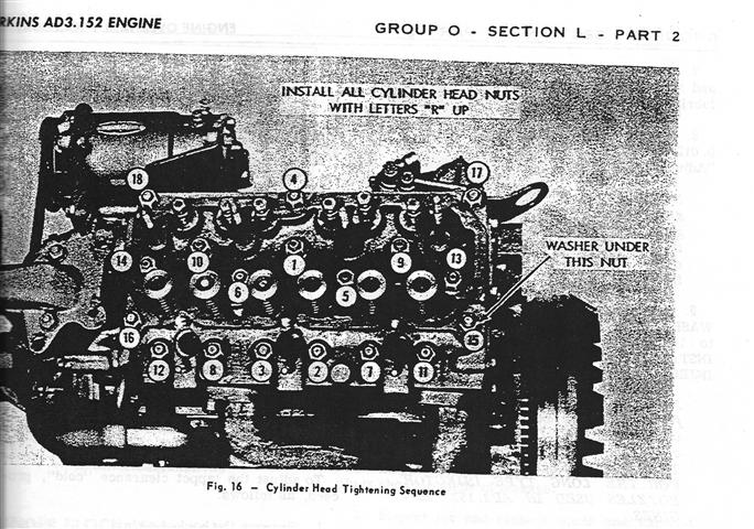

I am replacing the head on my massey 135 perkins diesel but cannot locate head bolt torque pattern or specs. Also I will also need the torque specs for the valve rocker rail. Any other advice will be appericiated.

Here's the info you need:
Head bolt torque is 55-60 ft-lb.
The service manual doesn't list torque specs for the rocker arm. Just says to progressively tighten the support nuts EVENLY, until they are securely tightened. Looks like you're on your own here.
Your drawing shows a washer on bolt # 15 as does my manual. My head didn't have one & I'm about to put the head back on. What & why one washer please?
   / Massey Ferguson 135 Diesel head torque #5
Not knowing the year of your tractor, it is hard to say, but it is my opinion that the early Perkins diesels had the washer. It was deleted on the later models, but I do not know the date. Min is a 1974 and the washer was omitted by the MFR.
