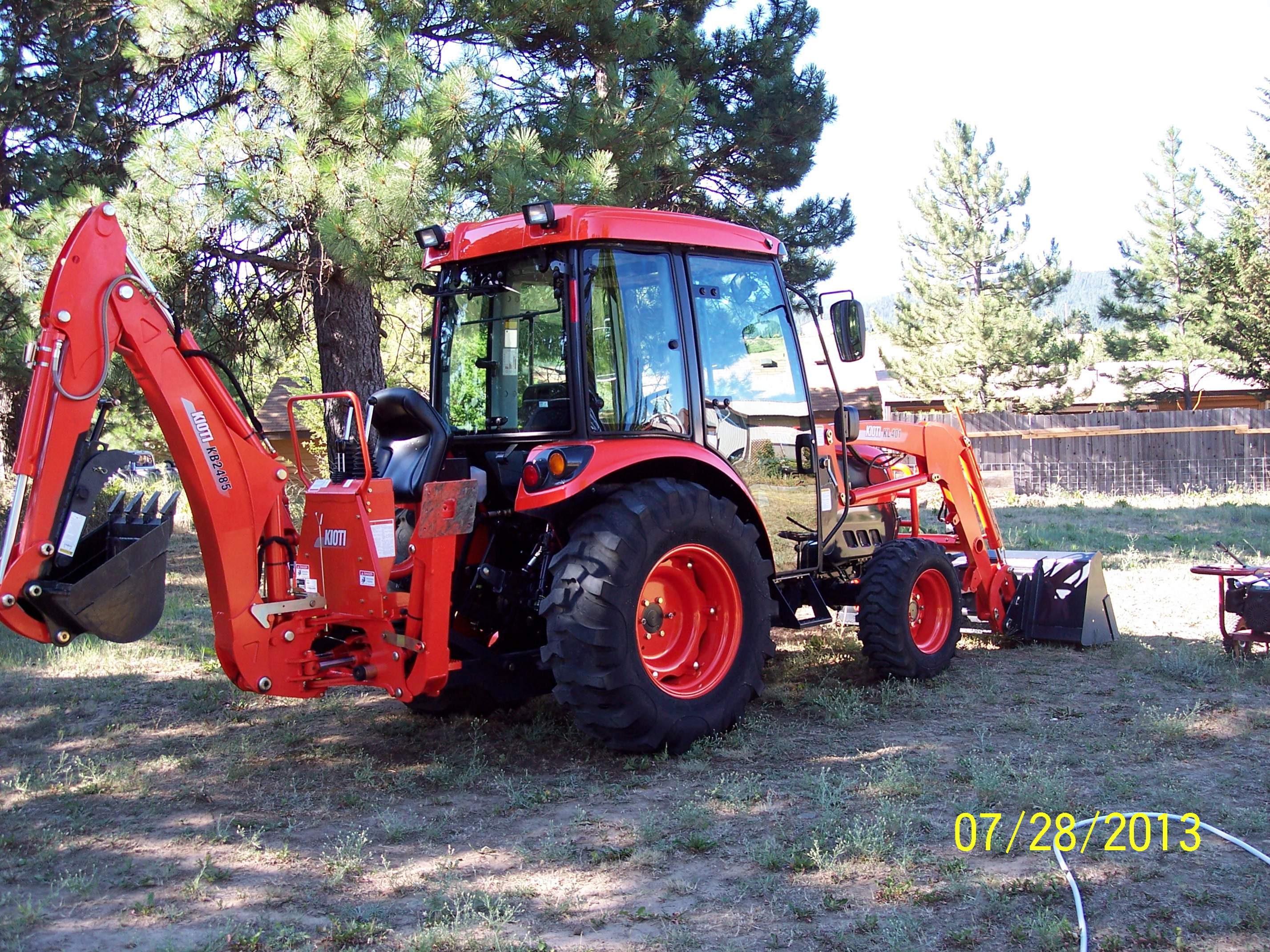

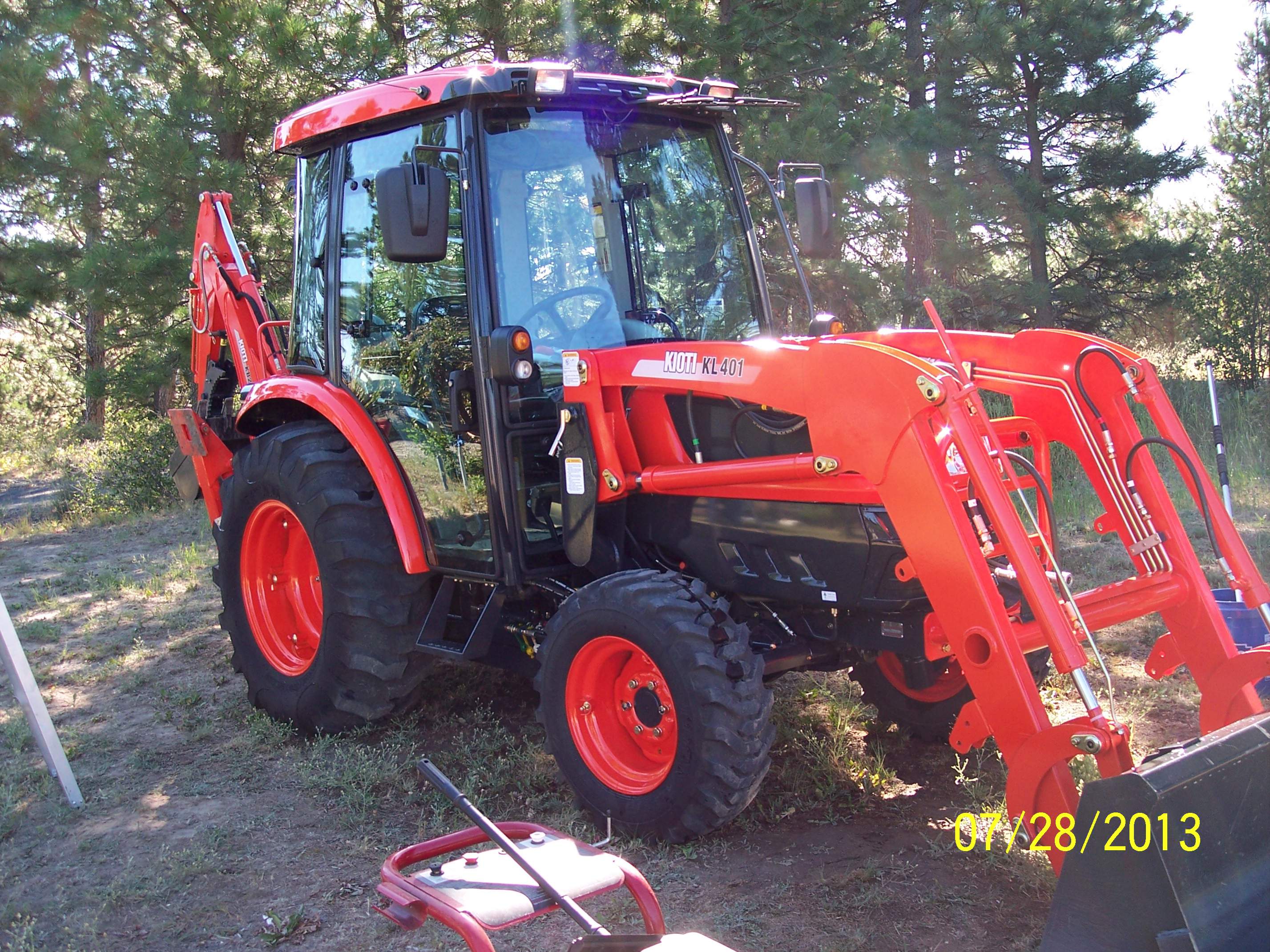

On my DK 45 HST the three point stays on. (Subframe mount Hoe)
As far as what to get, used VS new. depends on your budget.
For snow removal and hot summers ,a factory cab is really nice, heat/AC stereo etc.
I am very happy with my Kioti I bought this summer...I would recommend it.
