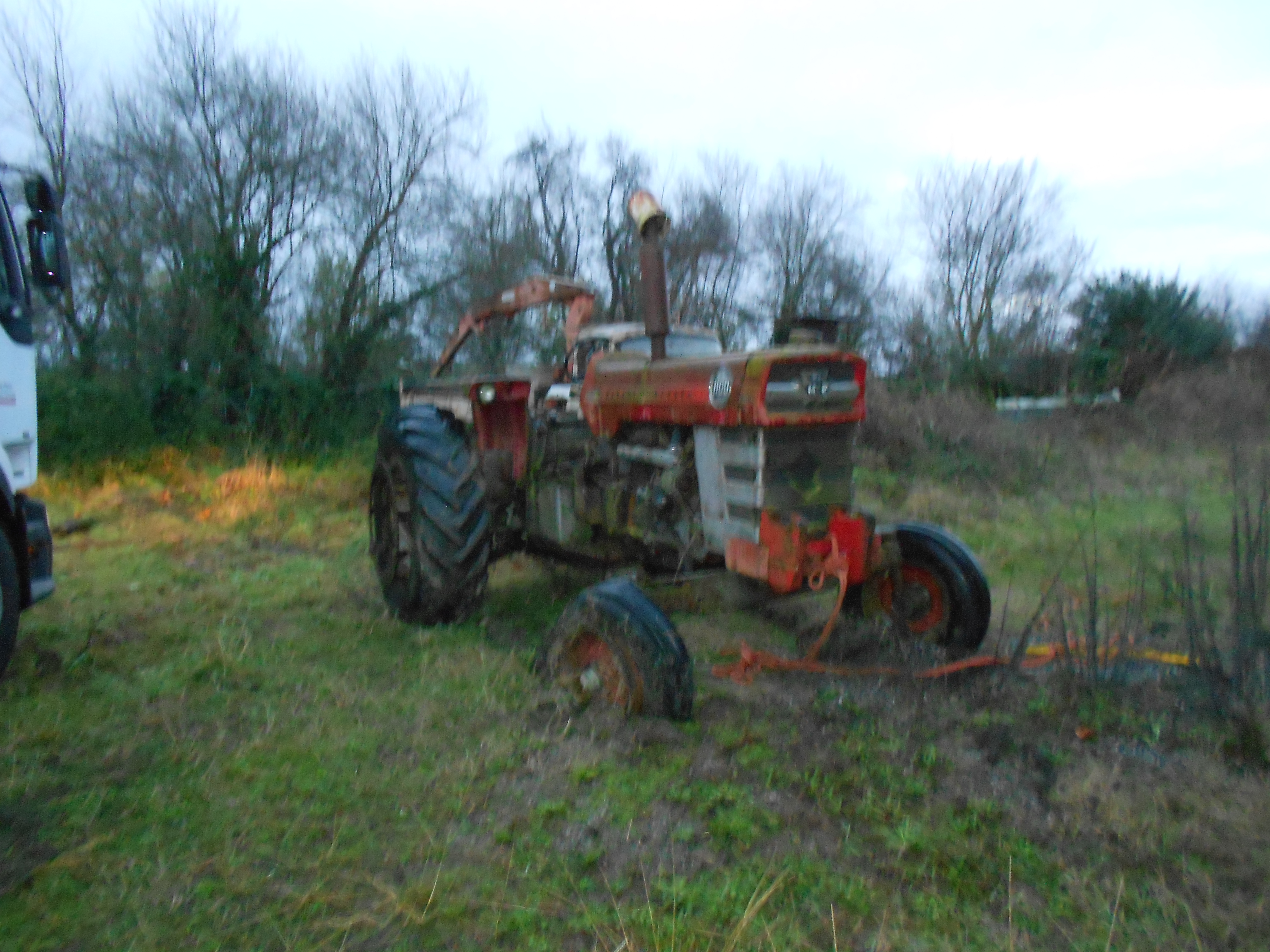

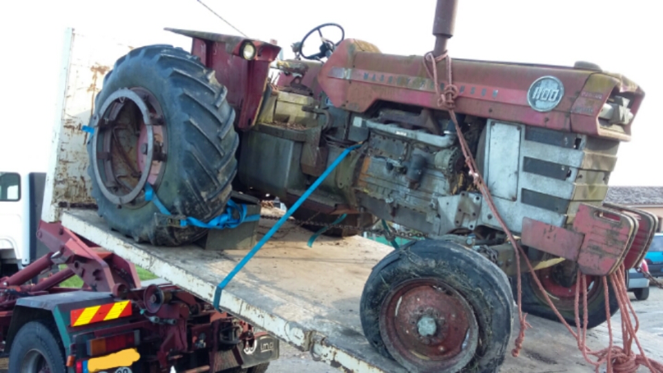

Hello everyone, currently I restore an MF 1100 dated of 1966 according to tractordata. For the little history, with my dad we saved this model to scrap at two days near :
The vid駮 of rescue :
We never see the owner but the heir, the owner was dead in the meantime. The heir told us this tractor is the second model imported in France, out of 191.
After restart, I want to put new oil in gearbox, according to the user manual, the oil for lift, transmission and the others hydraulic equipement is the same.
For the first, I clean strainer located at the bottom of oilpan and changed the principal big oil filter in front of hood.
For the second, when I put oil with the cap in left of oilpan, I just put 30-32 liters and the oil overflowed but all manuals that I could read stipulated 64 liters of oil.
For the third, I restart engine and all equipements were working properly... but after a quarter of an hour and a test drive, the steering and lift were working less and less... Hydraulic of the tractor make sound asif the pump lacked oil, to finally stop walking. I never have this type of tractor previously and I'm pretty lost. I also miss some parts for finish my restoration but I Talk about this later.

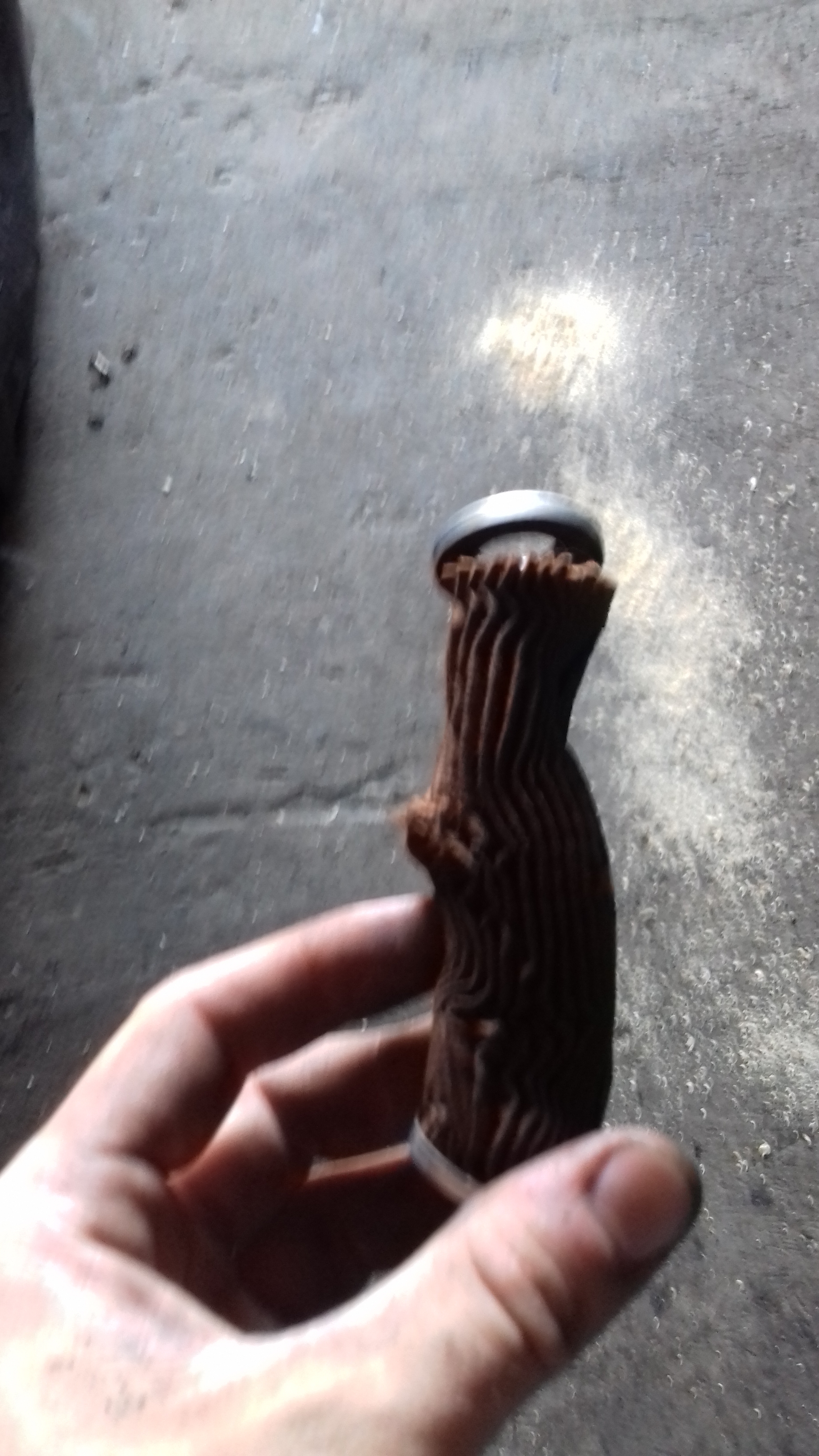

another problem, My 1100 is equipped with a strange filter for multi-power, in France this filter is really unobtainable :
Anyone have an adress for this filter ? Thanks.
