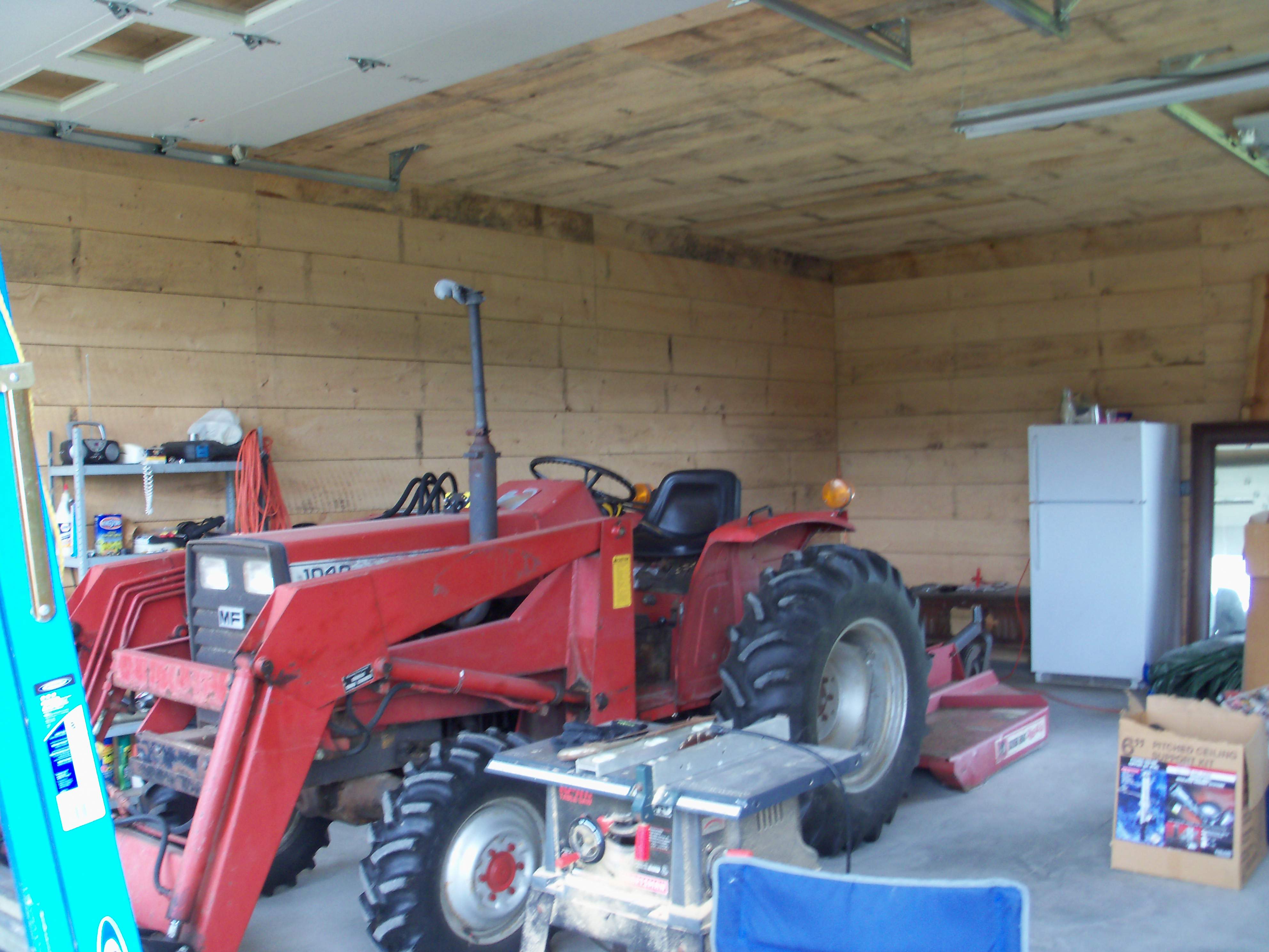

The MF1030 is the little brother to my tractor the MF 1040.
If the 4WD is working the lever should be in the downward position. I believe that your transmission is the same setup as mine, there are three ranges, low, medium and high. Four forward gears in each range and a reverse. I almost allways am in mid range. For bush hoggin the fields here I usually use mid range 4th gear, and thats about 3.5 mph maybe slightly less.

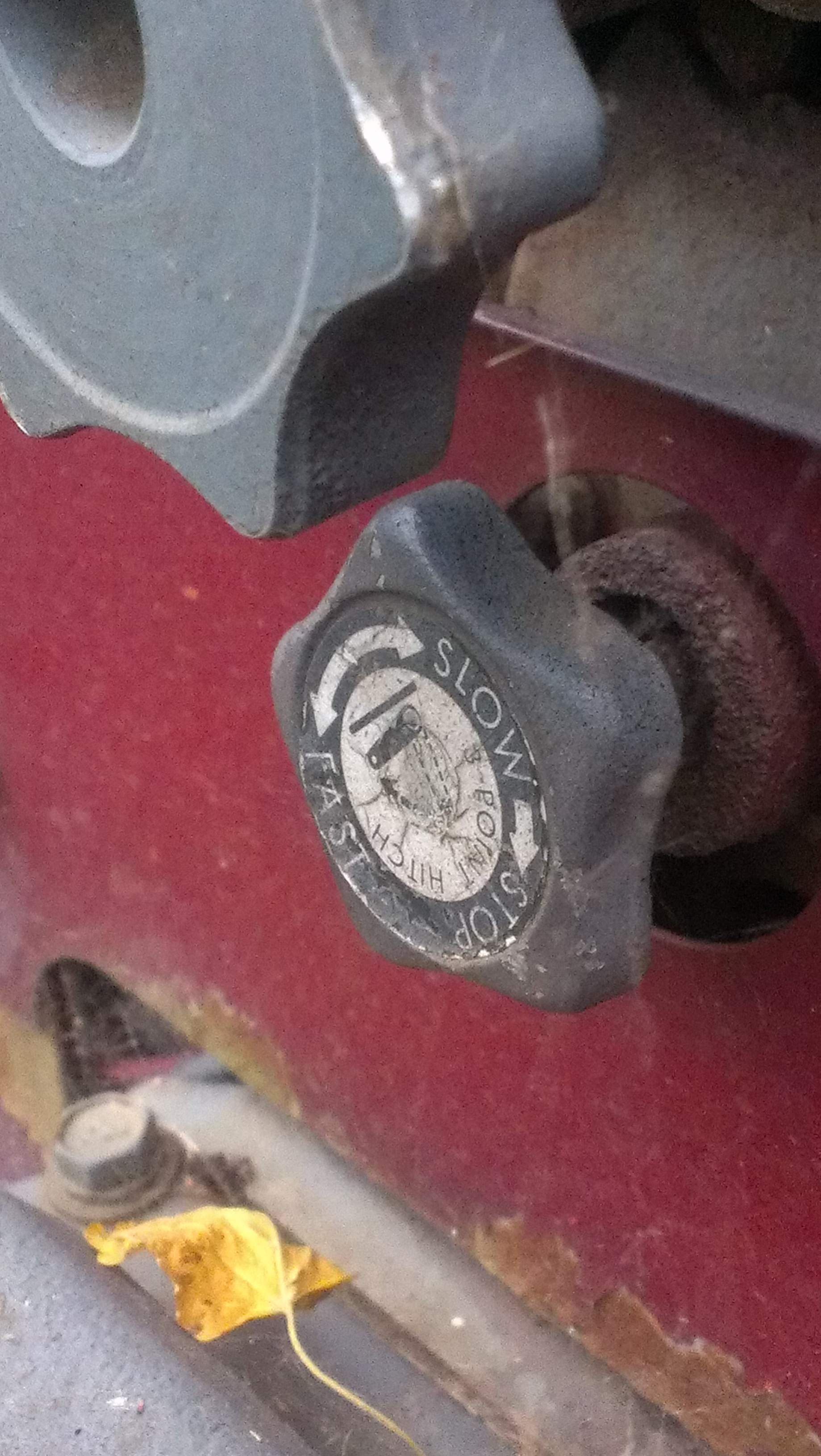

   / Massey Ferguson 1030 4wd...Questions #7
3 point drop speed controll knob.
