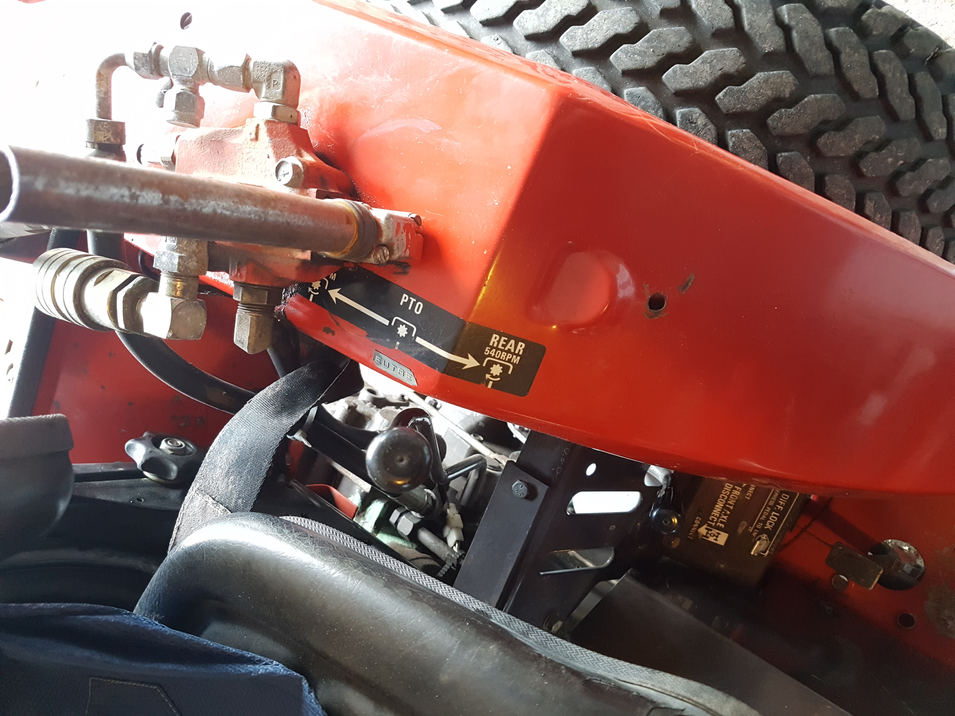

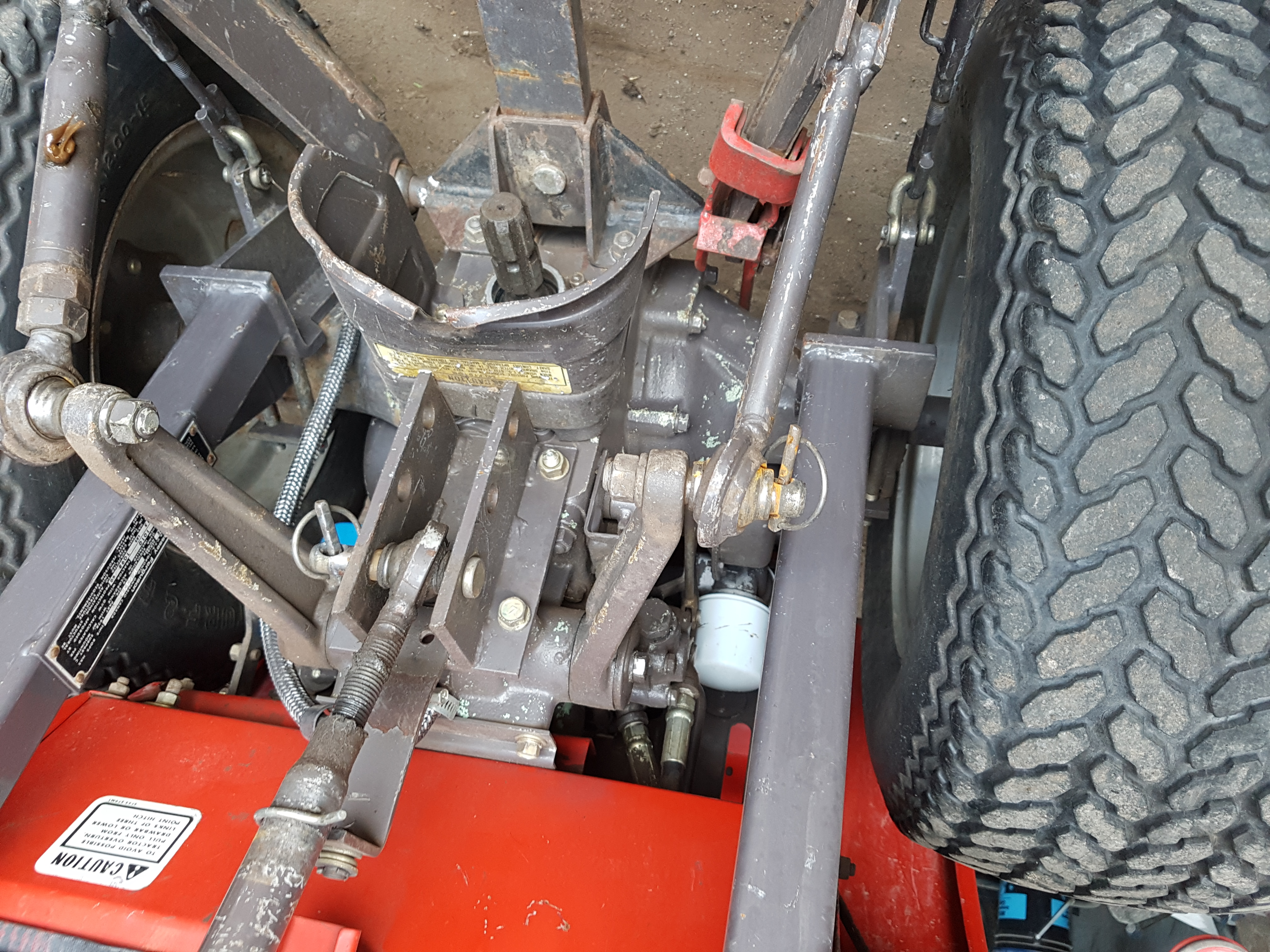

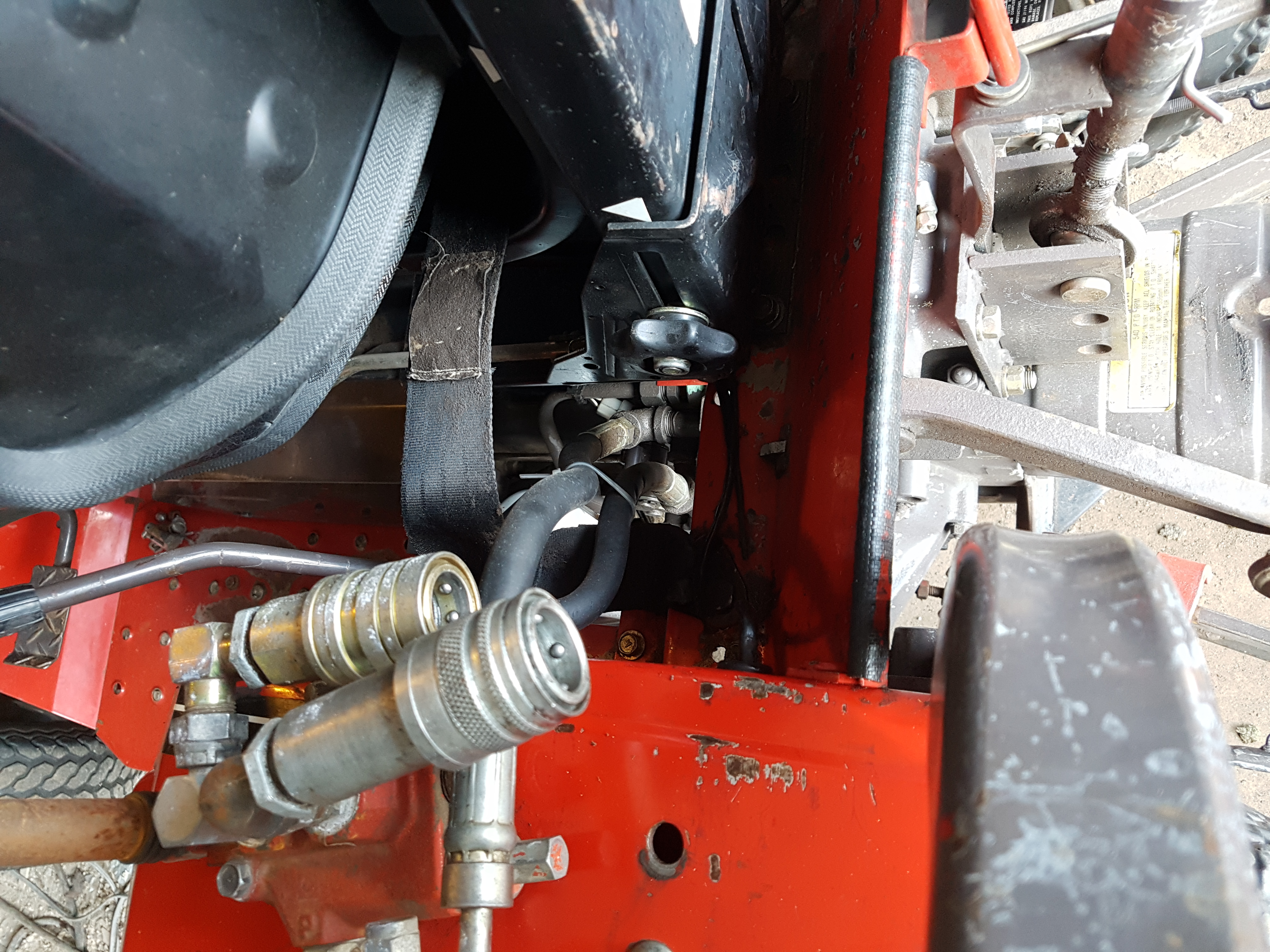

Hi,
I recently got an MF 1010H , in a good shape, want to change, my setup to have a quick connect rather than a valve, witch is leaking, any help will be appreciated, do i have to install bypass valve P to T between the quick connect outputs, because i allready have a valve on my splitter. Here are some picture if this may help. please help

I'm not sure what you are trying to do.
Are you wanting to remove the existing valve shown in the picture?
If so are you wanting to replace the valve with the quick connects you mentioned?
I am assuming the quick connects shown come off the existing valve.
Does the existing valve have a Pressure line, a return line, and a power beyond line?
If you replace an open center valve with quick connects, there would be no return path for flow and it
would dead head the supply from the pump unless you install a bypass and kept it open except when using your splitter
which would hopefully have an open center valve.

You'd also get more help if you posted in the regular Massey Ferguson forum. This forum is for old (like pre 1970) Masseys so lots of us don't know much about the newer machines.
   / Massey ferguson 1010 hydro quick connect plumbing
Thanks LouNY ; that's what i tought i will install a bypass valve
Best regards from Québec
