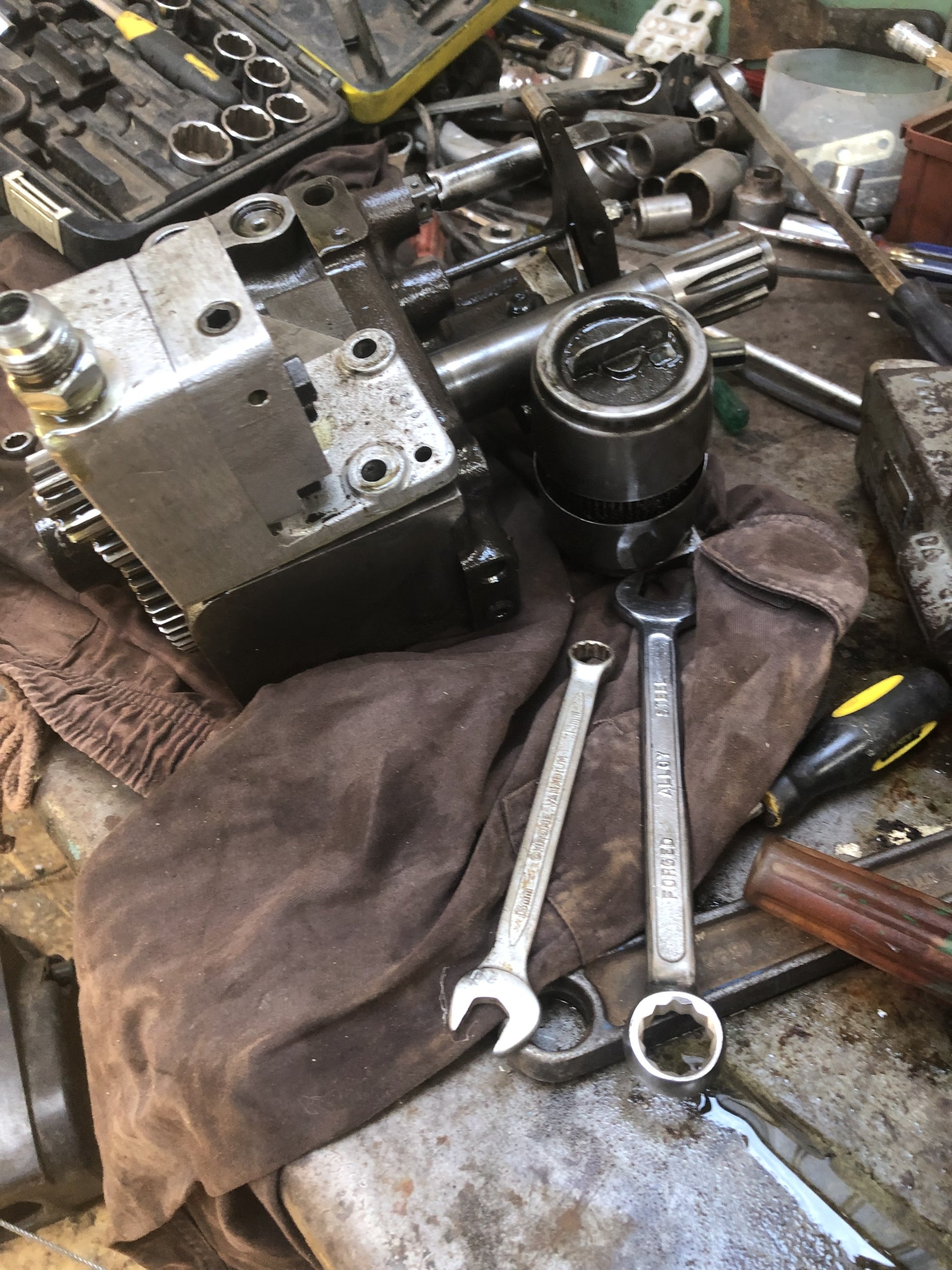

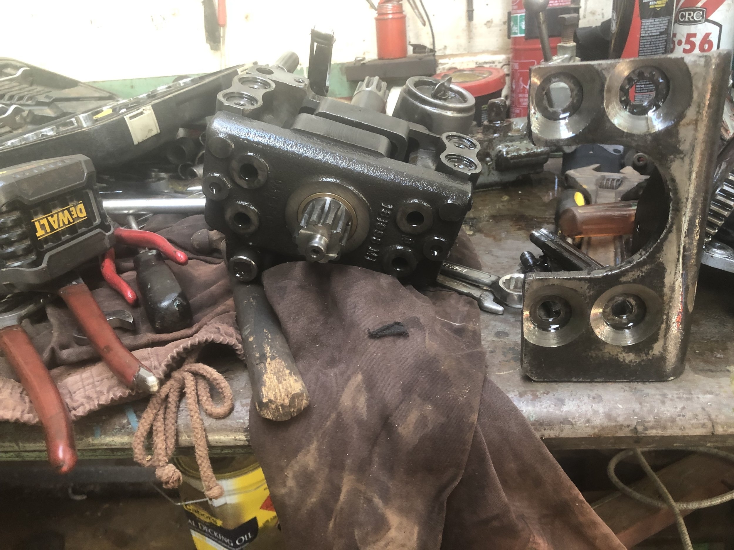

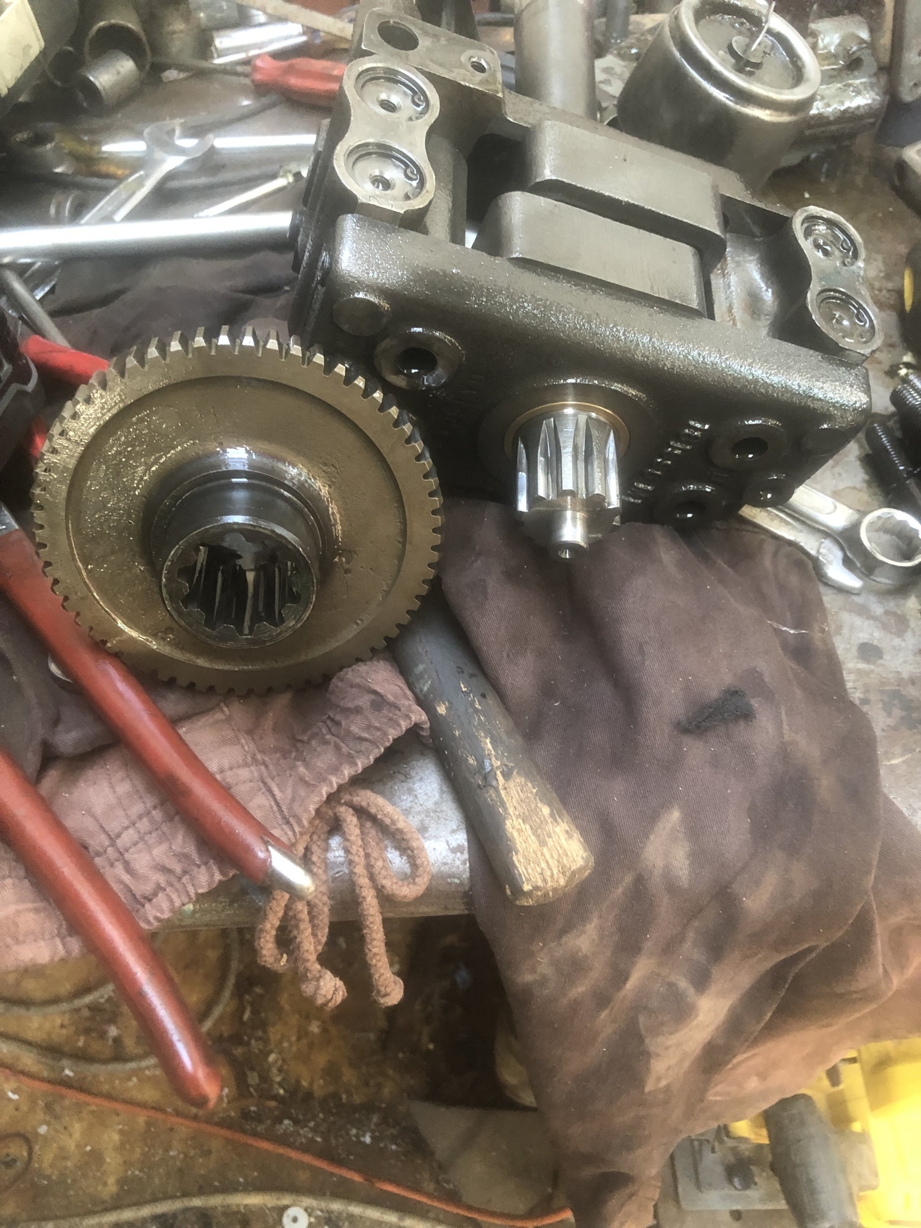

Hi i have a massey ferg 65 multipower and need a new hyd pump my question is does the 65 pump fit the multipower 65 there is a difference at the front and top which is bracket for aluminium block to sit on and a cog on front which i removed and looks like i could fit it on new pump parts people cant say it will fit it is a 10 spline shaft Cheers Ted

I have used the parts off old pump to new one. pumps are all the pretty
Much the same just different applications
Have swapped shafts end plates some have nuts with snap rings just make sure everything turns ok when putting back together

Hi Dman thanks for that looking at pump they look exactly the same just have to take 4 bolts out of new pump to fit bracket and take the socket off new pump and fit my wheel It was just that the parts people said they only had pump to fit massey ferg 65 Cheers Ted
