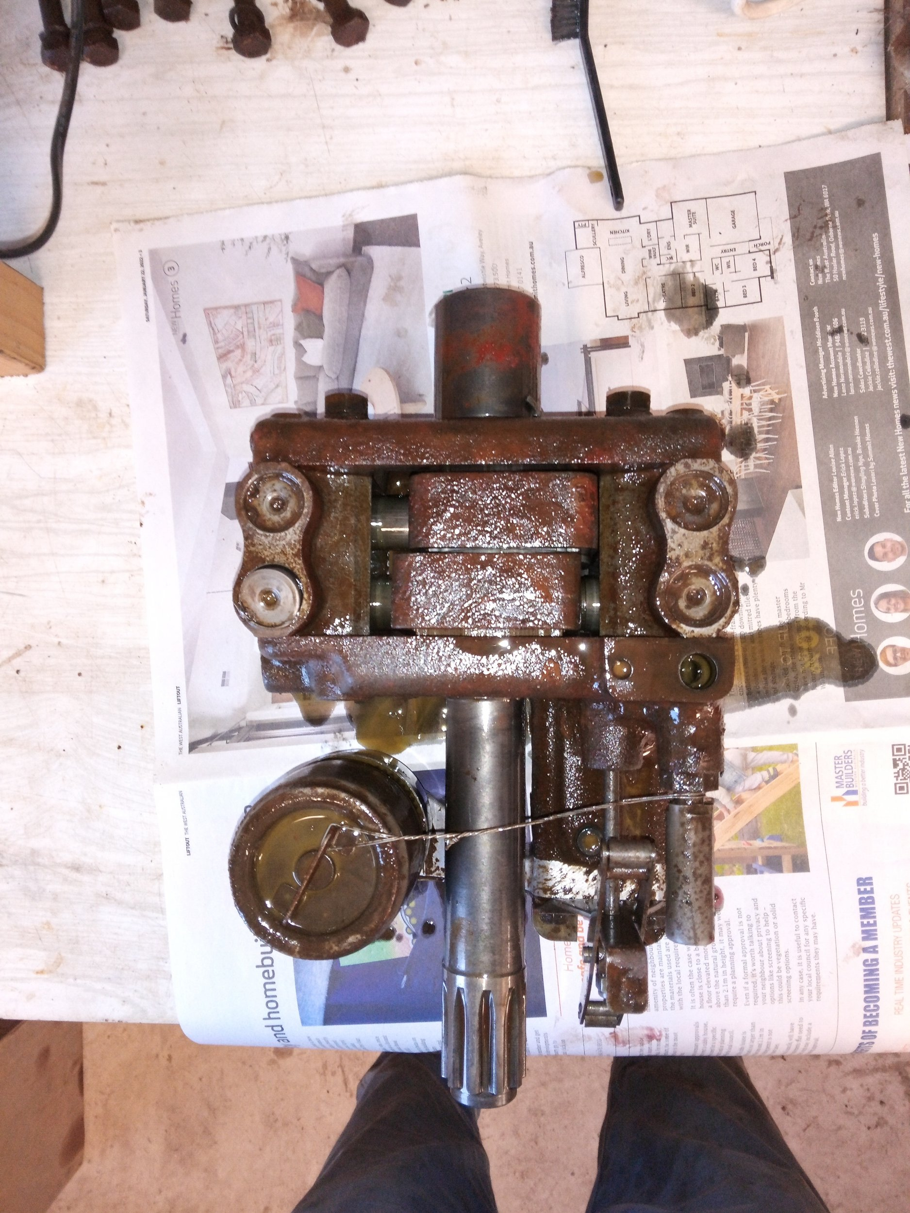

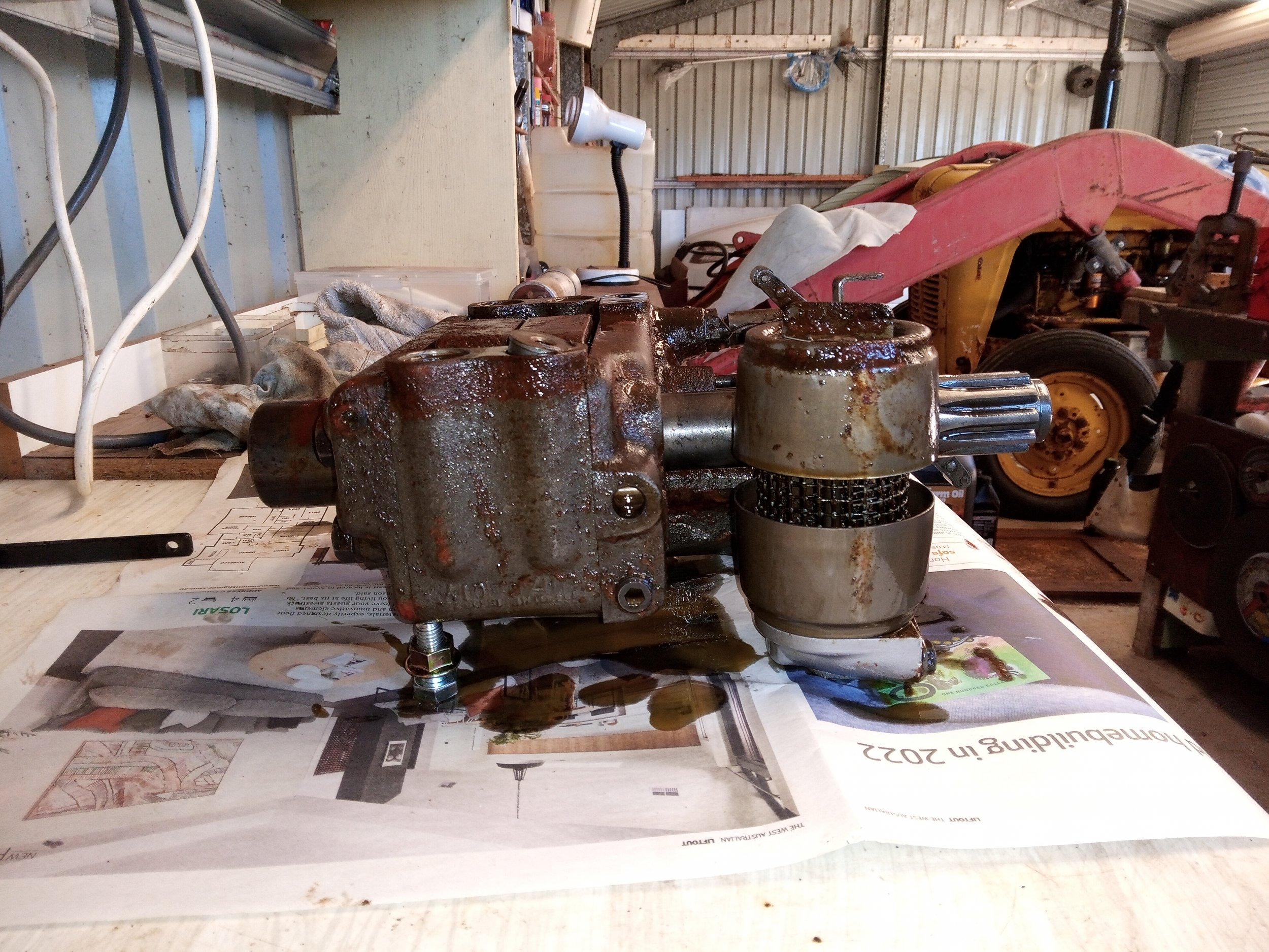

Hi,
Pump is removed from tractor and I found one valve assembly pushed out of the housing - see photo. There may be other issues with the pump as well, so I'm considering just replacing the pump with new from Inside via eBay.
Does anyone know how to tell it the pump in the photo is a Mark1 or Mark2? Does it matter if I swap Marks?
Anyone have experience with the pumps coming out of India?
