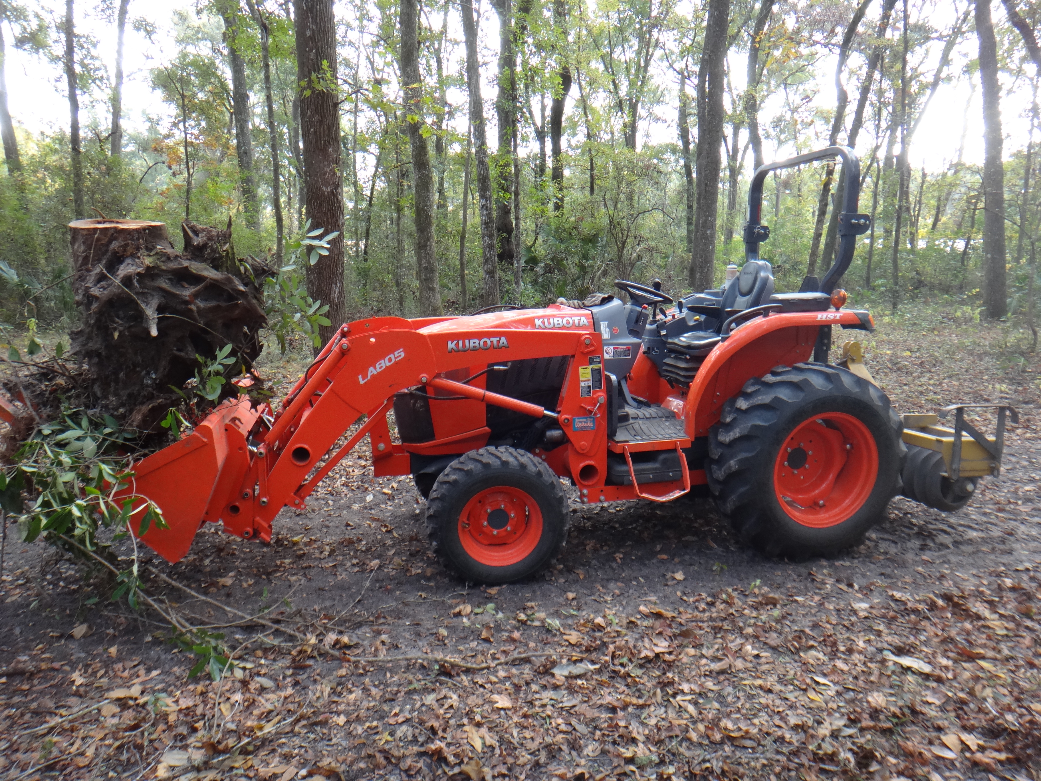

Tractor FEL (Front End Loader) lift capacity decreases rapidly with HEIGHT. Be sure the tractor model has the lift capacity you need, at the height you need, bearing in mind that all tractor capacities decline slowly with tractor age.
You will want to purchase optional SSQA (Skid Steer Quick Attach - an industry standard) FEL bucket and SSQA pallet forks.
You will need ample counterbalance to the FEL load mounted on tractor's rear Three Point Hitch. The most common counterbalance is a tractor implement, with Box Blades being perhaps the most common. I use a Cultipacker too. So the tractor will be fairly "long" when moving pallets on the FEL.
( Fork Lifts have rear engines, rear weight bias. Tractors have front engines, front weight bias which helps them pull through the rear Three Point Hitch.)
