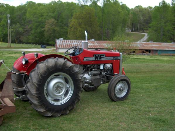

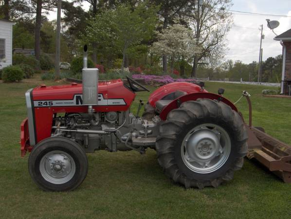

This one? If it as nice as it looks, you would have a good deal there. However, it is missing a few bolts on the rear wheels which is not consistent with the looks of the tractor. Little things bug the paranoid part of me unless I know the reason. If the service history shows well and if the engine has not been torn into, it could be a very good tractor.

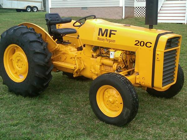

You also have this super cool Massey in your area on craigslist for $8k My, my you have nice choices.
that's the one.
   / massey 245 priced high?
see, i didn't even notice. appears to be 3 or 4 missing on one wheel. little things annoy me also, especially when a premium price is on it. missing bolts could be as simple as, 'i lost a few over the years and never replaced' or the more likely,' threads are jacked up and i can't get them back in'.
