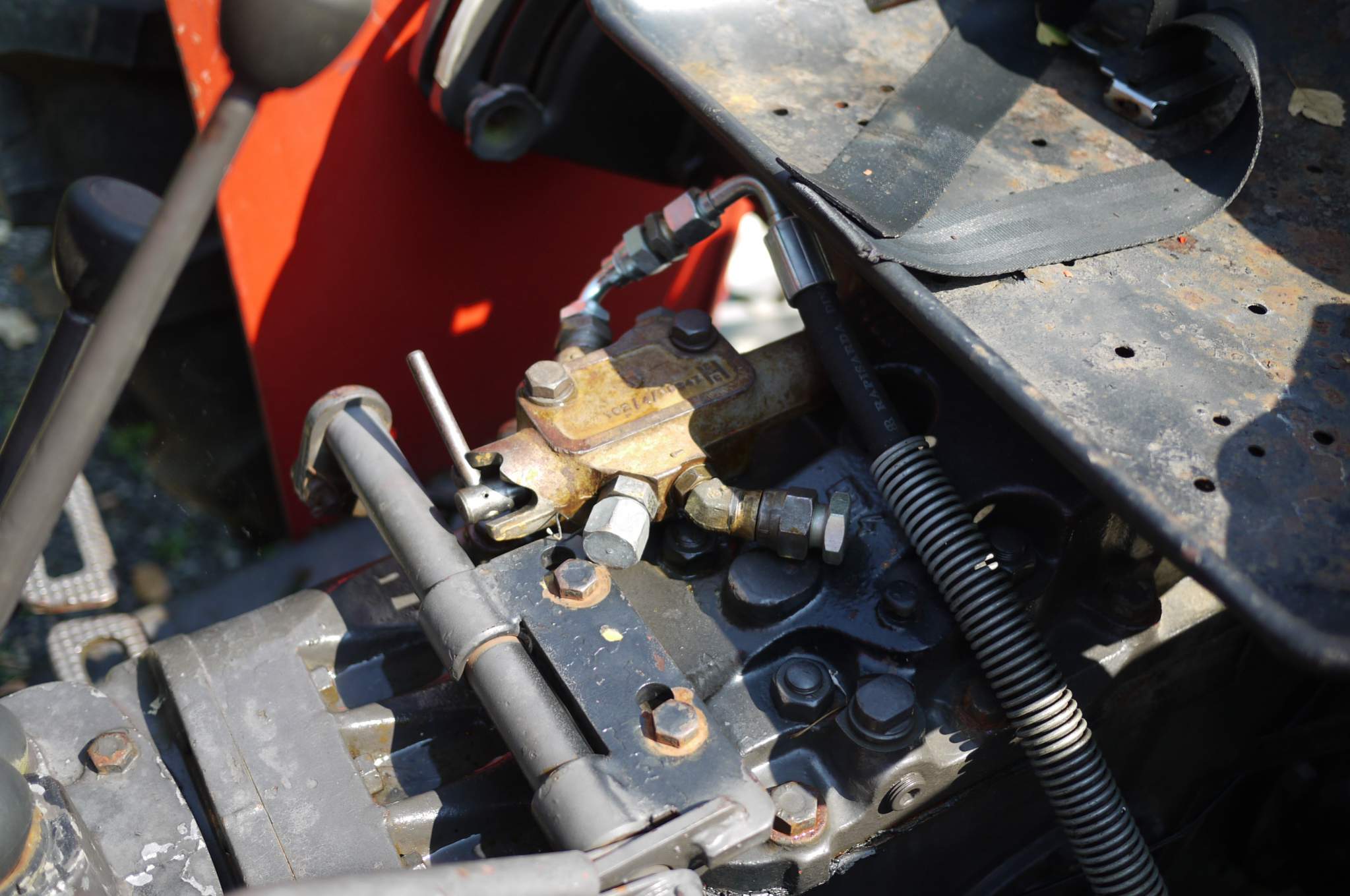

We purchased a Massey 240 with a FEL and wondered how to connect up a HUMUS AFLR 2500 mower. It is a special mower for orchards and has a swing out arm for mowing inbetween the trees. This requires a single effect spool and a pressure free return. The mower has a disc with cutter underneath, a sensor in front of the disc actions a hydraulic pistion to make the assembly swing back and forth.
John Deere 4520 mit Humus AFLR 2500 beim Solarpark Mähen Teil 2 - YouTube
There is a selection box under the seat. With the small lever in position to the right it selects the front end loader circuit with 3 (?) spool valves.
In the first photos the middle lever controls the up motion of the FEL and is single acting, downward motion is not controlled. The lever on the right controls the articulated forks and is a double acting valve. The lever on the left I am not sure what it does...one cable runs back to the selection box under the seat and the other cable runs back to a point underneath the steering wheel.
When I select the middle position on the box under the seat I can control the 3pt via the standard levers to the right of the seat. Is it possible to connect the mower so I can have both control of the swinging arm and also be able to raise and lower the 3pt to reverse the tractor quickly? The mower has two male connectors and 3/8 cable.
I am wondering how to connect the mower really. The nearest tractor dealer is a long way from myself!
Regards and many thanks in advance,
Rich

If the spools on the valve are DA spools, then they have plugged one of the work ports for the SA cyl.
If that is true, then you should be able to replace the SA cyl with a DA cyl and use the DA spool for pressure up/down.
If it is a stacked valve, and using an SA spool and you know the manufacturer, then you can replace the SA spool with a DA spool.

I attached a few more photos of the Kontak spool block. In fact, I was mistaken!
There are 3 double spools and another block on the end (closest to the camera) which must act as a feed and return. I guess it allows the fluid to flow through the system when the levers are all in neutral position.
The first double spool block is not used.
The second is a double but only acts as a single to control the FEL lifting.
The third is double acting and controls the forks.
Is it possible to add a T joint to the spool block input hose and let that feed the mower? I could then connect a return to the block under the seat?

No, you don't want a tee in the series circuit.
All returns can be teed together as long as it does not add to much back pressure.
What is feeding the mower now?
If you want power up and down on the second spool, then you will need a DA cyl and use both work ports on that spool.
It also looks like you have work port reliefs on the work ports.
If the mower is hyd driven, you can feed that hyd motor using the unused spool valve.
Just add a double relief across the hyd motor, or add a motor spool.

I can't see the other end of the valve, it may have a PB port in case you wanted another valve.
You really don't need another valve to control the mower as you have an unused spool that is plugged on the valve.
In an open center hyd circuit, all valve are in series, and to add valves, you need a PB port on the supply valve, and a PB port on the added valve if it is not the last valve in the series path.
You can insert a hyd gage in the cyl lines and read the pressure, and if you need a lower pressure than the main valve, you would set the work port relief for the pressure you want. What the work port reliefs are for, is that if the load on the cyl is excessive, the valve relief could not handle the spike of hyd power generated by the load.
You also have a hyd valve under the seat with capped ports.

5 bar is only 72.5 psi. The pressure should be between 1500 to 3000 psi, or 103 bar to 206 bar
Run the hyd motor out return hose to tank unless you want to reverse it for some reason.
To use the hyd motor as a reversing motor, connect the hyd motor to the A/B ports on the spool, but also install a relief valve across the motor.
You should install a double relief valve across that motor in case the lever ever springs back and the motor is spinning fast with lots of centrifugal force/ weight.
Bungee the lever or find a detent kit for your valve spool.
Is the valve a stacked valve? If so, you can replace or add to the stack with a motor spool valve, which let the motor wind down safely.
