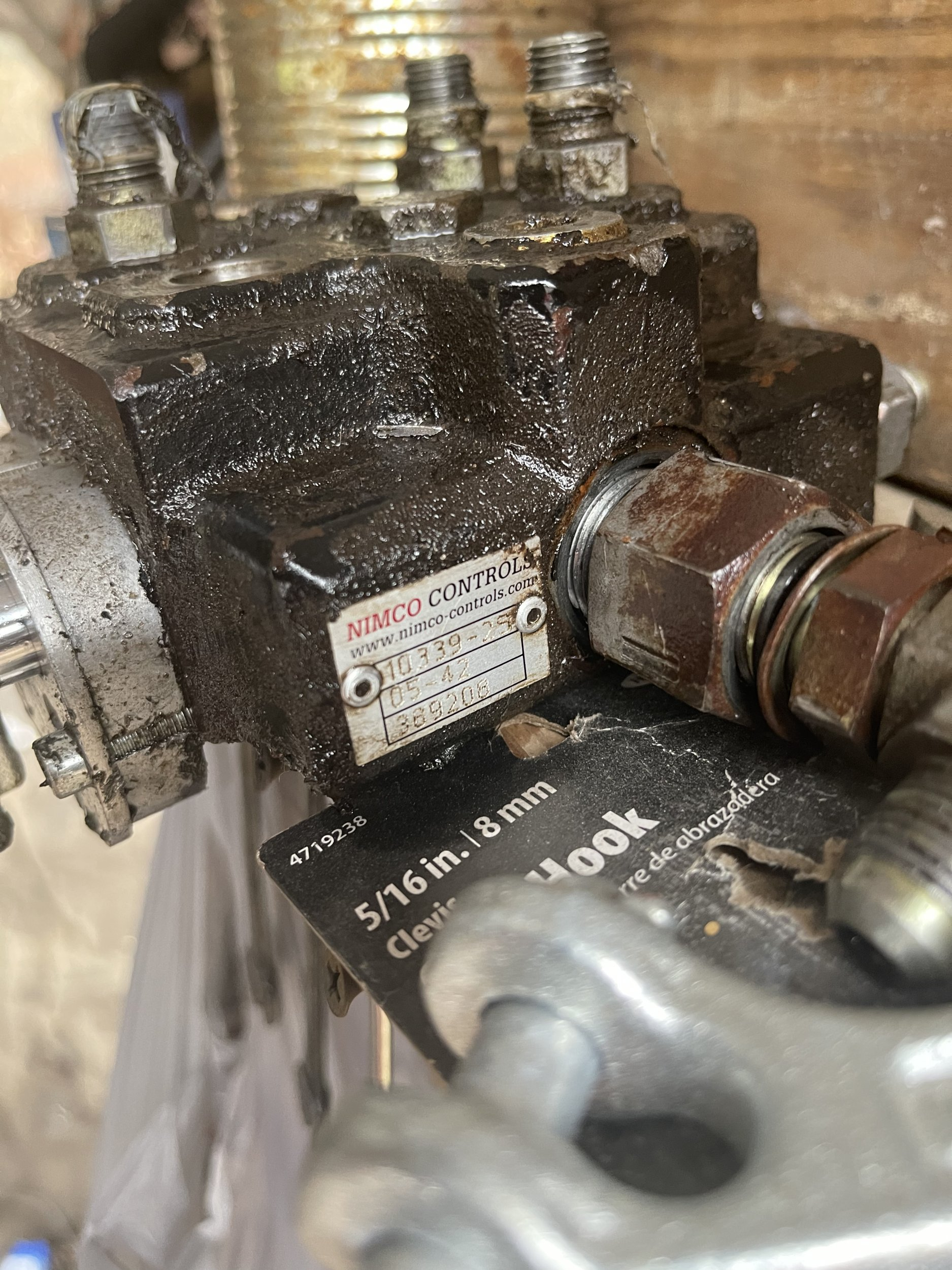

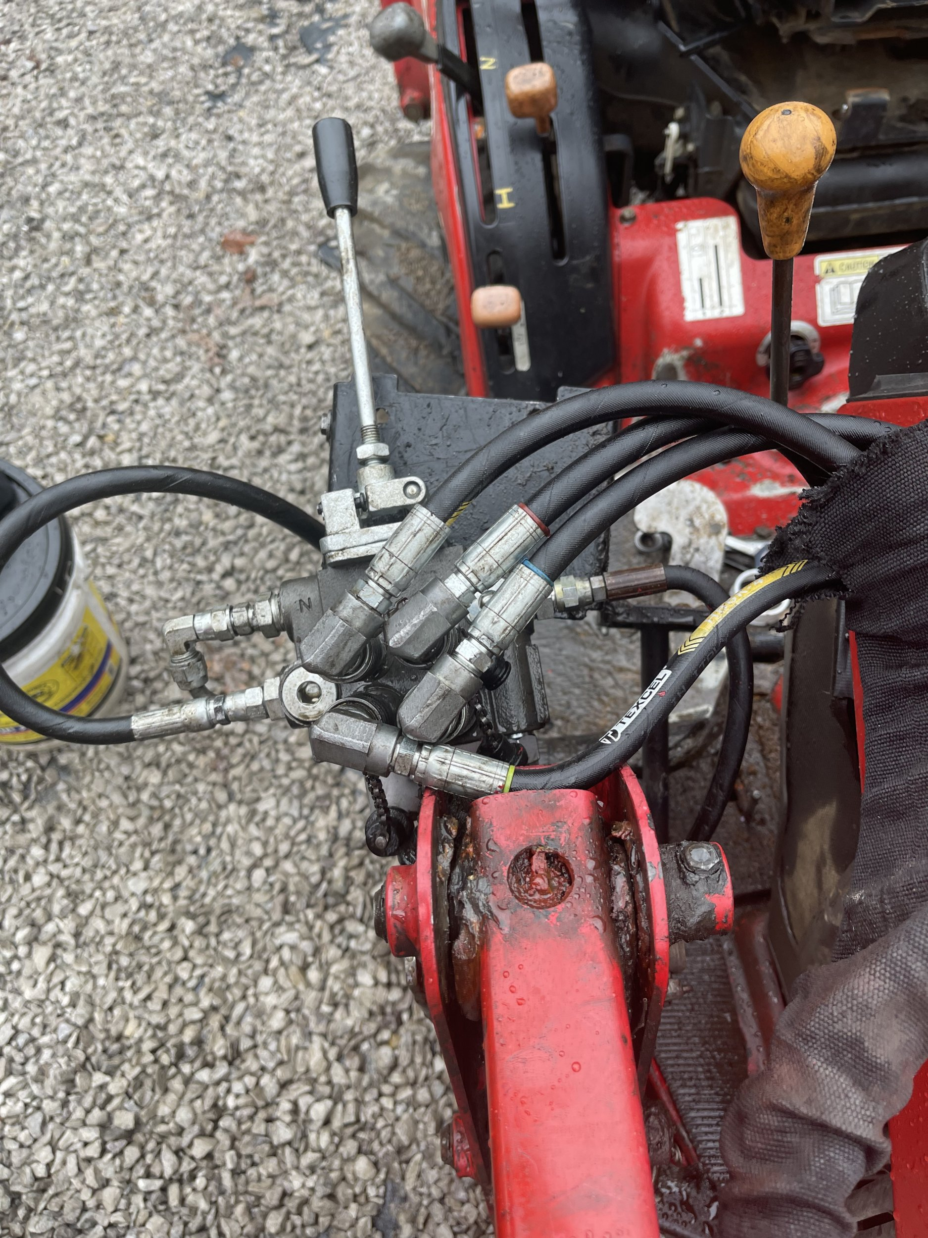

I installed a loader valve and my backhoe attachment barley moves loader works perfect

Did you used the right Power Beyond sleeve for the new valve? From the pictures, it doesn't look to be the right fitting and it doesn't even thread all the way in.

The last picture is the old valve, I bought a regular 1/2 to 3/8 fitting and connected it, is there a special sleeve and what port is power beyond? Also what hose coming from my backhoe should be connected to the power beyond

I was speaking about first valve. Yes, there is a special fitting/sleeve for the power beyond port that will there feed the backhoe. The other line, just besides the power beyond line, will go to the tank/transmission housing. The other line comes from the Pump and goes on the P port of the new valve.
The valve is labeled with P, T and N. P is Pressure in (from pump), T is Tank and N is the power beyond.
The power beyond sleeve looks like this. It's also specific to that brand of valve, so you may need to see if the seller has the proper sleeve available.
