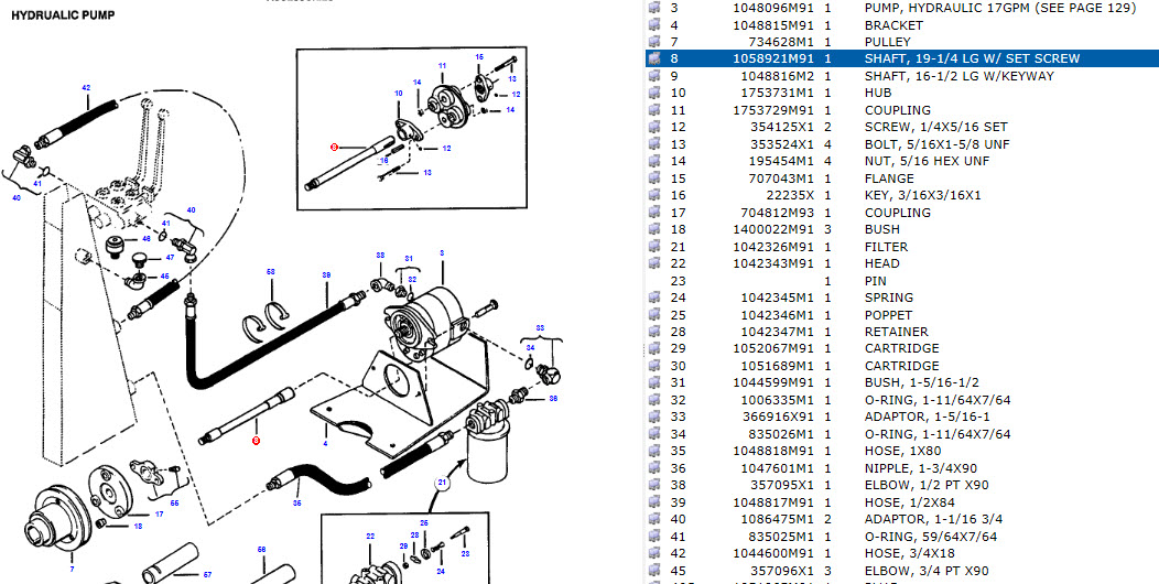

Hi all, I am having trouble finding out how to remove the front pto shaft that runs the hydraulic pump for the loader. Any information appreciated.
I was moving a large log (pushing it up onto the pile) yesterday when the loader stopped working, I thought I sheared a key but nope, broke the shaft! I have the pump off, the spline adapter that goes on the pump with about 4" of shaft. the remainder is still in the tractor. I' been told there may possibly be two ways it comes out, either a left hand thread or splined. Of course the tractor is still up in the woods at a friends. I am hoping to have a better understanding of what I'm up against to get the remainder out. Tractor Joe has this one ( HM1868533 - Front PTO Shaft for Massey Ferguson | TractorJoe.com ) listed but I'm not sure if it's that simple or not.

Edit: nevermind, I guess it's not like mine. Yours looks like it has splines on both ends? What loader is on this machine, you may be able to look up the specific loader in the agco parts book.
Is there any bit of the shaft sticking out? If yes, maybe try to cut the shaft off square, weld a nut on it, and use a slide hammer and some heat if splined, or a bit of heat and use a socket on a welded on nut?
Sorry, was on my phone before and it cut out on the app. updated my post.
Edit again: according to tractordata.com, your machine should have come with the MF236 loader. There is an extra small adapter on yours that looks have a set screw (#66), which makes me think maybe yours is splined.

shaeff, thank you. It has a cobbed on allied loader. It's pretty hacked. There is no shaft sticking out in fact it's back in the casting about an inch. I'm trying to figure out how to get the pulley off or at least out of the way if that's what I need to do.

IF the shaft is just splined in there how do you think it will work if I drill in the end of it and run a tap in and try to pull it with the tap? Maybe some heat and some grease.
   / Massey 230 front pto shaft removal? #5
You're very welcome. If you can center a drill bit in it well enough, I'd see if you can tap it out enough to get a piece of threaded rod in there, then see if you can get a slide hammer on that. If yours has the set screw in that extra little piece that attaches to the pulley adapter, make sure you back that screw out first.
That grease fitting is likely for the axle pivot, not the pump shaft. They're often neglected. I take them out and pump grease through them to get them working again, or just replace them. Mine has a fitting on the front and rear of the pivot, so yours might also. If you click the picture or press CTRL and left click, it should enlarge. The website is AGCO Parts Books and if Allied is an AGCO subsidiary, you should be able to search the parts book for it.

I'm hoping you can make some sense of this picture. It doesn't appear to me that there is a set screw or other piece on there. That is the website the local dealer gave me, thanks again.
   / Massey 230 front pto shaft removal? #7
Yep, I can see it clearly enough. (I JUST went through this on my machine!)
That grease zerk is definitely for the axle pivot. As far as I can tell, you're correct about that other small adapter which means that the pump shaft is likely left hand thread to come out of the crank pulley adapter.
Do you have a picture of it from the front? Yours, like mine, leaves very little space to work in near the crank pulley.
Another thought if you can't get to the end of the broken shaft- if you can wedge it firmly enough that it won't rotate, you could unbolt the (3 or 4?) bolt adapter hub on the crank pulley, heat it a bit around the shaft, and put a strap wrench on it to try to loosen the adapter from the shaft. If successful, you could then fish the shaft out easily with a magnet or poke it out from the inside.
