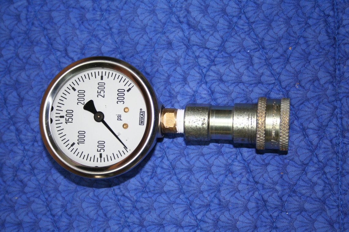

You can make a hyd test gage set like this and either install it permanently, or put a QD on the hose end for testing. Just plug it into a QD for pressure test.
If your BH is using two hoses with QD at the back, if not using the BH, you would jumper the two hoses with a short hose. If the 3pt now works, that means that no flow was flowing from the BH. The return hose will have flow, because the relief is allowing fluid to flow. If you hear a constant hiss or screech, that is not good. That sound is a warning that the valve is relieving fluid.
