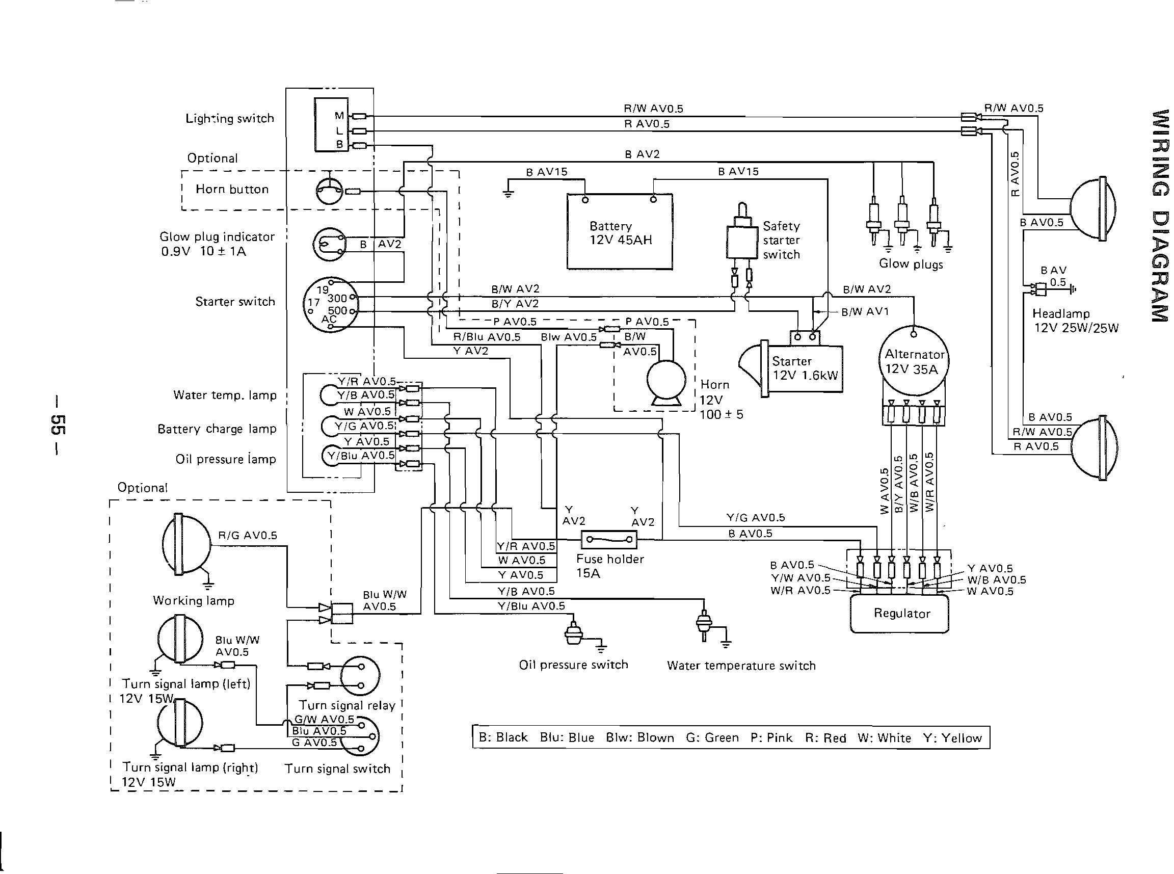

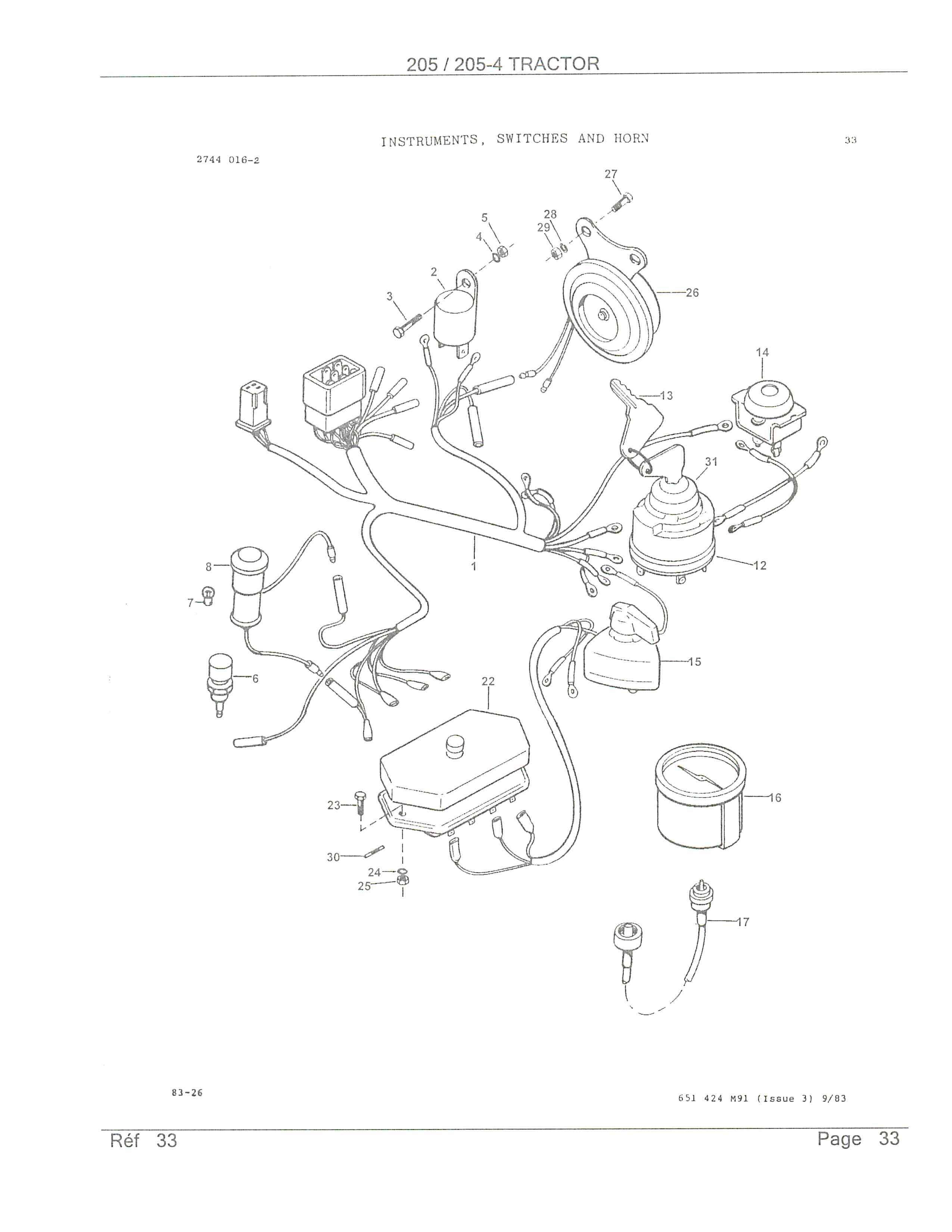

Hi everyone,
My tractor won't start anymore. No clic, no sound, nothing. I know that my battery is ok, i checked. So probably just a bad contact between the ignition and the starter. A see a bunch of wires, cracked, melted, wrapped, etc... The wiring is this tractor has been modified or repaired a lot before I bought the tractor. It is a mess to follow and understand the circuit. I checked everywhere on the net for a wiring diagram but the only thing I found is the wiring in the parts manual that show only the parts and the wires but not the circuit and how it is connected, it is not a circuit diagram but a part diagram:
So I'm looking for a real circuit diagram like this one (this one is for my old Satoh Beaver tractor):
Circuit  Wiring Diagram.jpg.
Does someone have something like this for a massey ferguson 205-4 ?
Thanks a lot!
Phil
   / Massey 205-4 compact diesel 4x4 wiring circuit #2
I'd check the lockout switch on the clutch pedal first.
