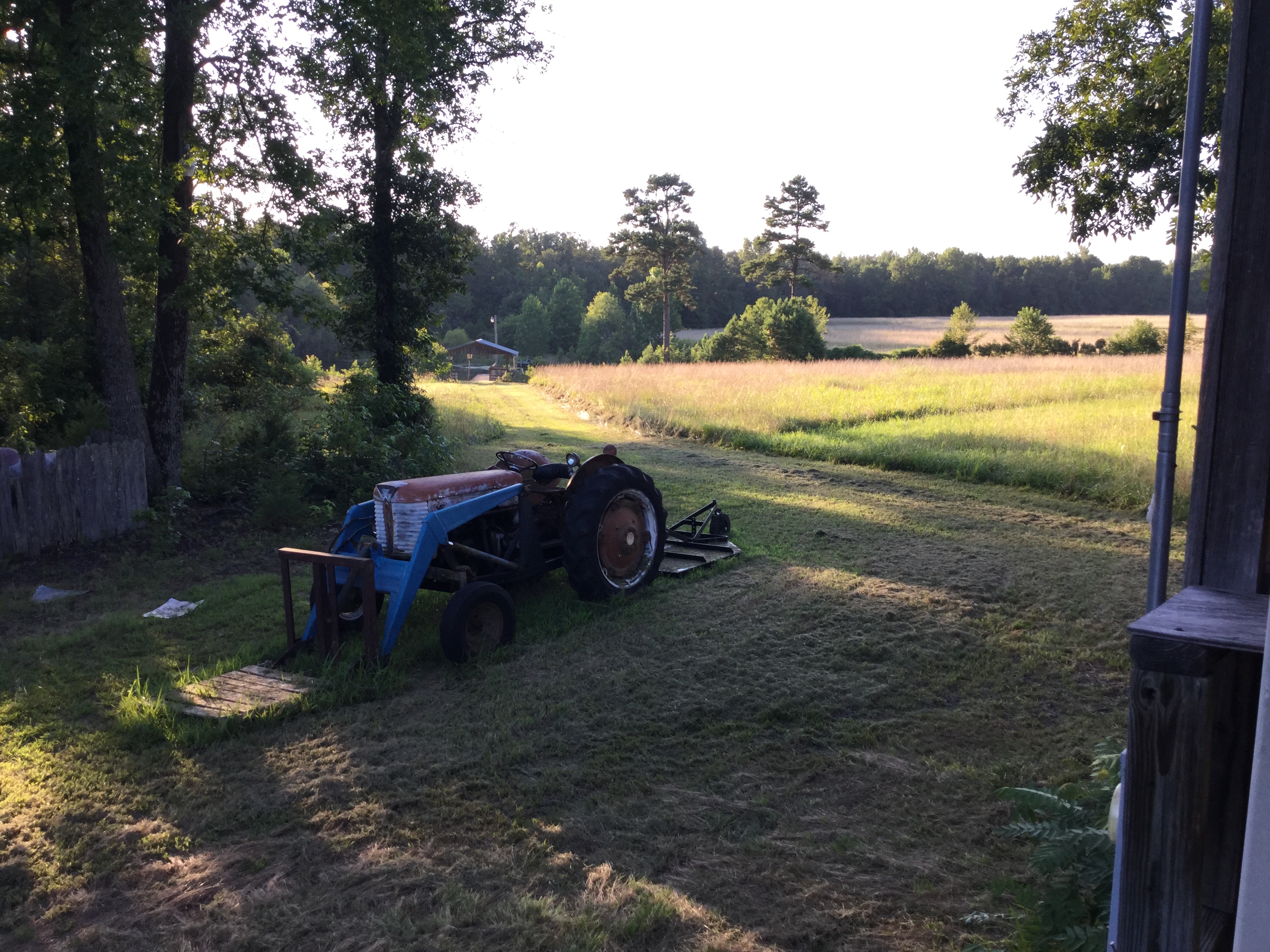

I also have taken over a 125 acre family property in central Arkansas with trees, about 50-60 acres cleared with weedy hay growing, a 1.5 acre pond to maintain and about 1500 gravel road. There is a 1960ish Massey 65 there with a 6 Shredder there that I have been learning how to use (run one of these out of gas and you will quickly learn all the parts of the motor).

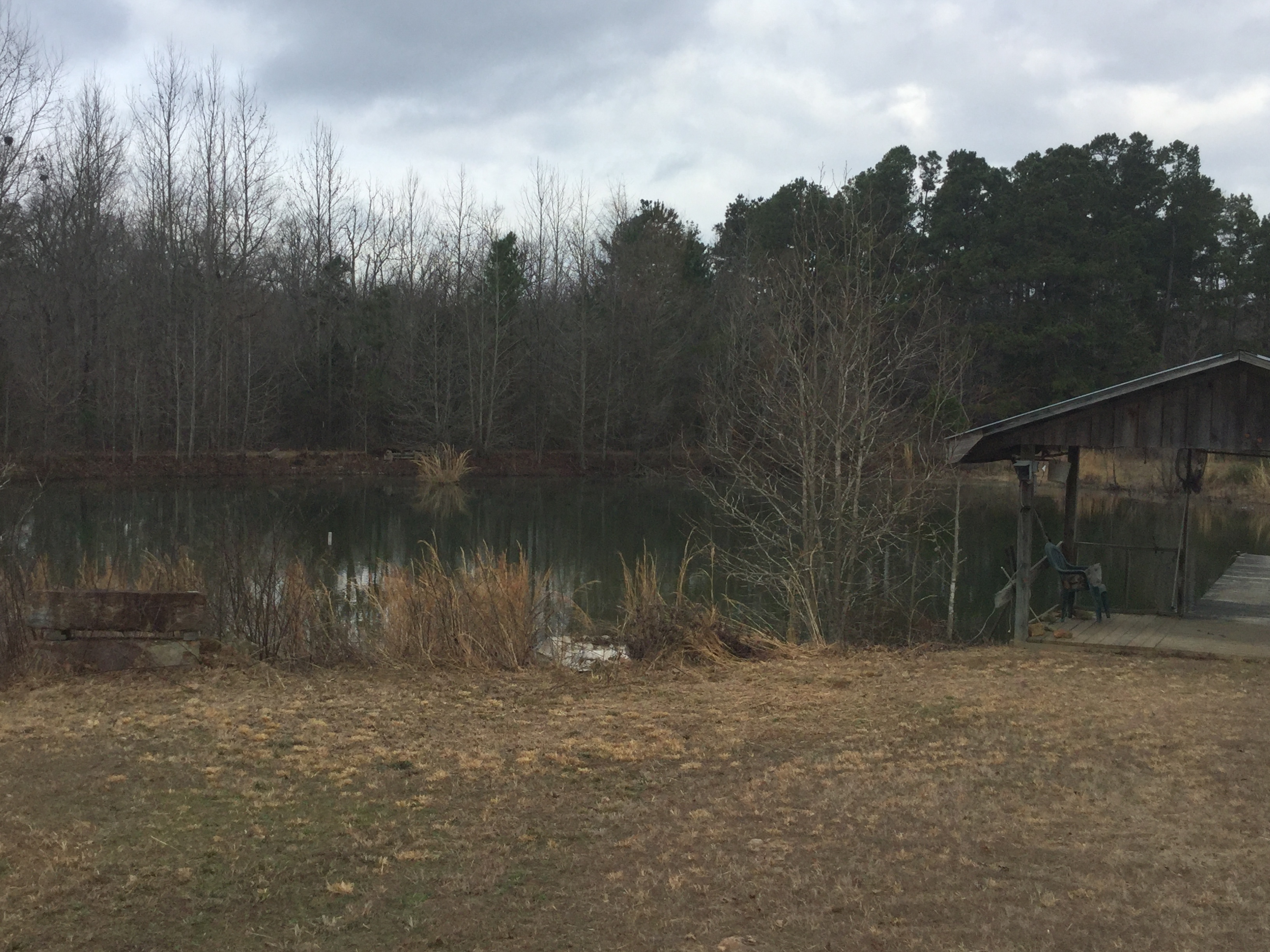

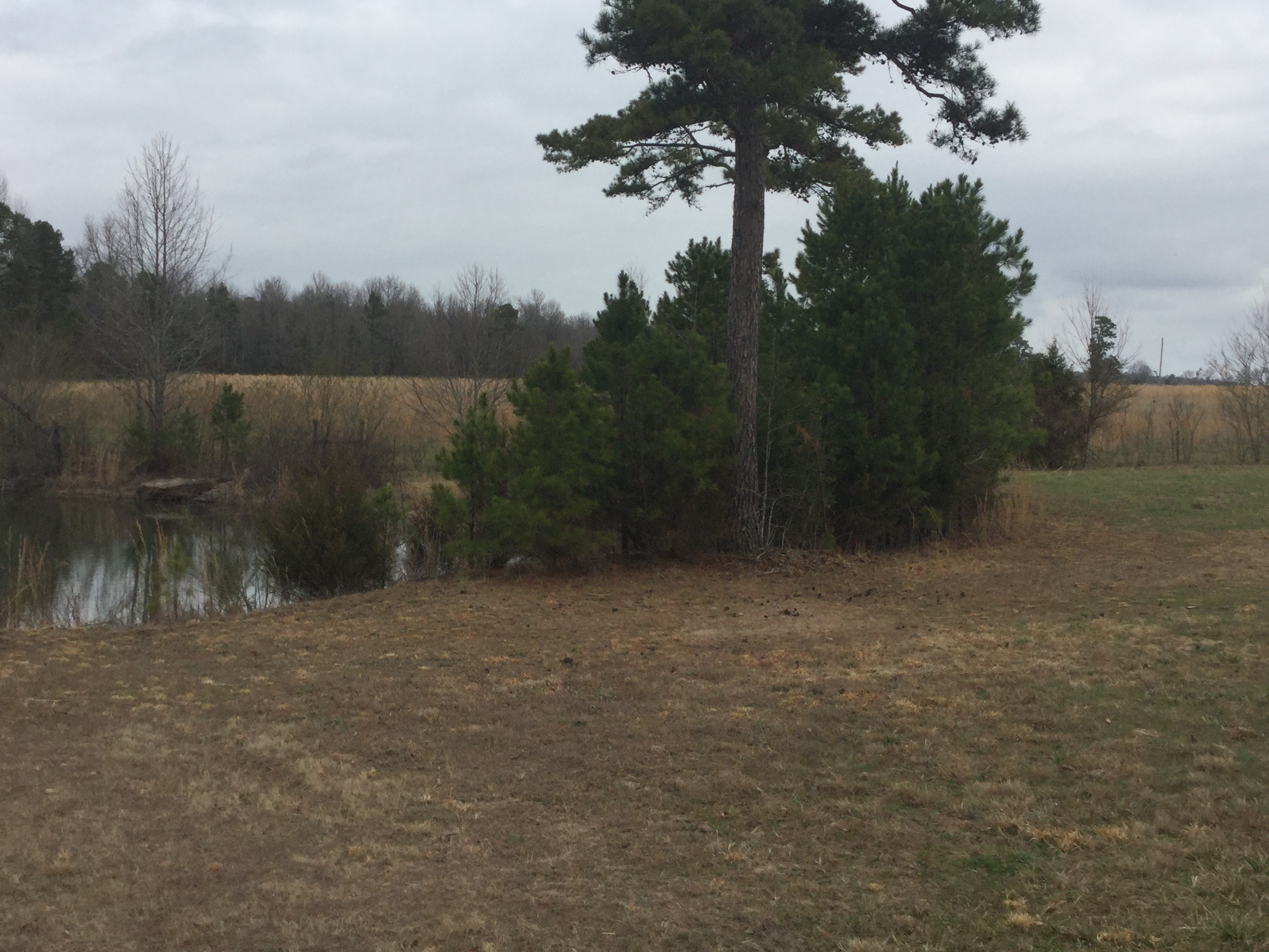

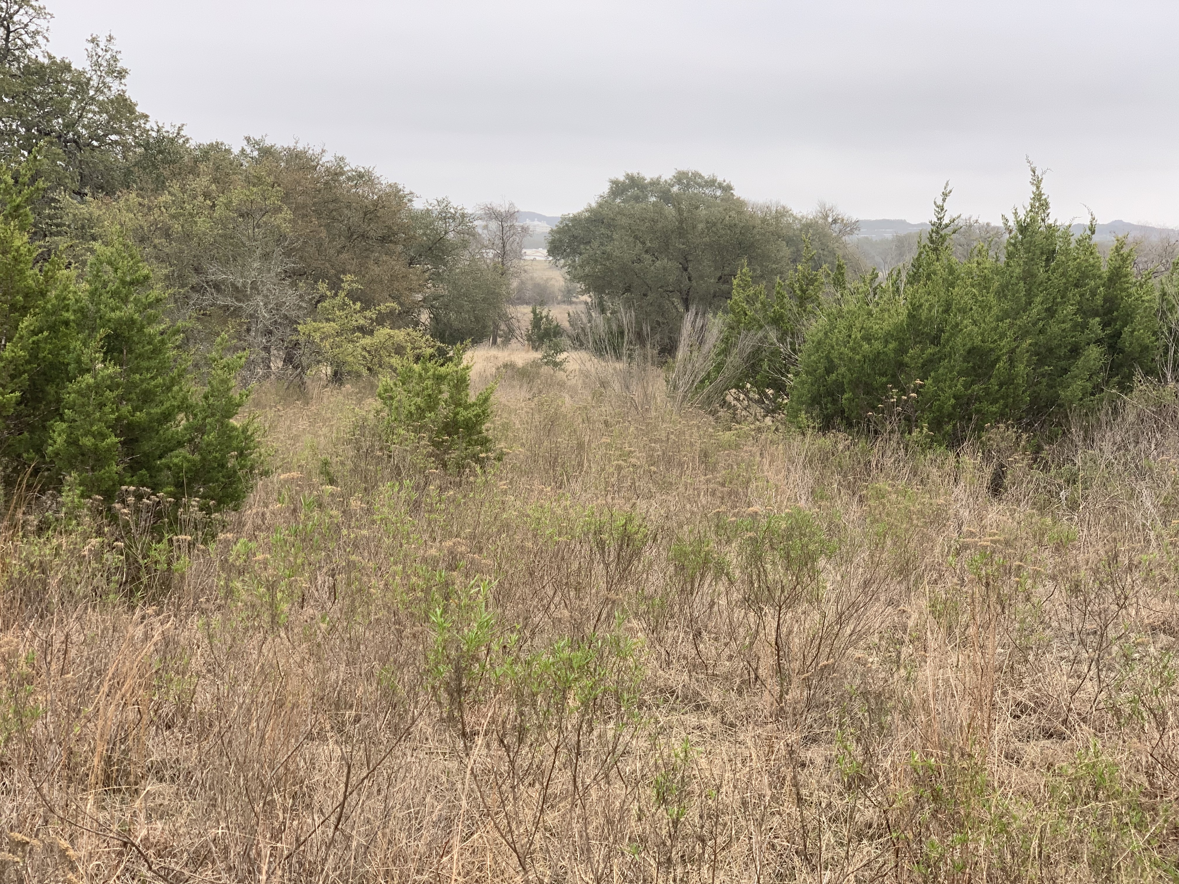

Here is some pictures of the pond at the farm I have to clear everything except the two tall pines. All those trees suck out the water and can compromise the dam. The trail is the dam and both sides must go. I will cut down the bigger ones and pull the out with the tractor. I was hoping I could shred most of this.

   / Massey 1760M or 4707 or ? = Stuck newbie

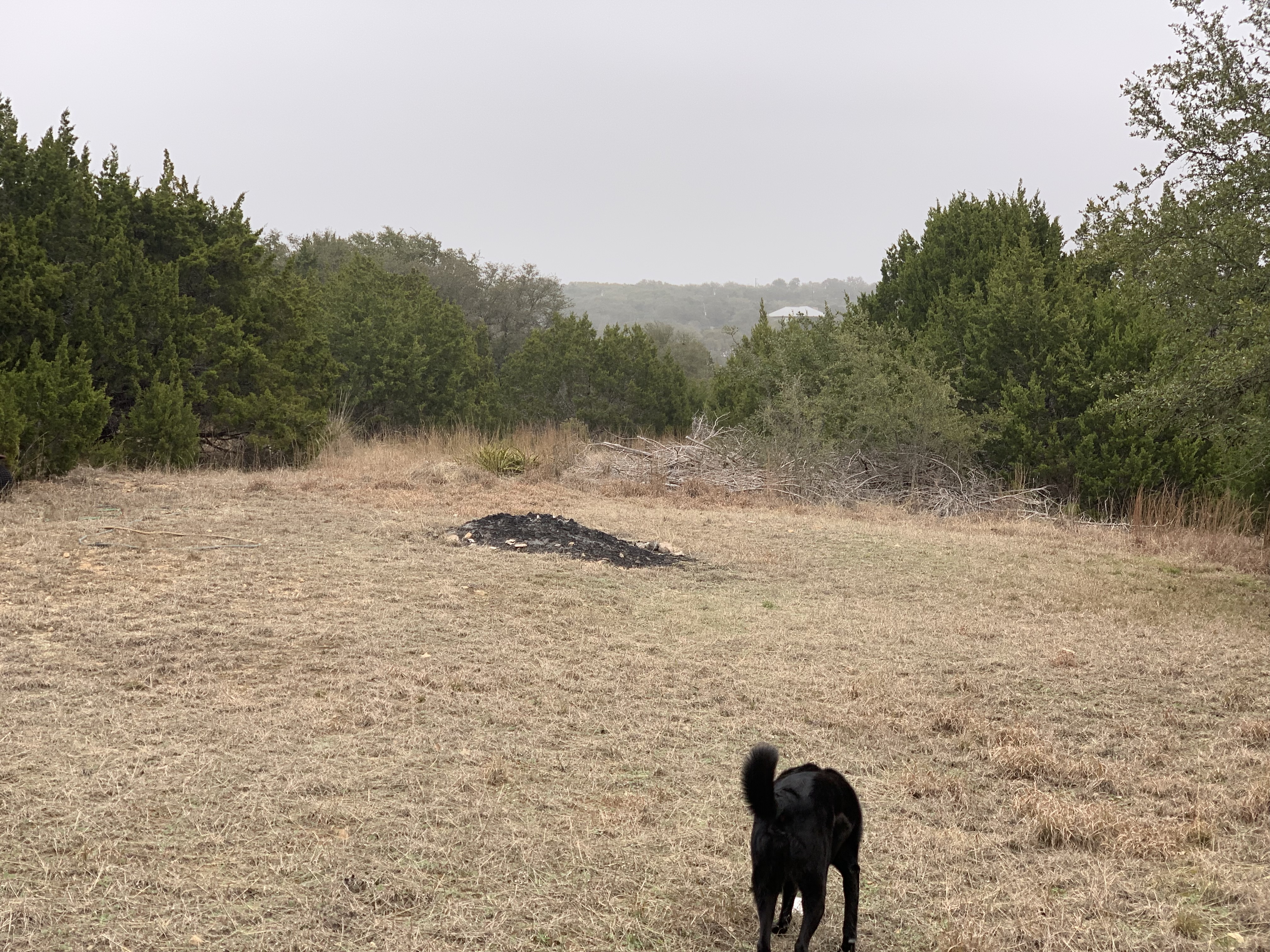

This is the Texas property. Most of this needs to go. I keep some cedars that have straight trunks and are not near oaks to have some green after I limb them up.
You may very well be able to pull some of these right out of the ground. Tractors are great at pulling. You will need a drawbar and an awesome chain. Just dont pull in a situation where a tree could fall on you (ie get a chain longer than the tree is tall). The shorter cedars seem fine. Other options are tree pullers (some have hydraulic jaws) that you can grab the base and rip it up. For the cedars that might work well. For tall trees it is a bad idea as one could come loose and fall toward you.
