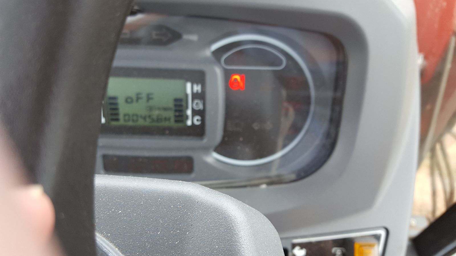

Resized952017092495145332.jpgI have a 2017 Massey 1758 Hydro with 46 hrs. on it. The oil is totally broken down. The only use the tractor gets is cutting with an 8' brush hog. The grass is never taller than 10". I cut 6' at a time and leave 1' on each side overlap. The radiator screen is clean and all fluids are checked each time it is used. I cut 2.5 acres one week and 6 acres the next week. It takes about 15 min. to 20 min. for it to overheat and I can turn the heater to hot and in 3 to 5 min. it is cooled back down. Then it will go about 2000 ft. and overheat.
I cut in snail speed and it does not matter what my mph is. It does the same thing.
Is there an issue with these tractors. In Texas, it does get hot. Is the radiator too small, or is there insufficient trans cooling?
I welcome your comments.

Is the radiator full? Is there air in the system? Did your fan belt come off? Is your water pump turning? If the screen to the radiator is clear, and the fan is spinning then airflow isn't a problem, but if there is air in the system or the water pump is not pumping, then heat extraction is the problem.

The answer is no to your questions and radiator is full. Brand new tractor. It is at the dealership now. They are bringing factory in. Will let you know.

My guess would be a thermostat stuck shut. Good luck with it.

I think they are changing it. Will let you know when I get it back.

It is at the dealer. Has been there 2 weeks. No answers. Factory rep called in. No answers yet.

My 1758 recently started to heat up while brush hogging dry weeds. I cleaned the radiator screen and temps quickly went down.
I had the same thing happen on my MF GC1710 a while back. I've added the screen check as part of the pre-operational check.
   / Massey 1758 Hyro Transmission Oil Issues
Screens are perfectly clean. Checked every time. Dealer said it was not an air flow issue.
