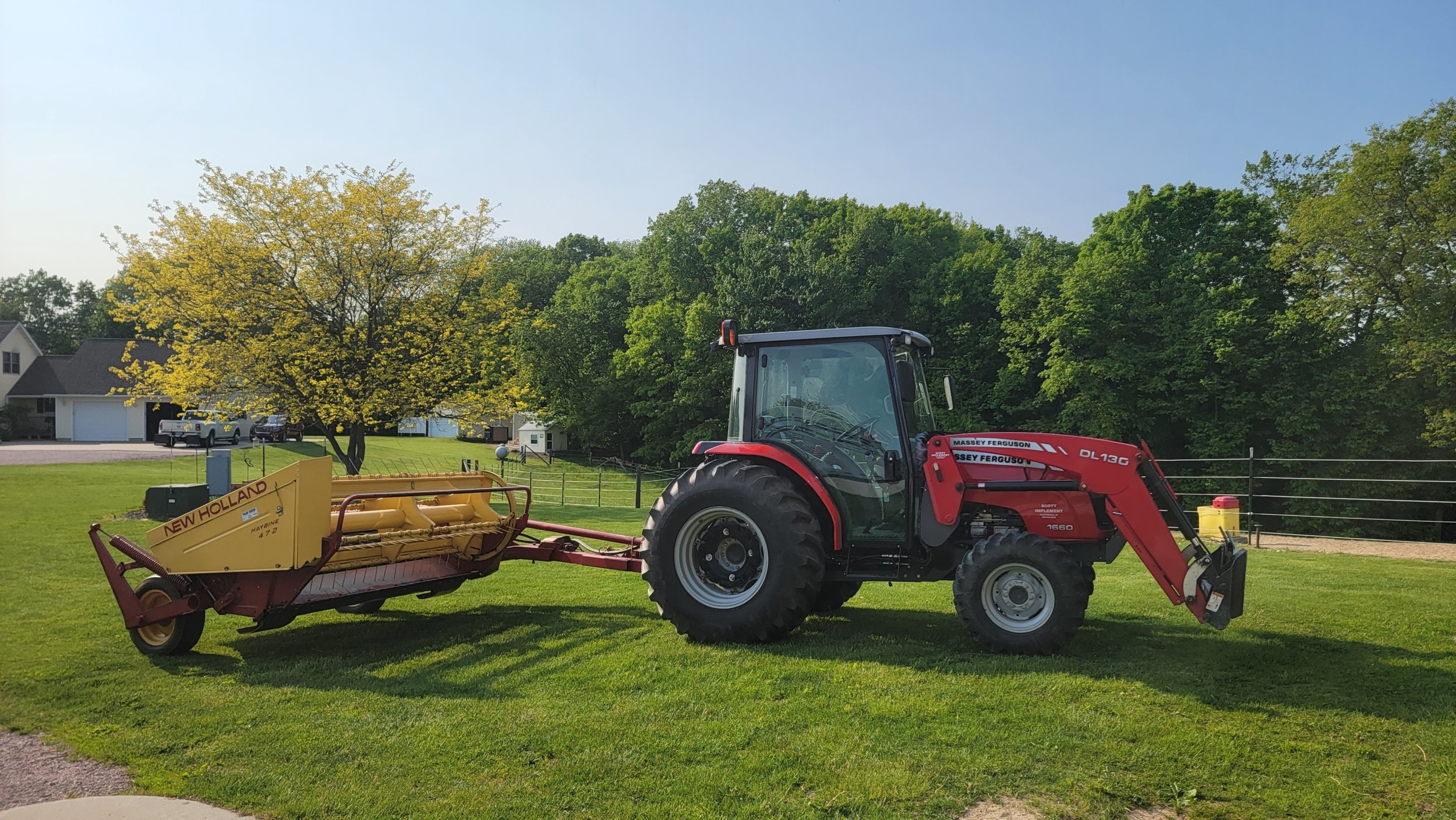

Shawnb2,
My 1660 is doing exactly what your 1652 was doing. What's the part number to the controller that they replaced and did it work and stay working? Ie fix the problem long term?
