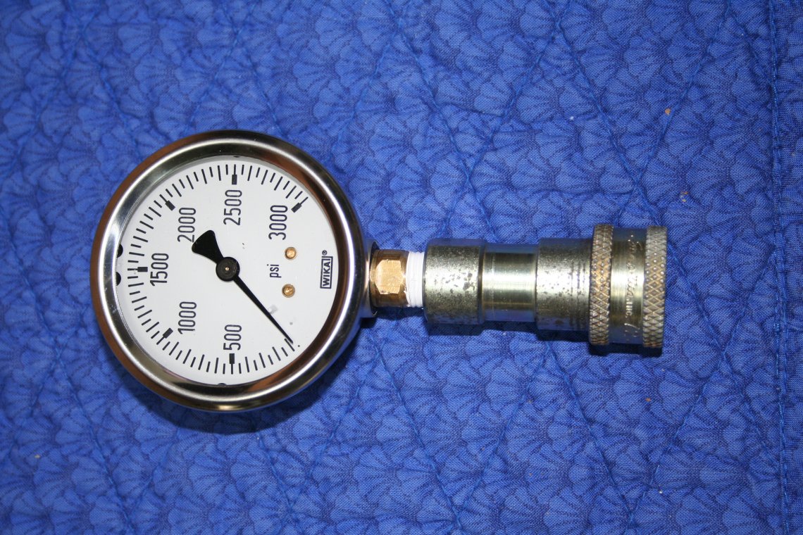

First, you have to know the FEL relief pressure, and then check it, and if low, adjust it to specs.
You should be able to lift the front end of the ground with the bucket flat on the ground and tilting the bucket down, and not use regen to do it.
Install a hyd gage like this and test your system.

/ Massey 1533 #6
I have a Kubota and a PowerTrac.
Each FEL valve has a relief, that you adjust by turning a screw, or adding shims.
Either plug in the hyd gage in a loader QD, or install a tee in the IN port with a male QD.
