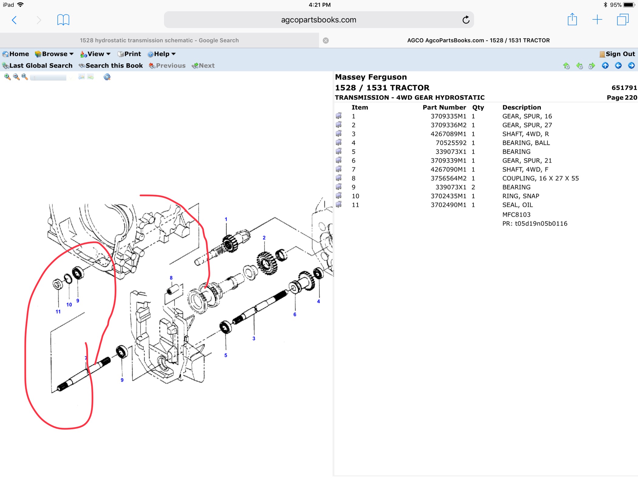

New to the forums, so I have a Massey 1528 hydrostatic trans, I was bush hogging and drive it into a sizable hole. After removing tractor from the hole the front axle rear mount had broken off front the frame taps. In the grand scheme of things this is not the biggest problem.
After a more in depth look both the front axle pinion and the 4wd output shaft have sheared off the splines... I知 not to worried about the axle pinion. The biggest problem is fixing the 4wd output shaft in the transmission. If anyone has taken this on any advice would be great as fare as removal. I was able to download the service repair manual but it doesn稚 clearly or in any type of depth explain how this should be done. 4D6E0F1F-20FE-469C-BB2E-FA6151E19023.jpeg

Ouch. That's going to be expensive. The 4WD shift fork broke (crappy weld, but too late for any warranty, unfortunately) on my 2310, and that necessitated a complete tear-down. $1200+ to replace a $30 part.....

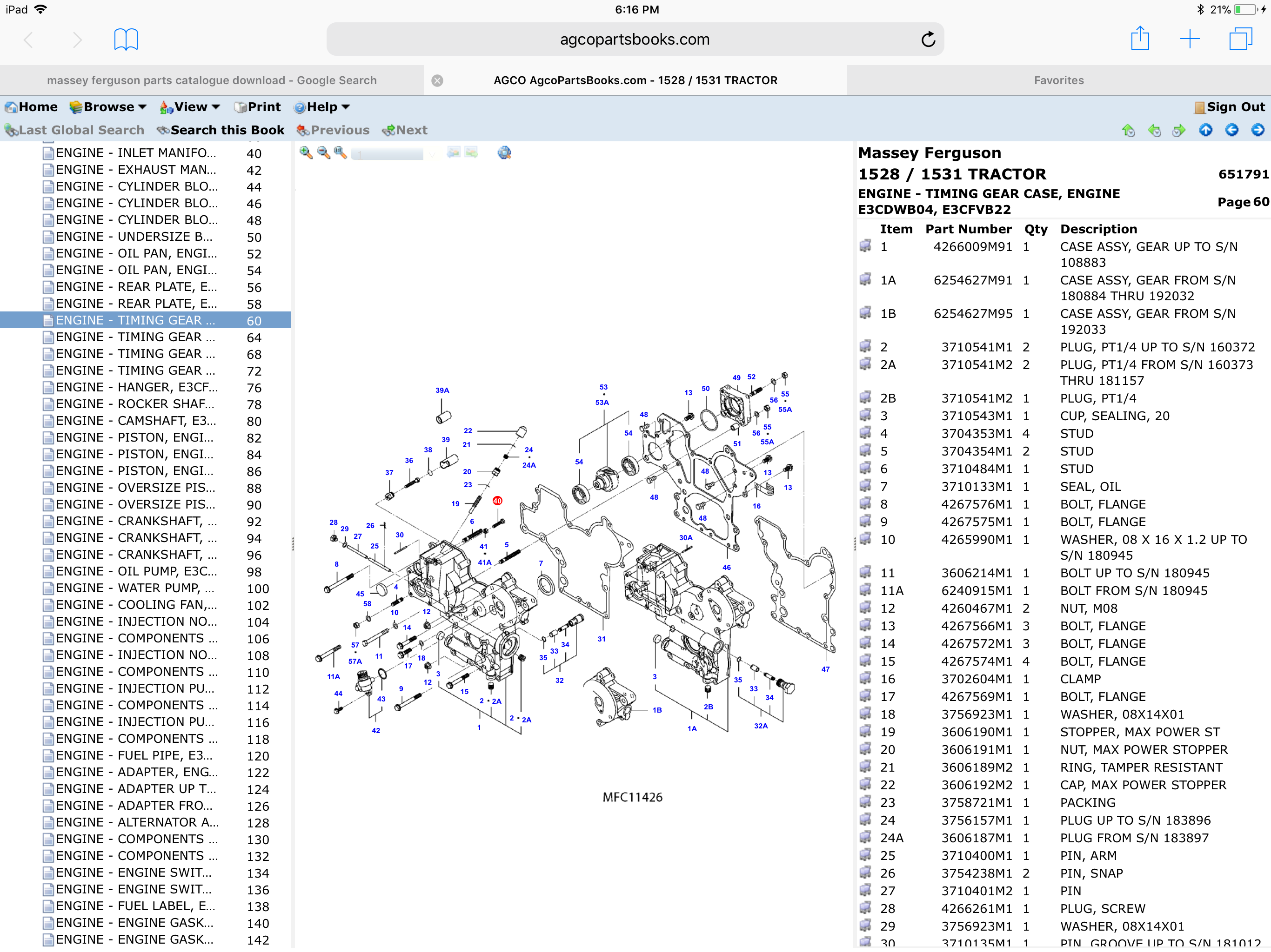

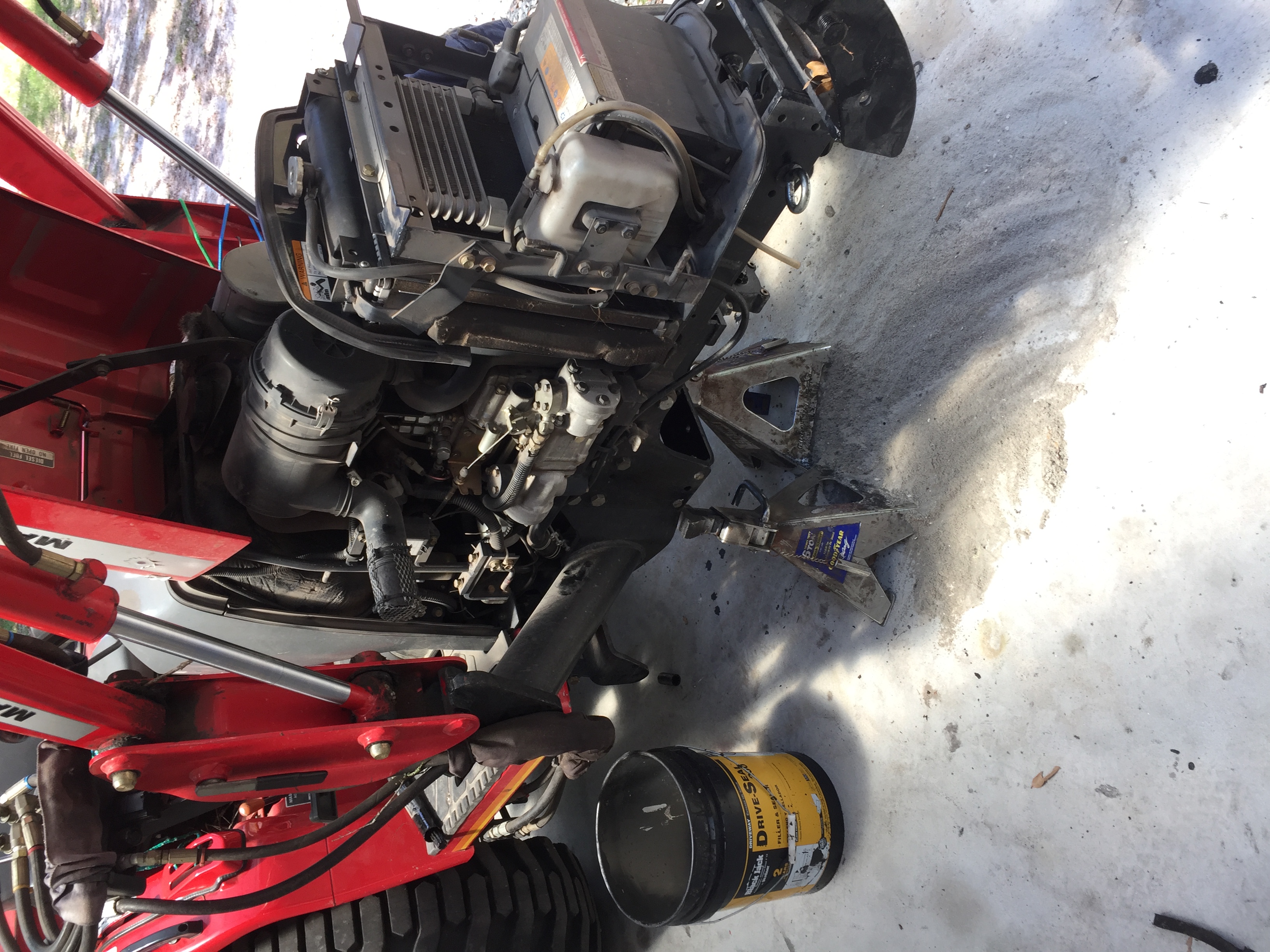

It was fixed and it happened again this time going down a 45degree hill:confused3: . After paying 2k for the fix . This time when the Axle broke the 4wd system lived thank god but In turn it came up and cracked the timing case cover ? . This is insane , B3521CAE-BC22-4697-A12C-66AD120EDE7A.png anyone with knowledge on replaceing the timing cover would be real help full or finding a used complete one ? Feel free to call/text if you know where or if this can be purchased complete, maybe a new front frame as well ? One more suited for a 2600 lb tractor not 1” thin jankytabs , I’ve seen bicycles with stronger mounting points 3524282207

I know your sense of humor is probably worn pretty **** thin by this point, but I'll take a stab at it anyways.....
Your Kubota dealer has the replacement timing cover for your tractor. And lucky for you it just so happens to come with an absolute excellent quality japanese-made tractor! Guaranteed to fix all of the problems that Massey Ferguson / Agco builds into their tractors.

I’ve been having a hard time finding good motor information/parts/interchangeability, I know it is a very common motor if there are any links that would be great. 9938CA8D-4633-454E-BE5D-6C4DA3AB5379.jpeg
