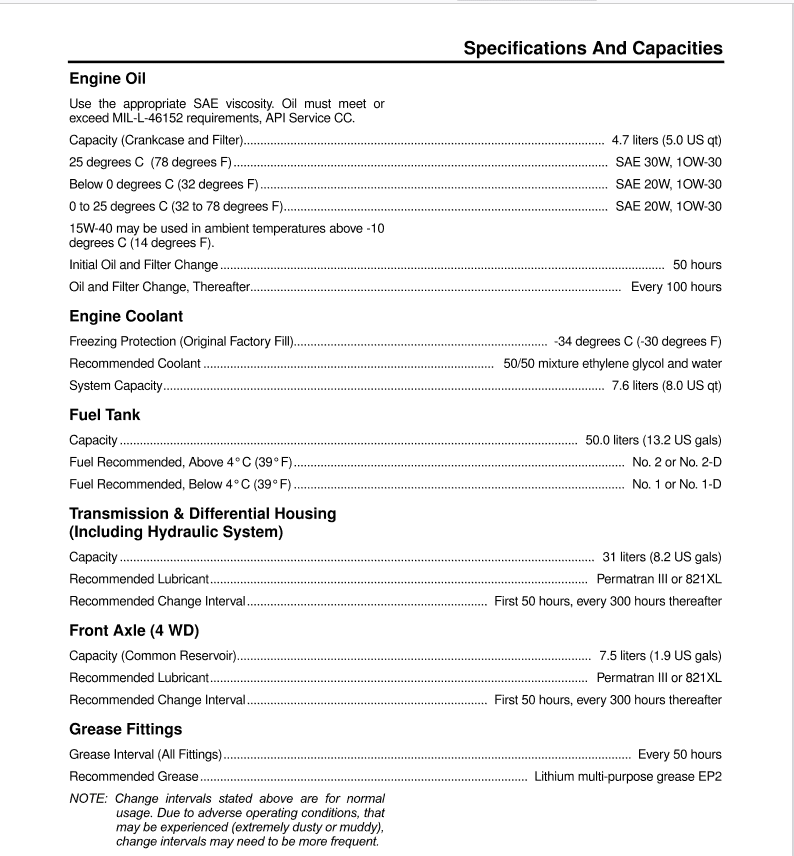

For some reason I can't find teh specs in my manual. Can some one tell me what engine, hydro, and axle oil's I use for my Massey
thanks

Likely Permatran 821xl or equivalent. Check the back of the book for an index and a page for fluid types and capacities.

the oil section just explains how to change it, not type

I have a MF1533.. .from the service manual, Tranny fluid is Permatran III or 821XL.
This page from my service manual may be of help:
