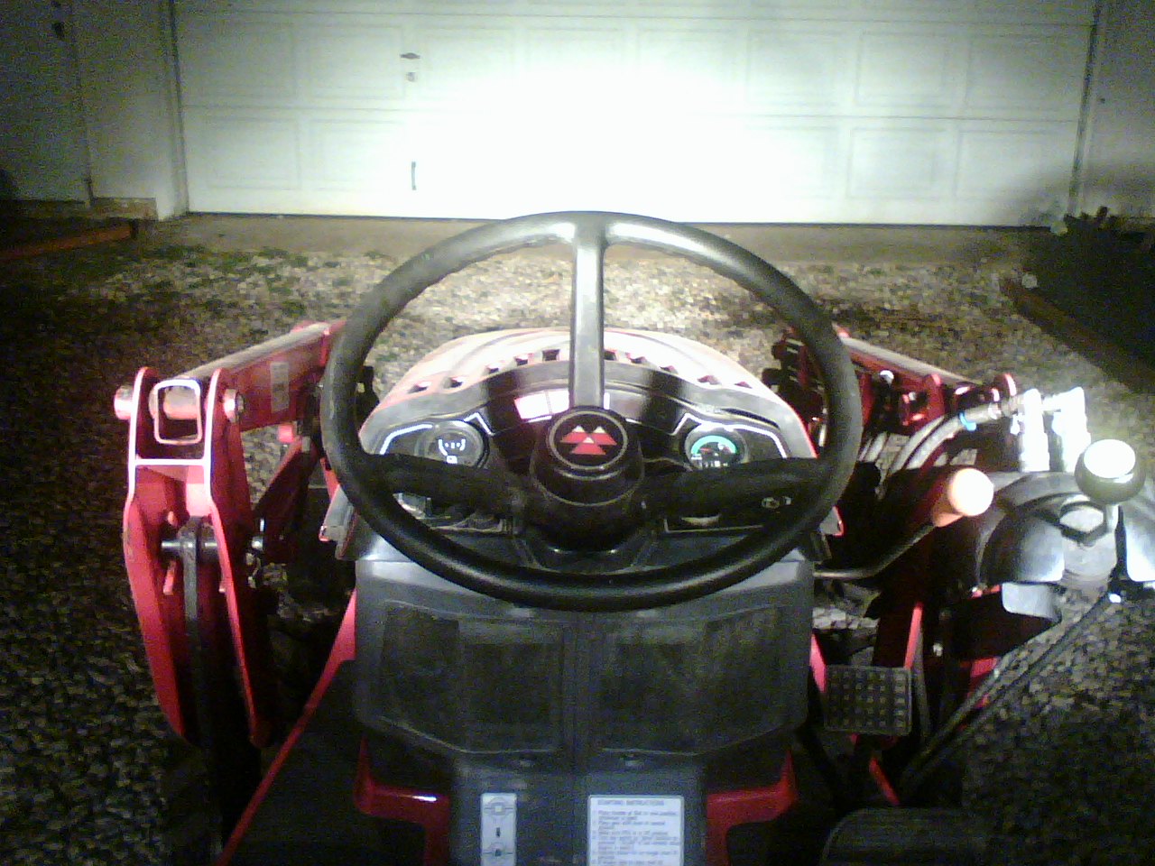

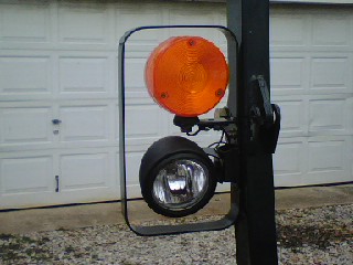

The 2300 has a ign. on, 20 amp fused, red with black stripe lead with a female bullet connector at the back center of the tractor. The wire harness under the instrument panel carries the red/black stripe wire. The instrument panel has a hole under the overlay for a switch above the flasher switch. A sharp knife easily cuts the overlay for the switch. The water resistant switch came from TSC but easily available elsewhere. I wired in the switch and ran wire from the female bullet connector up alongside the wiring for the flashing lights. Covered the wiring where it comes out of the fender and into the ROPS with shrink tubing. Attached the lights to the bracket that hold the yellow lights. So there are no holes drilled. It is a simple setup and it will light up the night. The lights are 55 w Hella Optilux 800ff ($14.00 ea. on line) and come with a base that allow the lights be moved in any direction with out tools.
Doug
