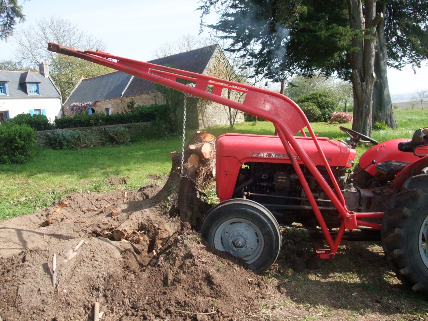

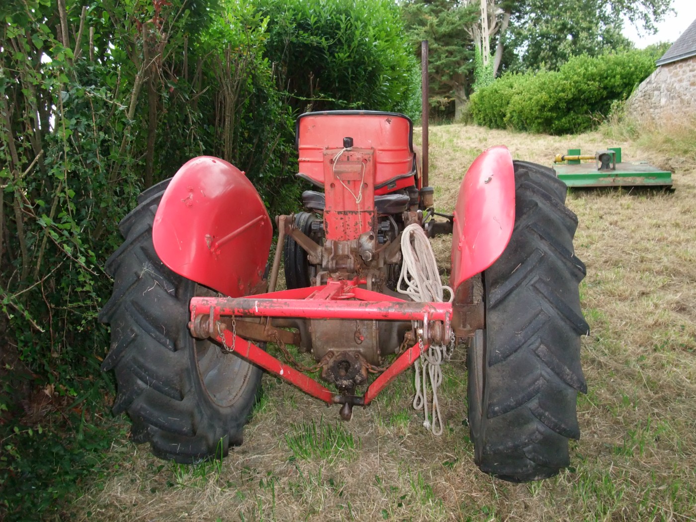

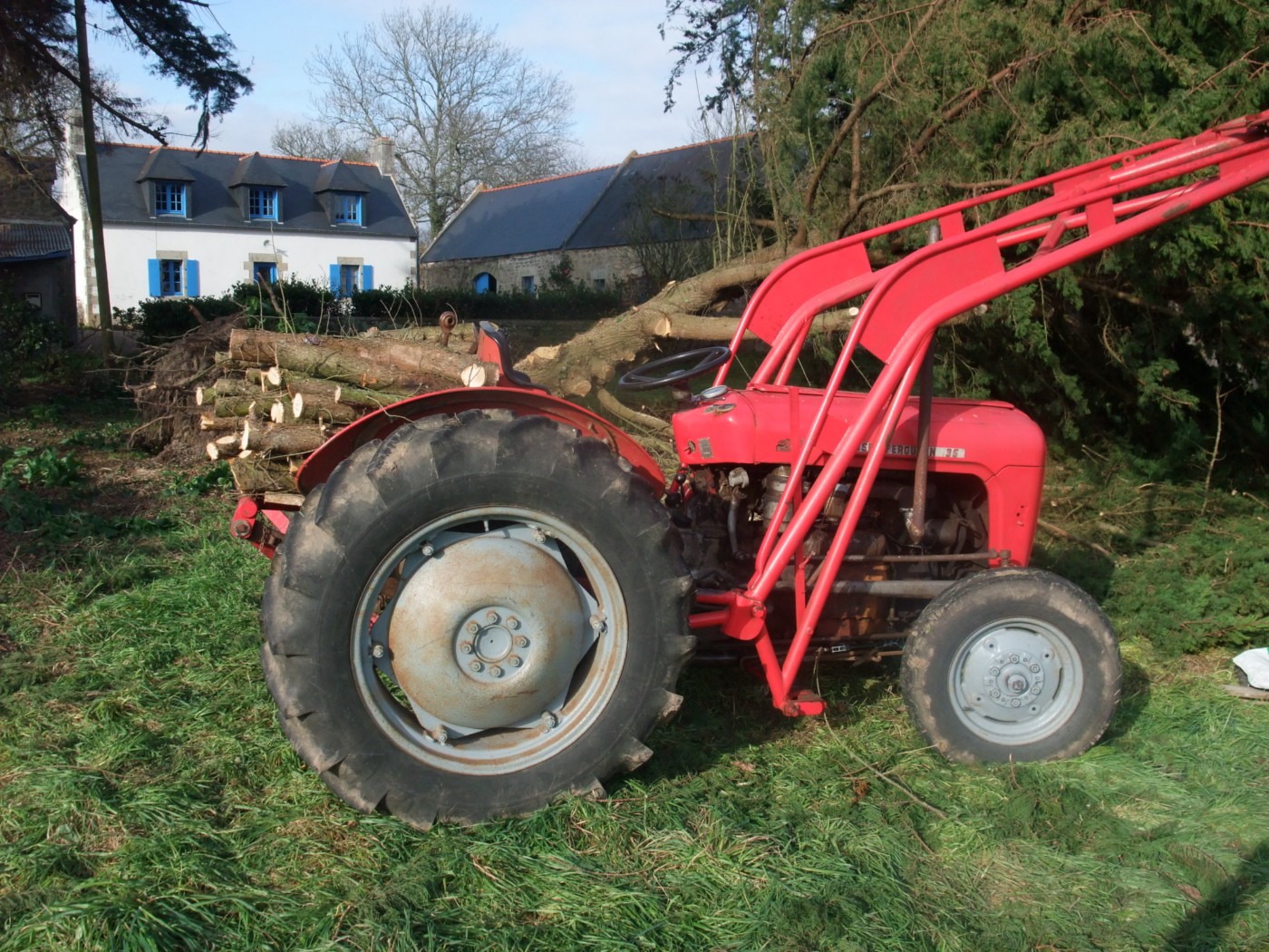

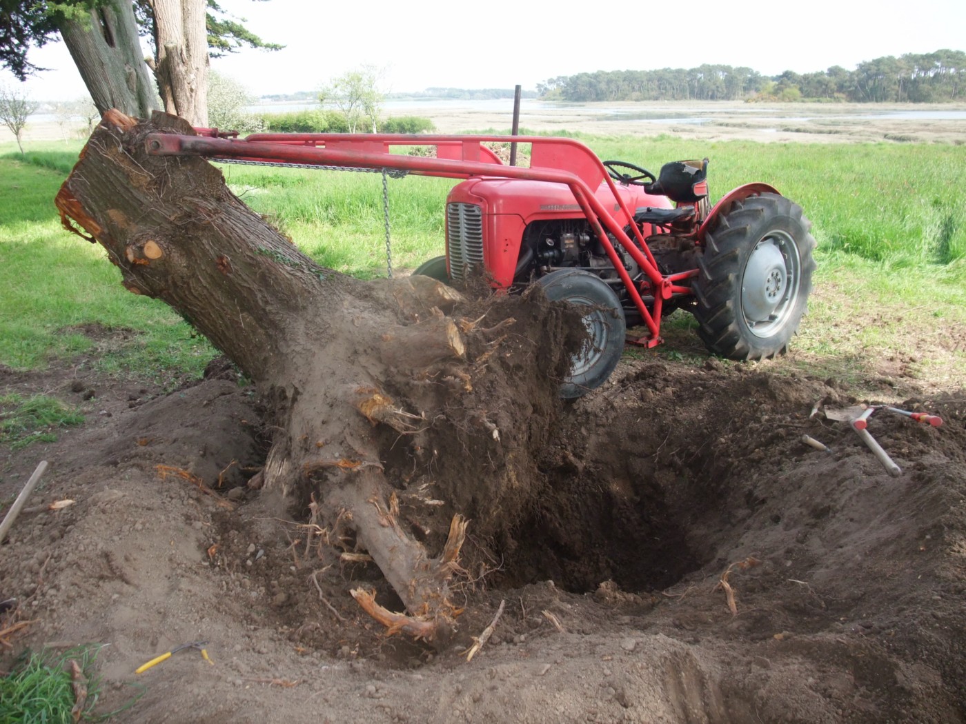

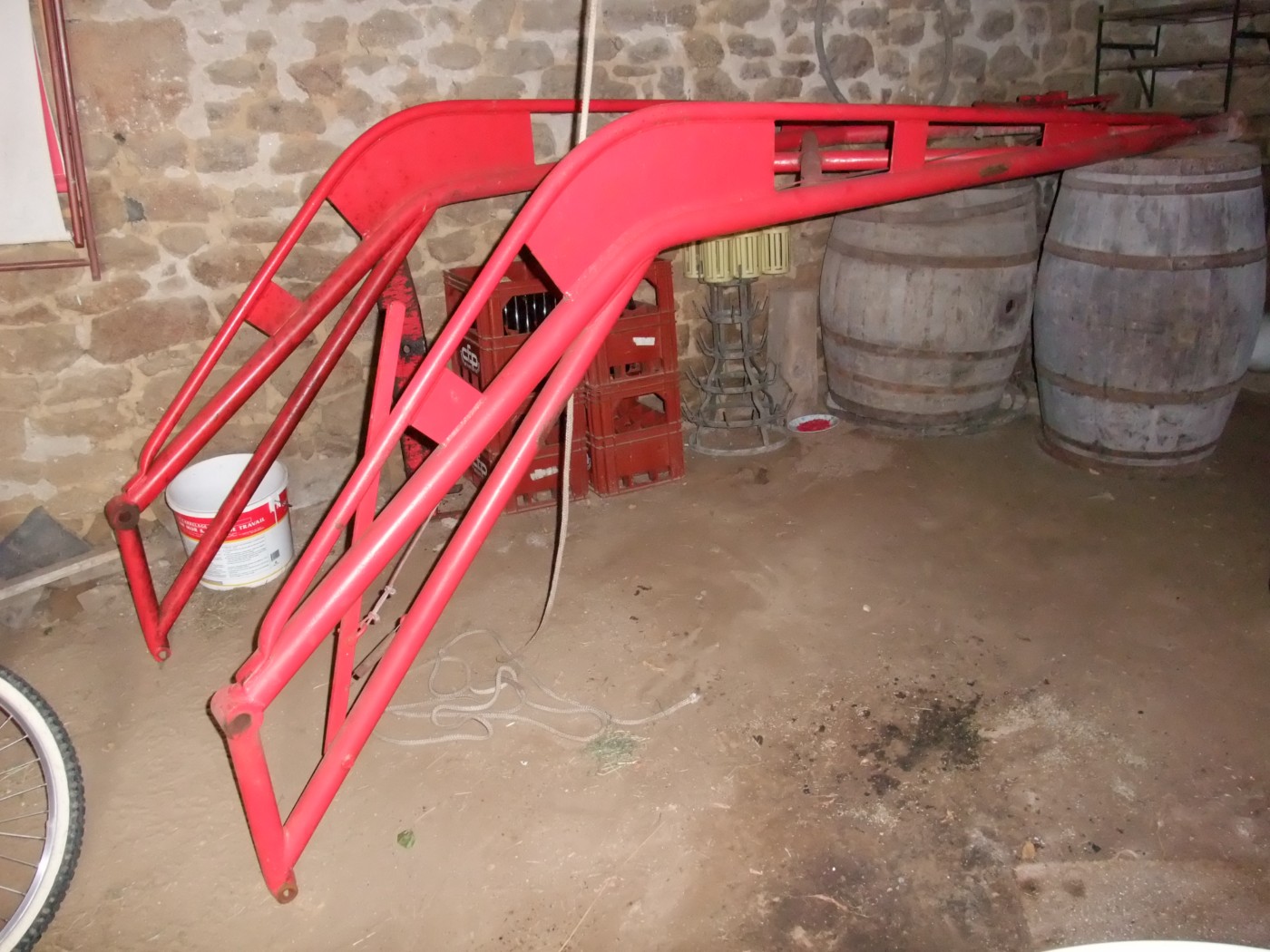

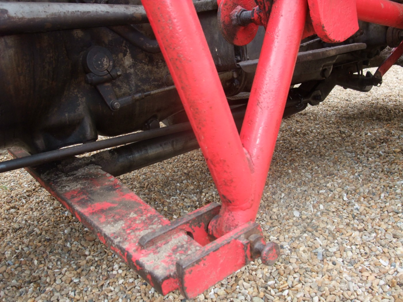

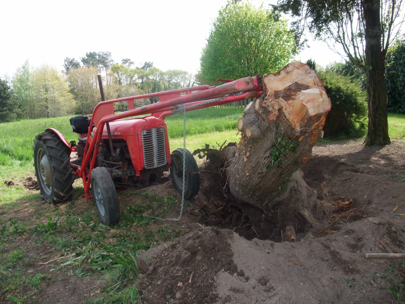

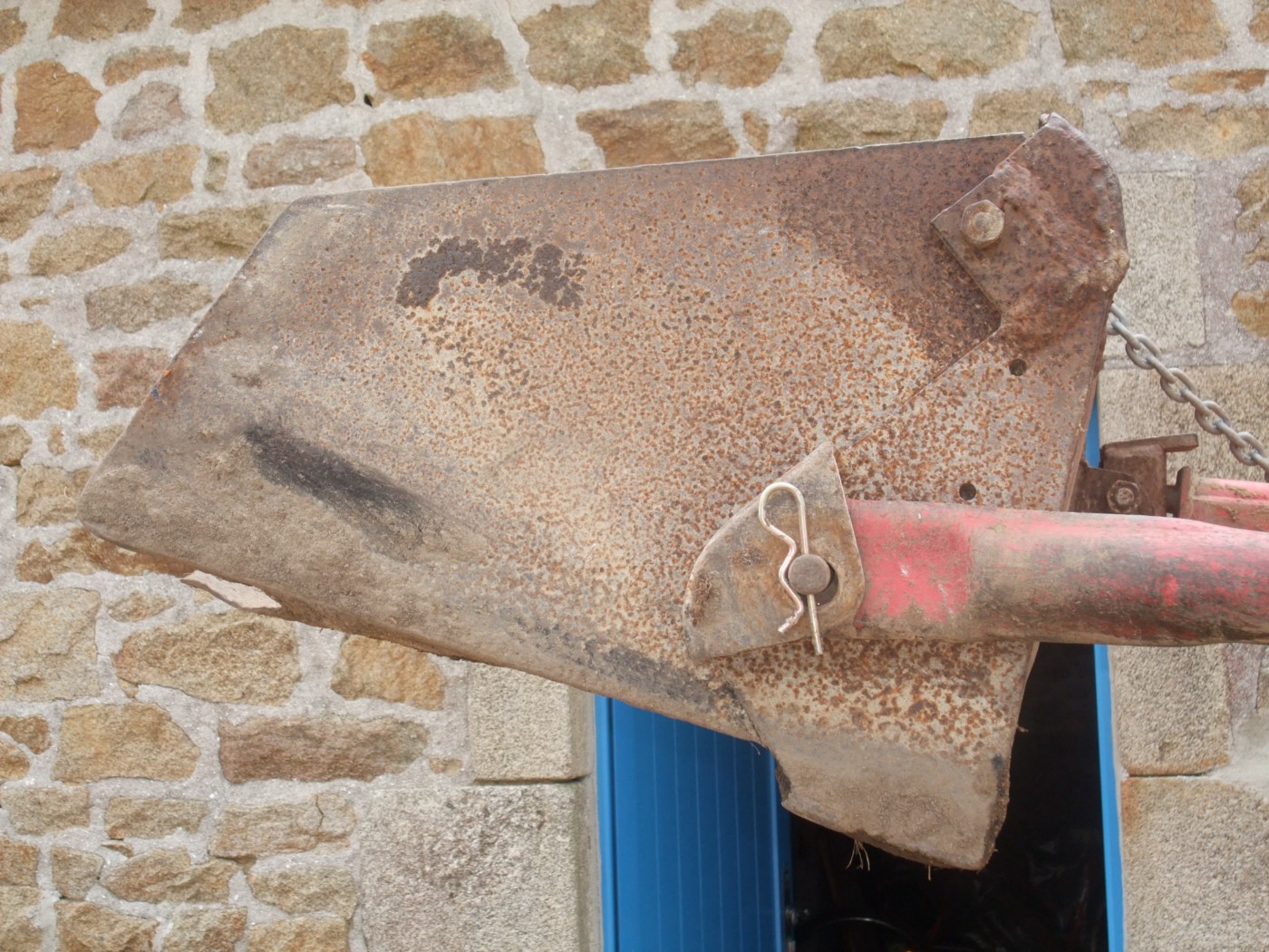

   / Massey 135 Diverter Valve #3
Sorry this is OT but soulasphil could you please post a picture of the rear of the tractor where the loader attaches?
Thanks.
   / Massey 135 Diverter Valve #4
Thanks.
The loader rests on brackets pinned to the rear axle. It is worked by a single cylinder underneath the tractor. Difficult to make photographs of the relevant parts. Here is what I could find.

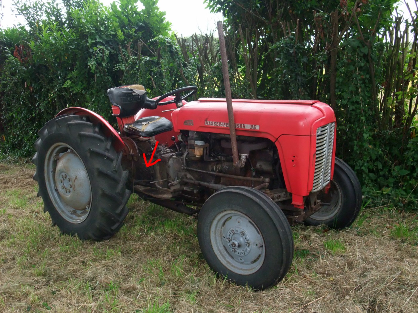

   / Massey 135 Diverter Valve #6
If you are very lucky, you can lower the long tube so that it goes straight into the right hole and you don't lose the O ring on the way, but that seldom happens. The safest way to do it is open the round hole with the gauge for hydraulic oil level (red arrow) in the right hand side and guide it with your hand.
You could also do it from the other side, but it is more difficult to reassemble the rear PTO lever correctly afterwards.
