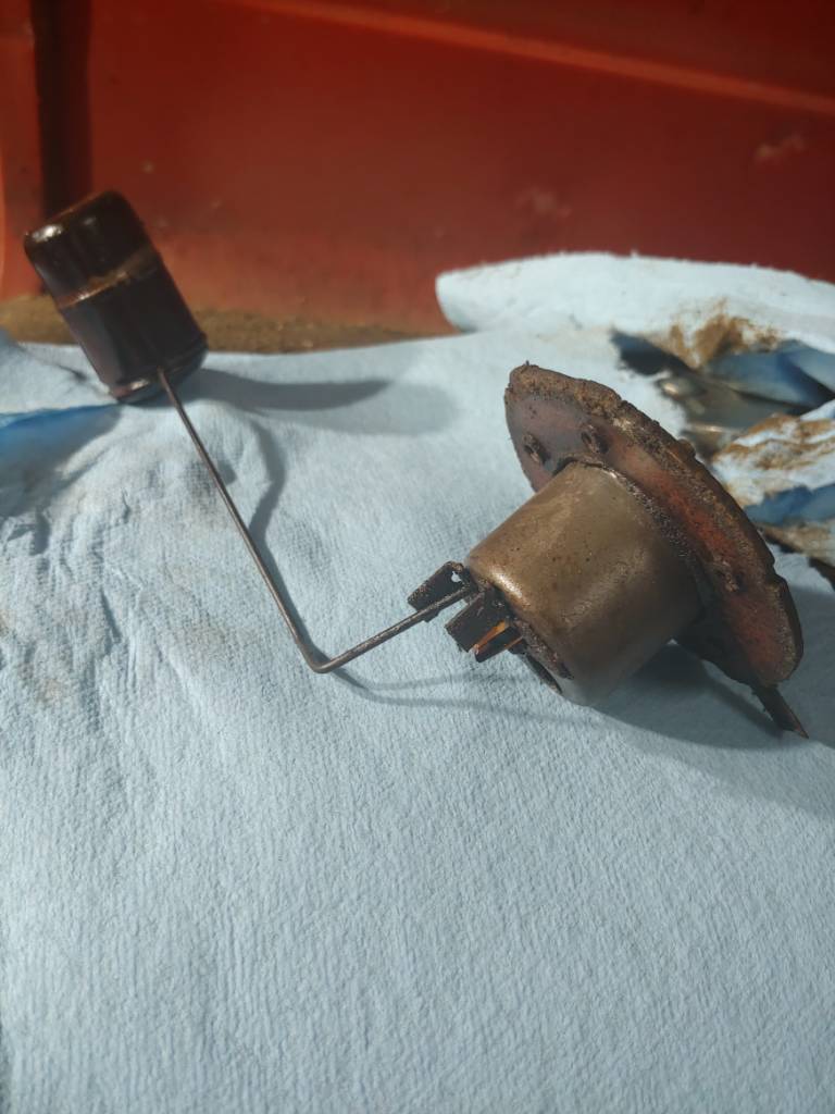

The sender on mine wasn't working. There is a thin copper wire wound around a plate and a contact that slides up and down and changes resistance to the gauge.
I cleaned the contact and very lightly cleaned the coil of copper wire with 600 sandpaper to get copper exposed where the contact slides. It works as long as the wire isn't broke. The contact gets tarnished from sitting.

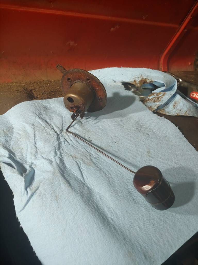

Here's a picture. No wires to be found. Only indentifer i have found is it has 5 screw holes. Nobody mentions the ohms when they are selling.

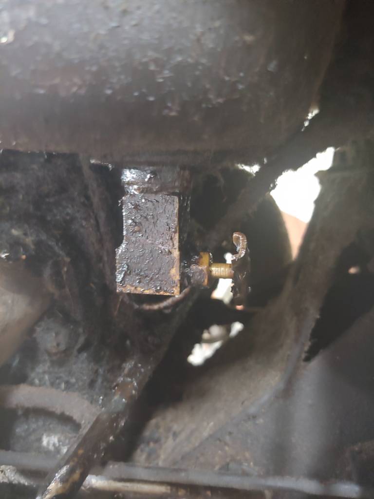

Found another leak at the fuel shutoff valve. Bunch of different parts for various iterations of the 135, and since i have no serial number I'll have to guess. 20200425_155248.jpg20200425_155304.jpg20200425_165133.jpg

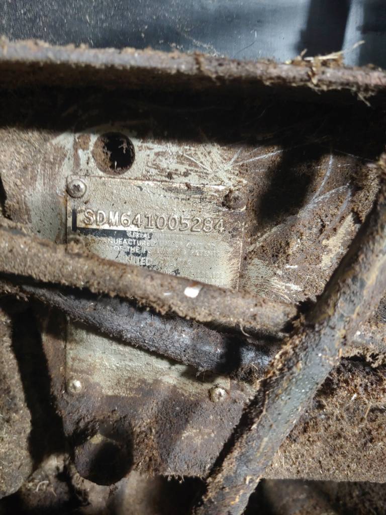

Found the serial number tag behind the air cleaner. Starts with SDM which I have read on this forum is not a US serial number. The tag also says united states on it. Cast date on the oil pan is 64.20200426_134218.jpg

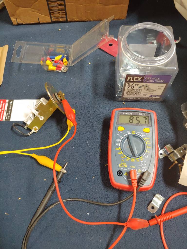

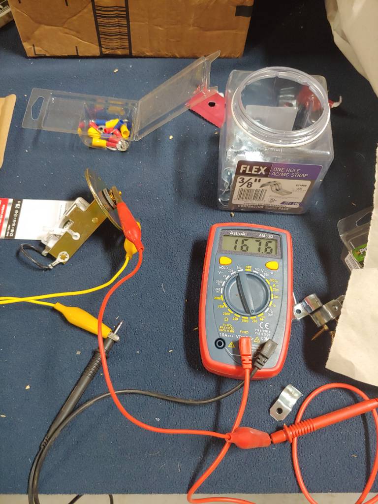

I picked up the new sender from the agco dealer and tested it with my volt meter. It is the correct range of 30-200 ohms. It has a really long float that can be trimmed down. Not sure why this would be listed for a 150 or 165 and not a 135. Maybe because the smaller 135 tanks were only around for a short time.20200505_104120_HDR.jpg20200505_104120_HDR.jpg20200505_104114_HDR.jpg
