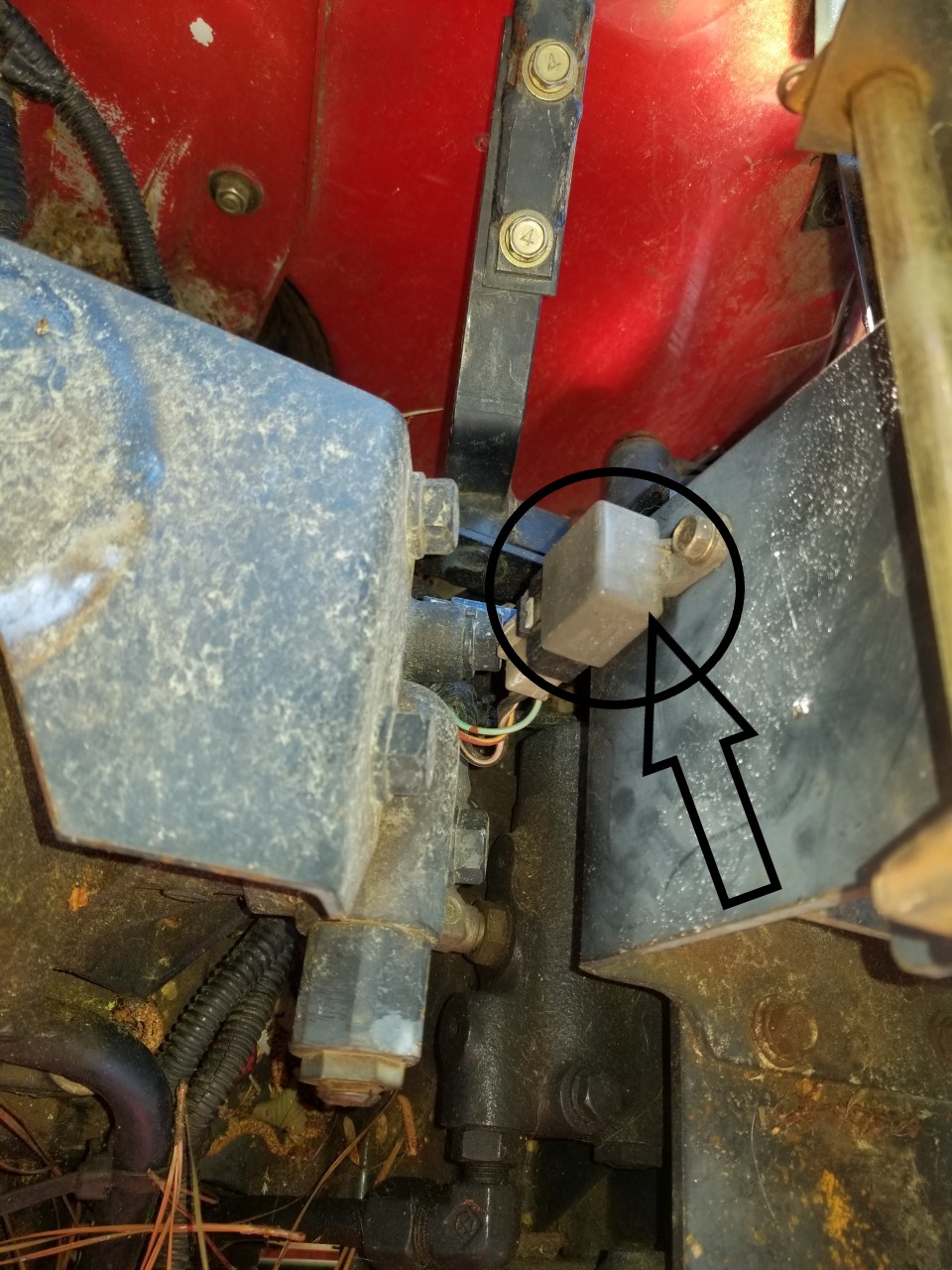

I have a 1999 MF 1225 Hydro that has a rear and mid PTO with a 1232 60" belly mower attached. Recently I have experienced a problem where after I have been using the mover for a while and have to turn the PTO off to move something out of the way or just take a break it will not come back on. If I let it sit for an hour or so it is good to go again. I have checked the switch and that seems good. There is a relay under the seat that seems to be ok (gonna replace it anyway). I have heard someone talk about a solenoid for this tractor but I cannot find where that is. Does any one have any suggestions as to what this may be?
I assume the toggle switch powers an electric clutch somewhere that then engages to turn the gears.

I just ran across this thread... i have a MF 1225... the last year the pto hesitated a couple seconds before it kicked on running belly mower 1232. The first use of 2020 it shut off & wont start back up. Getting 12 volts at connection under the seat... bypassed toggle switch..nothing. Was wondering what ever happened with your PTO prob?

There are 2 things that you can check. 1. There is a relay mounted behind the seat that can go bad. If you have power you should either hear that click or you can feel it when you throw the PTO switch. The other thing is a solenoid. This is what was wrong with mine. It finally quit all together last year so I had to replace it. It is Massey Ferguson part number 3605668M91. It is very easy to change but you have to move some other things out of the way to get to it. I bought mine from Jacks small engines and it aint cheap ($350.00), but I have had no problems with the PTO since then and I wasn't going to let a $350.00 part stop an otherwise functional machine from working.
Jacks Small Engines Search
When I get home I will attach a pic of the relay and the solenoid.
   / Massey 1225 PTO problems
It is part number 2 in this diagram.

I'm having the same problem with my 1225. Does anyone happen to have the relay part number? I'm just going to switch out both at the same time. Thanks.

As copied from the Agco parts book. 3707981M91

Could someone get a pic of these parts-both the relay and the solenoid?
I would like to see what makes these parts so expensive.
