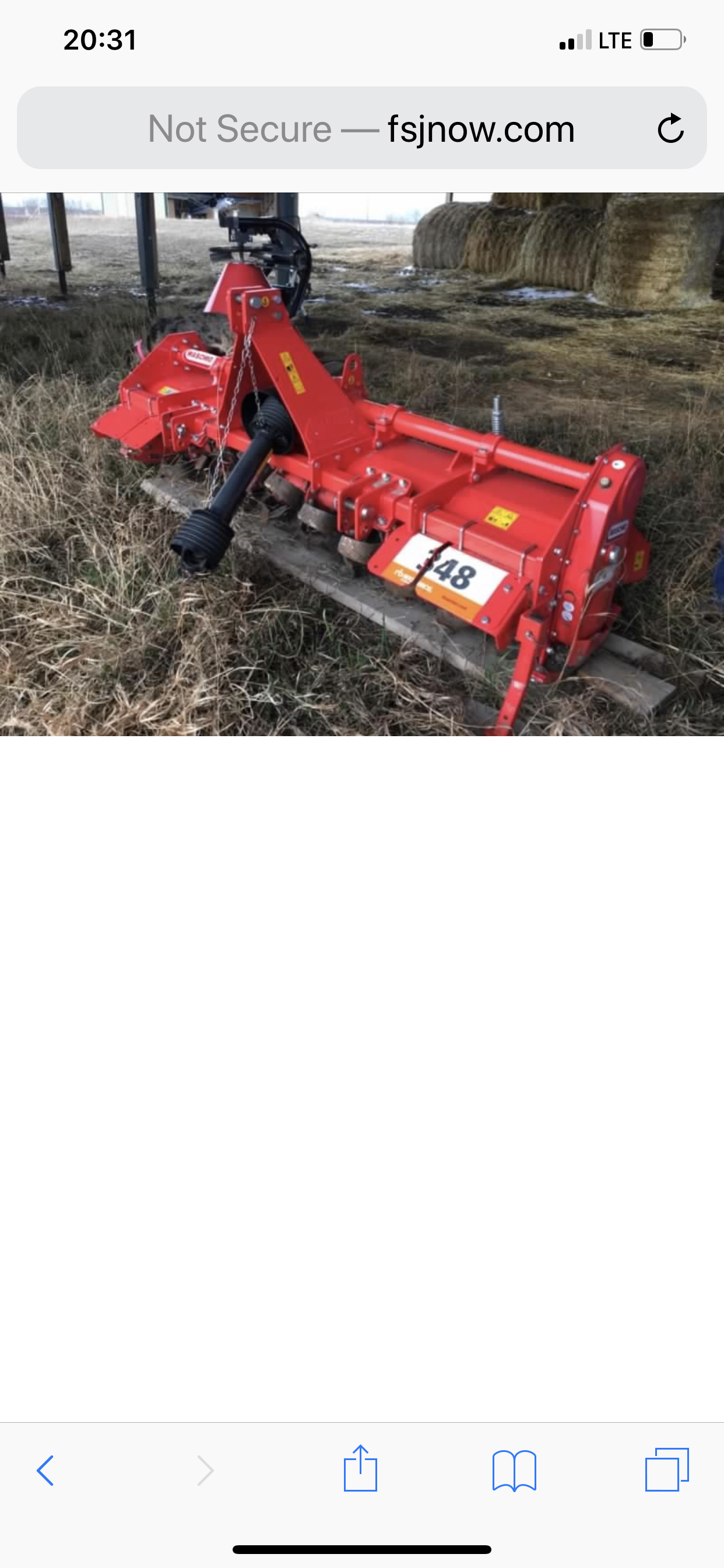

This is offered for sale on a local buy and sell. I値l try and upload a pic later. 4K seems reasonable. Thoughts? Model # is unknown at this point. 83 rotatillers seem to require about 60hp from what I致e read. I have 40hp at the PTO. Think I could run it if I was cautious?
83 Maschiu Rotatiller for sale. Good condition, lightly used. Asking 4000 or best offer

Here’s the photo. Appears it was purchased at an auction by the tag on it.
   / Maschiu Rotatiller #3
They are solid tillers. We use on behind a John Deere 4052. The key with using it is to not sink the tines too deep. Also, keep rocks out of your tilling bed if possible. Not knowing the length of tiller, it's hard to say if 40HP will work. I'm inclined to think it will if you till slow and take your time.
   / Maschiu Rotatiller #4
IF, it requires 60 hp to run it, there's NO way your 40 will ever run it right, and will probably cause over heating of your tractor.
