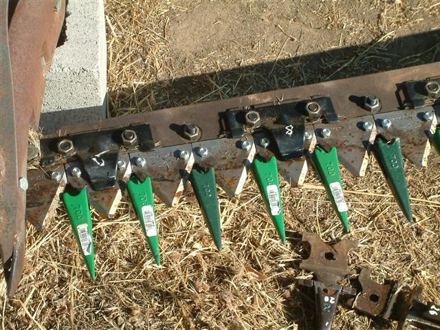

What you call "blades" are usually called "sickle sections" (the triangular cutting pieces) and what you call "guides" are usually called "guards" since one of their functions is to protect the sections from obstacles like rocks. The guards usually carry "ledger plates" which are part of the sickle bar cutting mechanism. The steel bar that carries the sickle sections is called the "back".
So you're able to slide the back with the sickle sections (the blade bar) out of the guards with no problem. That's how my MF31 sicklebar works also and is pretty much the standard way most sicklebar mowers are set up. In the photo, the guards are the green parts and are attached to the main bar assemble with the large nuts and bolts. I replaced the rivets with bolts and lock nuts to attach the sickle sections to the back.
The guards on my MF31 have to be removed individually which appears to be how your sicklebar mower is set up.
